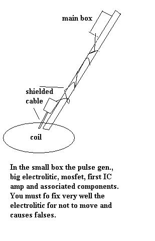

                I think that for to minimize very great the capacitance in cable, for example, you can use this arrangement: divide the PI detector in 2 parts. I think this model can be useful for many of us in the forum.

                    Yes... right! But are the pulse gen. and mosfet into the coil? Don't remember... But in this model the mosfet and pulse gen. is near the coil.
                    Esteban
                      Shortening the cable helps with the pulse width. However, I don't think is a good idea to place the board on the coil, because all the metal from the board, large capacitor, heatsink of transistor, PCB tracks can be detected and they increase the pulse width. The lower cable has to have some length, to keep the tiny board at a safe distance from the coil detecting range.
                      Nicolae
                        Maybe designing a PCB with thiny tracks and study disposition of components. Also you can use here SMD components, only electrolitic can be the big problem.
