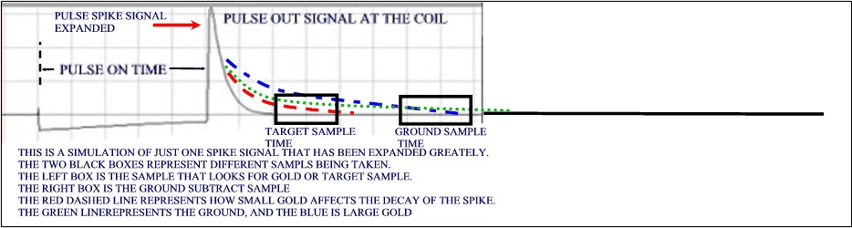

        Detecting smaller samples with any metal detector
        As you know, I am very much a beginner in the metal detector world. And at some stage I realised something which may be counterintuitive to some of us. Let't say we have a metal detector and the only changes we can do to it is to change the main pulse width (which changes the flyback pulse voltage) and we can also change the delay of the first sample.
        Let's assume we can change the pulse width of the metal detector between 50 and 100us.
        The fact that for this adjustment the transistor reaches breakdown voltage or not is not important.
        Let's say you have a target (aluminium foil) very close to the coil (or very close to the surface of the ground - it could be a few cm under the ground if you wish). You set the main pulse width to 75us and optimize the first sample point. And you start reducing the size of the target to the extent where you are hardly able to detect that sample.
        Now, reduce the size of the sample even more, so you can't detect it anymore.
        We set the initial conditions for the experiment.
        Now, what do you have to do in order to detect the sample again? Will you be able to detect the sample by changing the pulse width toward 100us or toward 50us and reoptimize the first sample delay? Increasing the pulse width toward 100us will increase the flyback voltage, but also the decay time.
        I would decrease the pulse width and readjust the first sample delay (the flyback voltage will be lower!) in order to detect that smaller target. But let us hear what other people would do and if anybody thinks I am crazy

                I'm a beginner too, so I really appreciate the basic questions.
                I think your ideas make a lot of sense -- around here a lot of differences in opinion are simply because it's too tedious to really define our conditions exactly so we all are on different pages half the time! And we have different backgrounds -- makes for lively discussions.
                I agree it seems that once you have a coil made, there is only one optimal Rd (unless you play tricks with underdamping) -- I think your point is, what's left to play with? -- answer: pulse width and sampling delay.
                So maybe you are leading up to the idea of a metal detector that explicitly uses controllable pulse width and sample delay to eke out more information about what's underground. I would bet people somewhere look at that extensively, but still sounds like a good area for experiments and design.
                Tinkerer seems to be pursuing the "IB" dual coil variation of PI detector, where I think shorter flyback pulse is irrelevant to sampling since you can sample whenever you want.
                But to sum up the various messages responding to your thoughts, it seems most people say you have to reduce the capacitance in order to shorten flyback pulse by increasing Rd, so no disagreement with your statement that Rd is not adjustable by itself.
                Now, on your idea of shortening TX pulse to sample sooner -- it seems to me that won't buy you anything. The flyback pulse looks shorter, but it really isn't, in a relative sense -- it is just smaller in amplitude, but has the same decay shape. The target response is also smaller, so you will have to wait the same time (as with the larger pulse) until the smaller target emerges from the smaller flyback pulse. I didn't do any math on that, but that's my gut feeling.
                Keep throwing those questions out, that's how those of us catching up get a chance to learn.

                        • #72
                          I agree with Simon that were all on different pages, especially me.
                          The rate of current fall in an inductor is V/L, as i read things & maybe i am reading things wrong but it seems as though people are trying to read target response after the flyback returns to 0?
                          Put all capacitance, voltage etc aside for one moment, it is the decay of the spike we need to read.
                          If our spike settles at say 1uS no target--unstable detector area, then when metal etc is introduced to the coil the spike decay is longer & this is what we read.
                          Maybe that's what is being talked about, but at times it seems different with talk of TC of targets etc?
                          I was drawing a diagram to explain & then i found one by drawn by Reg, i hope he doesn't mind me posting it here? Anyway thanks Reg!
                          Like i said i may be reading things wrong so i thought i would add this to make sure were talking about the same things.
