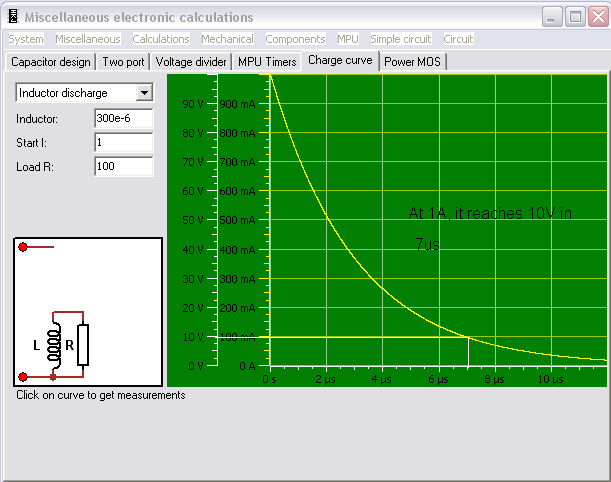

    I tried that both in practice and as simulation and I get exactly the same values for the resistor, no matter what the peak voltage is.
    Nicolae
    Hi Nicolae,
    When you increase the pulse length you store more energy in the coil's magnetic field. You have more Amps at switch OFF. So you are comparing apples with melons.
    For a specific amount of energy stored in the Coil's field, a higher resistor value will drive the Flyback higher and the decay will be faster.
    However, if the Flyback voltage goes above the Mosfets reverse diode, this will slow down the decay.
    Take Misc.El and open the "Inductor discharge" page and play a bit with various A and R values. It is very interesting.

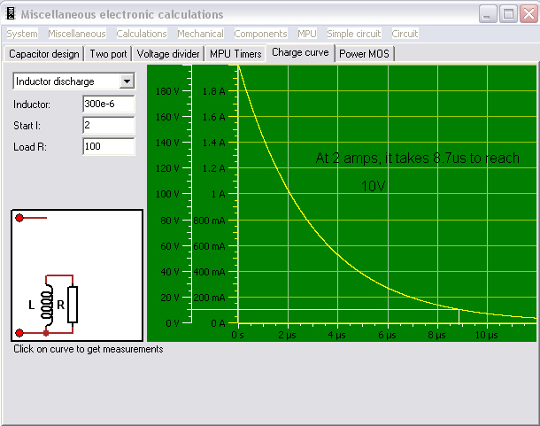

            Tinkerer
            Hi Tinkerer,
            I checked the MiscEl and I changed the maximum current to different values (obtaining different flyback voltages). It agrees with what I am saying. The higher the initial current, the long it will take to discharge the voltage to a specific value (let's say 10V).
            I think that by increasing the flyback voltage to obtain faster damping is a myth and I am waiting for the first person who will realise/admit I am right
            Which is, if you want a shorter pulse, use less peak voltage (= less initial current through the coil).
            Even if we take into consideration the capacitor in parallel with the inductor, both of them store energy and the more energy is in the circuit, the more time takes to discharge it through a resistor.
            Nicolae

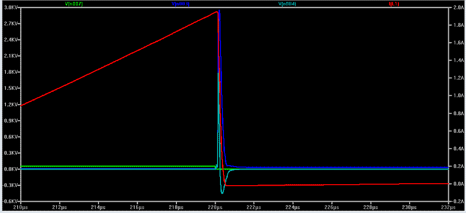

                            I have attached a screen shot of forced flyback for want of a better word.
                            The Light Green--Lime is the switch off, the Red line is the Inductor Amperage, Dark Blue is the Inductor Voltage & the Light Blue is what i get after the parrallel diodes with the circuit i have at the moment.
                            It seems to me that the more capacitance you have the higher the flyback has to be to compensate.
