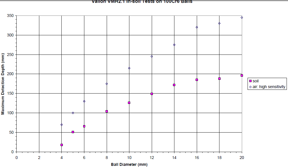

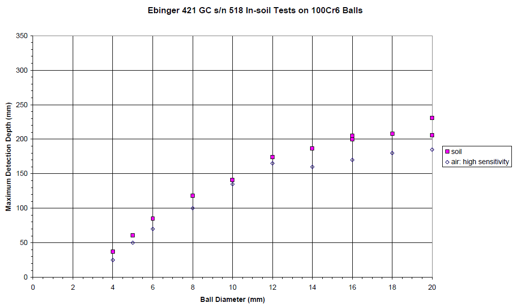

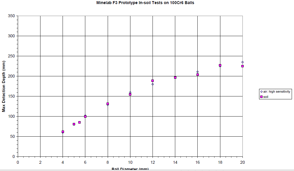

    Gday Nicolae,
    Firstly we can test at home, more on that a bit later.

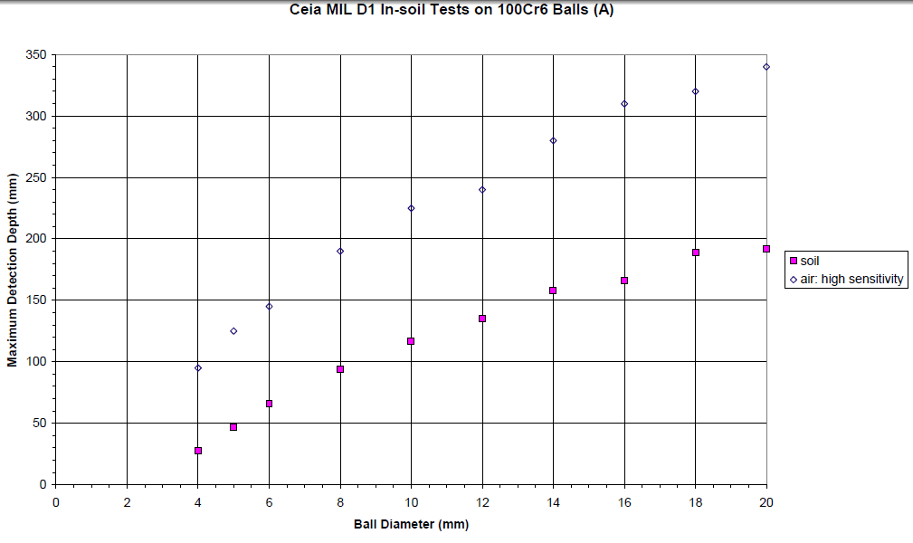

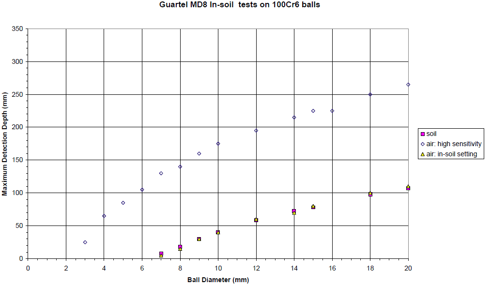

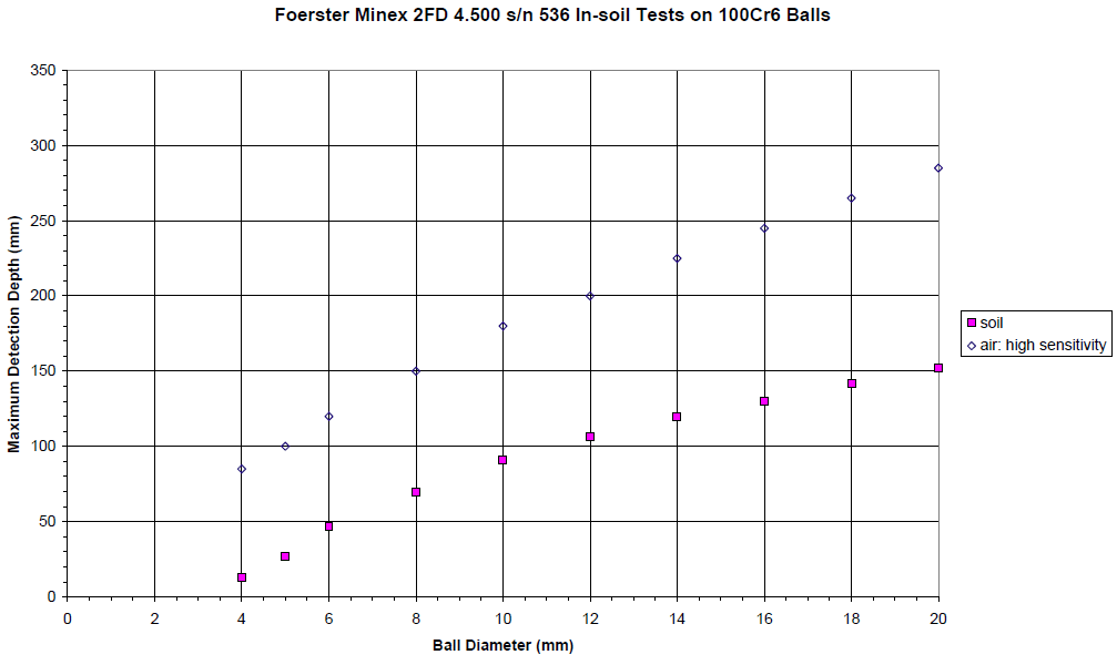

    I absolutely agree that we can air test so please don't get me wrong, the thing is we have to know what it is we should be testing. Once we know this then we can air test, but like everything there's a secret that at the moment only ML know what it is, this is why like it or not Mr Candy is a smart sucker.
    I think everybody will see from the attached pictures that there is more to this than meets the eye.
    This is an International standard test with the results on various top of the line detectors--the big boys & there toys.
    Have a look at the comparison from air testing to ground testing, only ML have it right, this is what i have been working on for some time.
    You will also have to remember that these tests are done with the soil that was available at the location of testing--foreign soil to Australia.
    Now bring there detectors here & ML win again by a broader margin.
      Another graph.

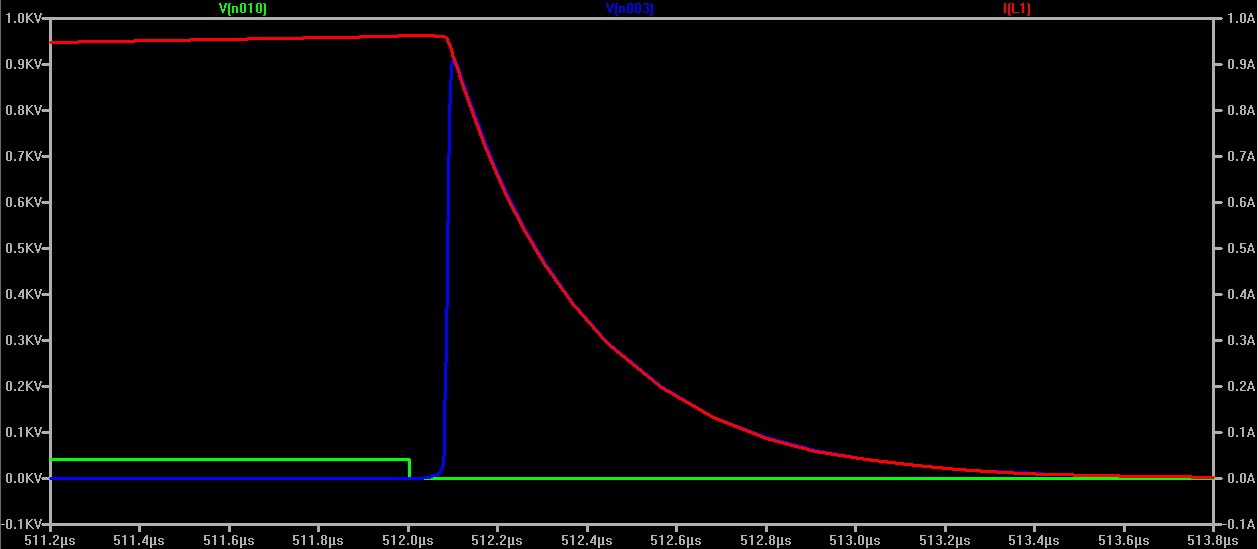

          Not sure if this is what you have been simulating with LTSpice as i haven't had the time to load your models to run them.
          I had a bit of a play around this morning with what i think your testing & have attached a screen shot of the result.
          Green is trigger pulse at turn off, Blue is Inductor voltage, Red is Inductor Amps.
          Is this what your simulating?

            Hi B^C,

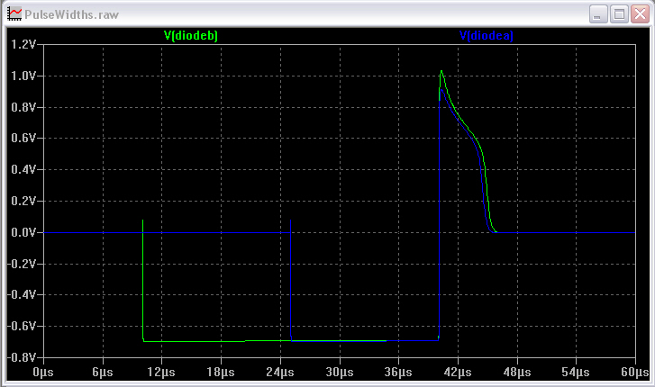

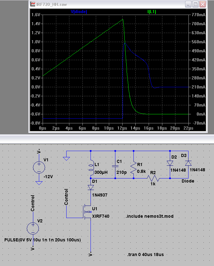

            I was simulating the waveform (voltage) on the antiparallel diodes where the preamplifier is connected. See the attached image. The delay you can get there is the best delay we can obtain, considering that all the other stages following this point will only add additional delays.
            I run simulations with various MOSFET transistors, various values for C1, R1, R2, D1, D2+D3, etc and I can't go much lower under 4us. I wanted to see if other people can get a simulation with better deadtime than 4us.
            For example, in the waveform I just posted, you can see the deadtime is actually 5.5us (the damping resistor is not optimised, should be a bit lower). If we amplify that signal 1000x, you'll see it doesn't look very nice.
            We can improve this circuit with lower capacity transistor, lower capacity coil, lower capacity D1, etc.

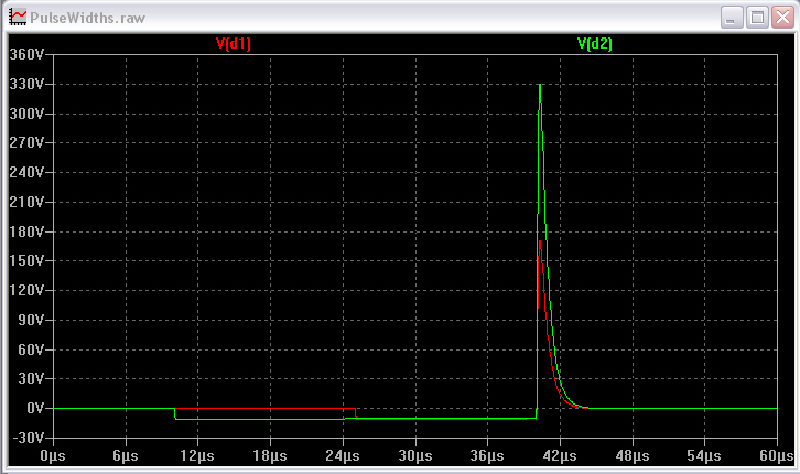

                            A few people already mentioned that getting a higher voltage on the coil will shorten the decay time. Can anybody explain to me why would this happen? To me it's not obvious. If I have the same coil and I apply current pulses with different widths, the resulting decay time was actually worse.
                            I attach a screenshot from LTSpice. The circuit is identical, the only difference is in the width of the control pulse for MOSFET. The plots are measured at the antiparallel diodes and on the coil.

                                Hi Simon,
                                I tried that both in practice and as simulation and I get exactly the same values for the resistor, no matter what the peak voltage is.
