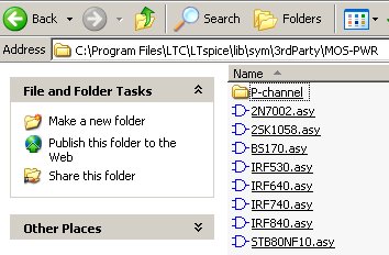

                        Forgive me if I tell you stuff you already knew...
                        You can edit third party symbols ("3rdP" symbols) by either (1)clicking on the file name, or (2)dragging it into an open LTspice window,
                        or (3)right clicking it from within an open project and then clicking "Open Symbol".
                        If you want to edit (or examine) a symbol that was supplied with LTspice, method (3) will not work.

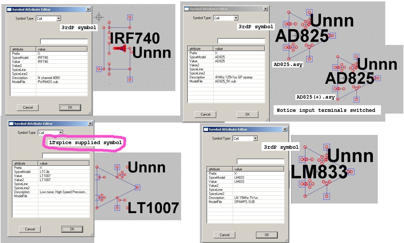

                        CTL+A will open the "Edit Attributes" window for a symbol. If you examine the attributes of an LTspice symbol (LT1037.asy, for instance)
                        you will notice that they have filled in the blanks a little differently than I have in my examples.
                        So, obviously there is more than one way to create usable symbols.
                        I create a different symbol for each part. Although it may seem like unnecessary trouble, I make notes about the part
                        within the symbol, and can edit attributes so that LTspice knows where to find the model file, making the "include" statement unnecessary.
                        You can use one symbol as a template for similar symbols, so making new symbols is a snap.
                        I rename all model files to *.sub, unless the extension describes something, like ".501" indicates a model characterized for a
                        single 5V supply (as TI's method).
