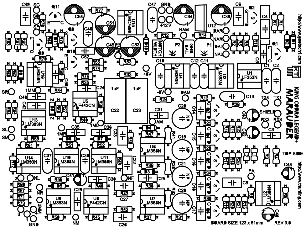

              • You are confirming the changes?
                [ATTACH]38053[/ATTACH]
                • L1=?L2=?
                  C44=uf?
                  C40=?
                  PA=?
                  • L1=?L2=? 75...120 uH (micro-)
                    C44=uf? 47uF 10v... 12 v
                    C40=? 47uF 10v... 12 v
                    PA=? test point, no component. set o-scope and seek RX signal tuning a coil balance.

                        • Ted shared with me original schematic. so thinking i have to ask a permission from him to share that with you before.
                          • last (LAST) schematic rev3.0
                            • top silk
                              • all pics in album GMT King Cobra http://www.geotech1.com/forums/album.php?albumid=65
                                last revision board is WHITE color, because 'winter' project. look white board pics.
