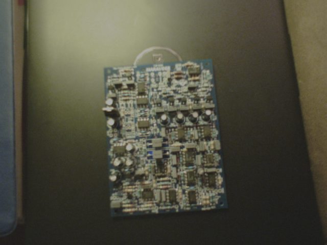

                • I just thought id get lucky but no biggie I keep looking or just make one thanks I have a very blurry finished board pic but when i find the camera cord they'll be right sorry

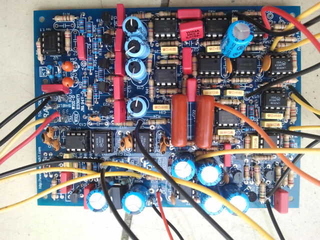

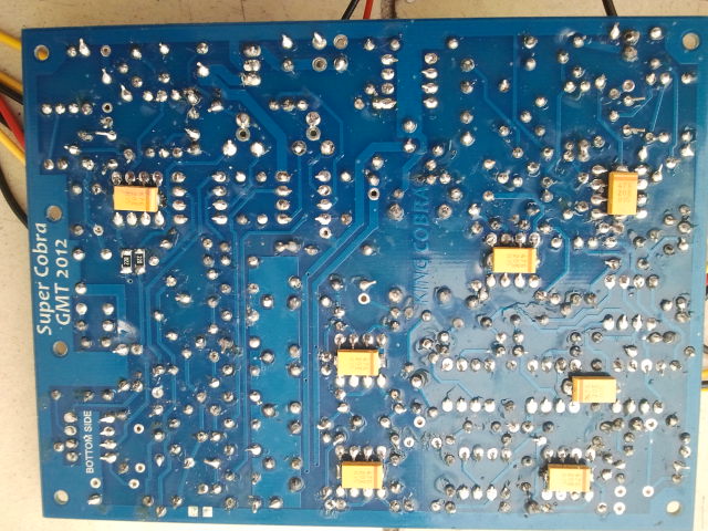

                            • how could it be otherwise, no problems, the disc position metal detected, but only to a maximum of 5 cm (two ton),all metall position no metal perception, have the switch cable checked, all in order, would be a wonderful if times times what works directly
Name:	2013-04-17 17.26.07.jpg
ID:	335874Click image for larger version
Name:	2013-04-17 17.27.37.jpg
                              • what type you use Q1 and Q11 transistors? I see they are soldered inverted. main rule is all resistors have to be measured before to be soldered, even you are confident in its colour code.
