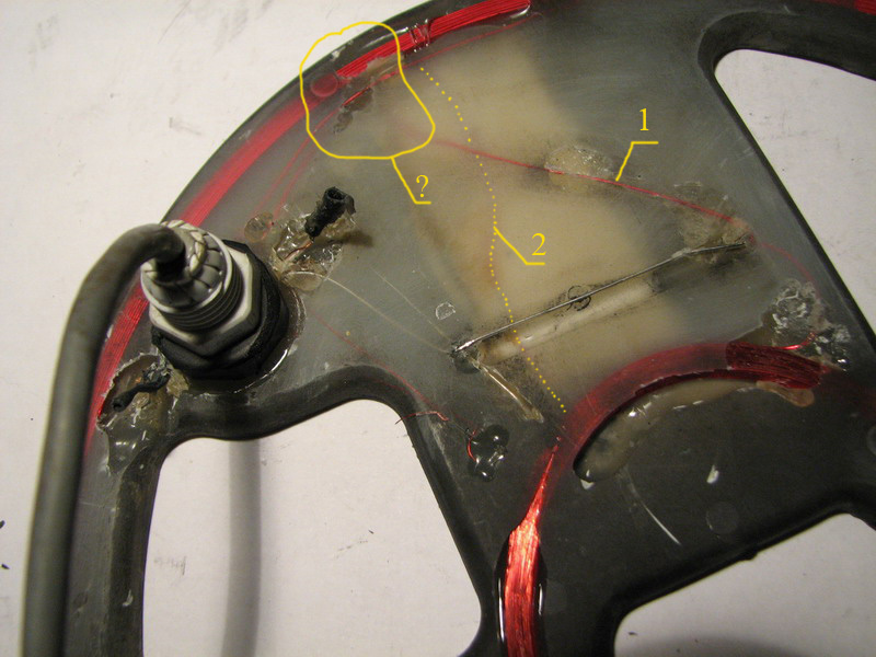

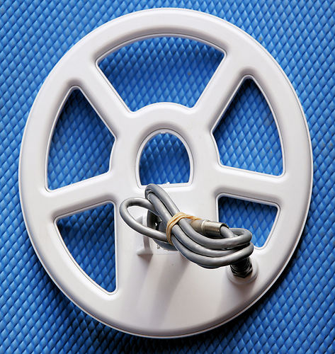

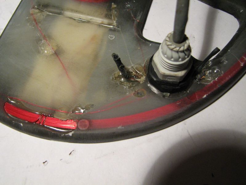

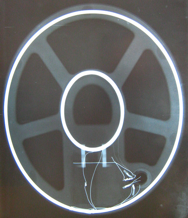

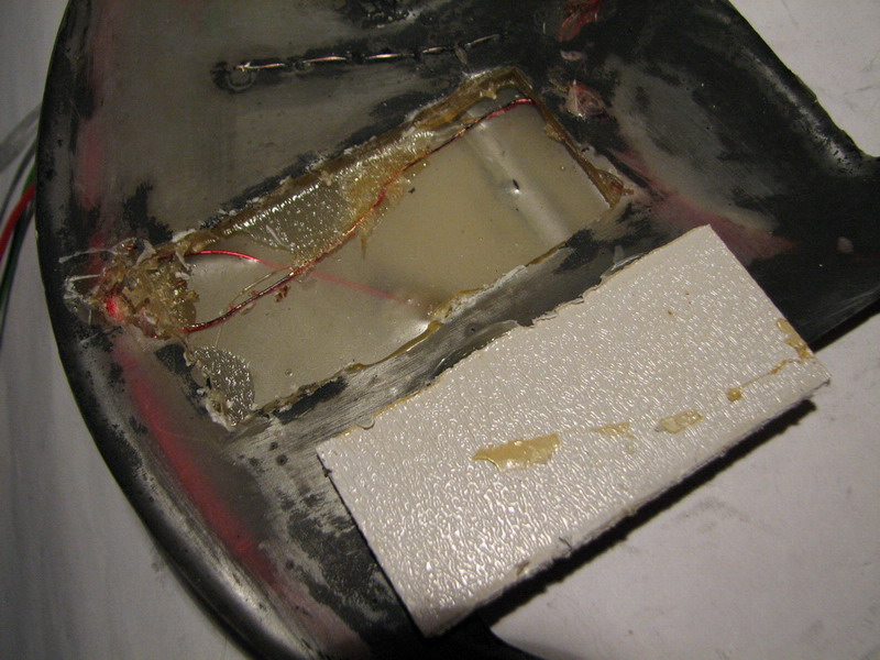

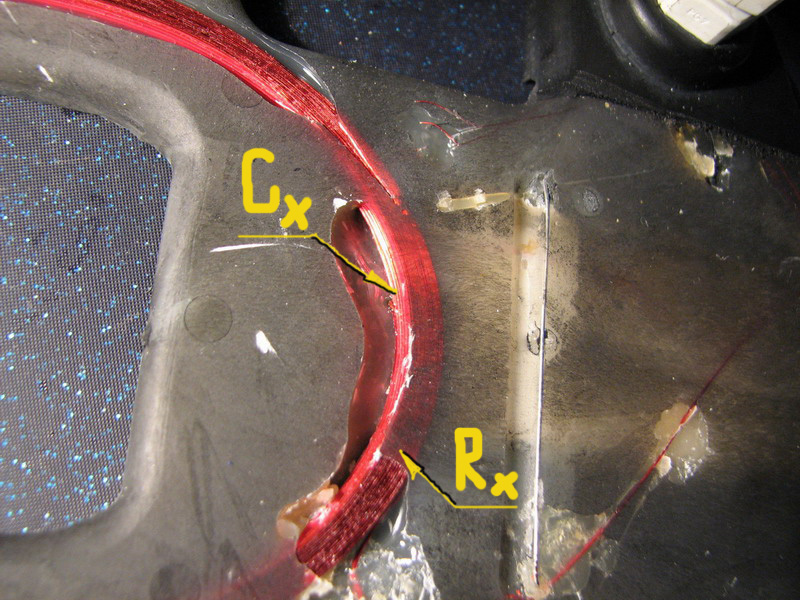

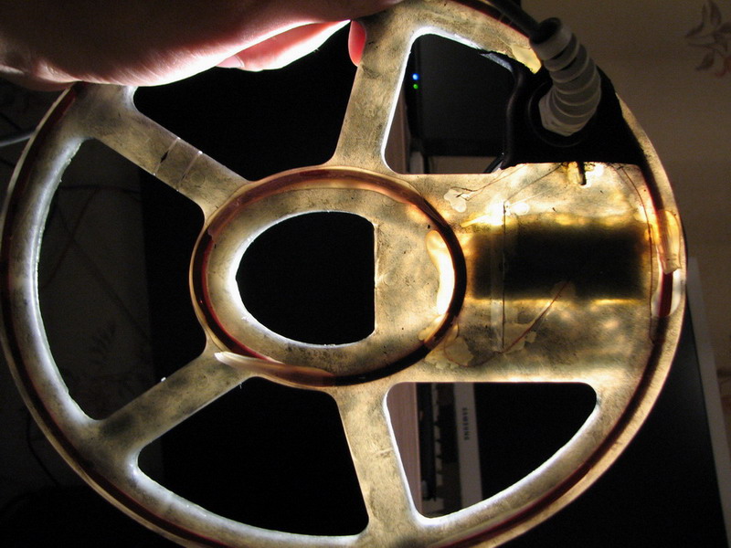

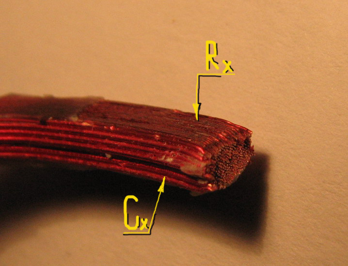

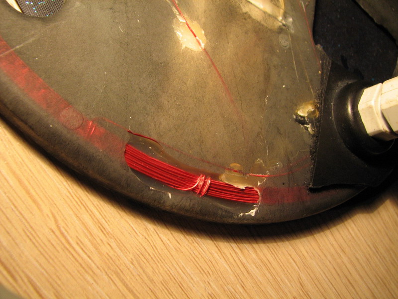

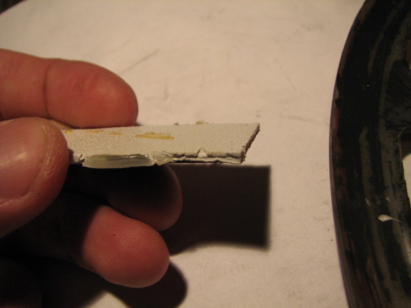

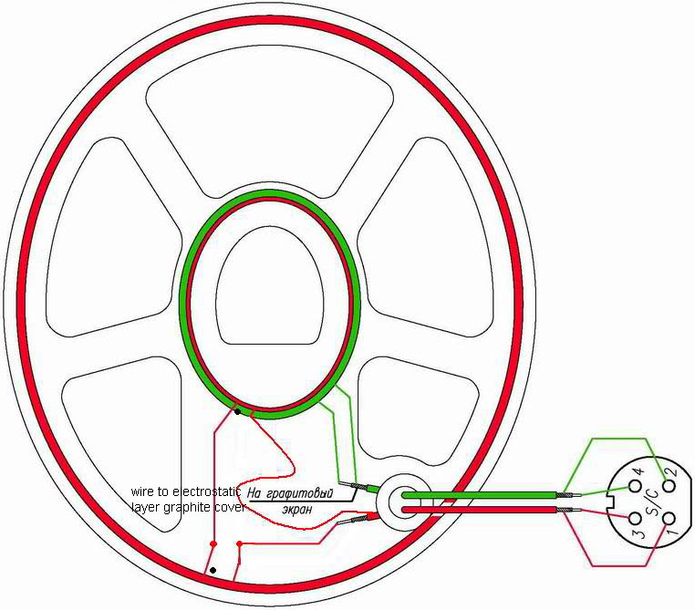

            • will share some pics of Tesoro 8x9' coil from russian forum. Click image for larger version

                • I estimate the Rx coil has ~ 500 turns
                  S

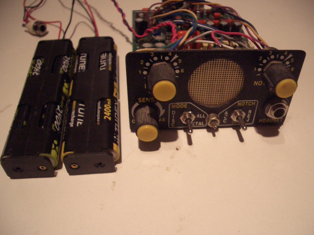

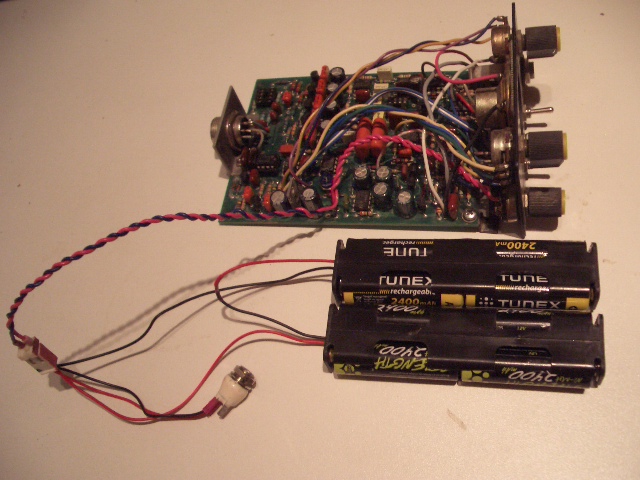

                    • hi sdowman, I did wait accu holders bought in local shop. I sold original PCB with them. I did gather with my board and testing will be continue. a coil that was with the detector was also opened but I see nothing new and interesting inside. thanks.
                      good luck
