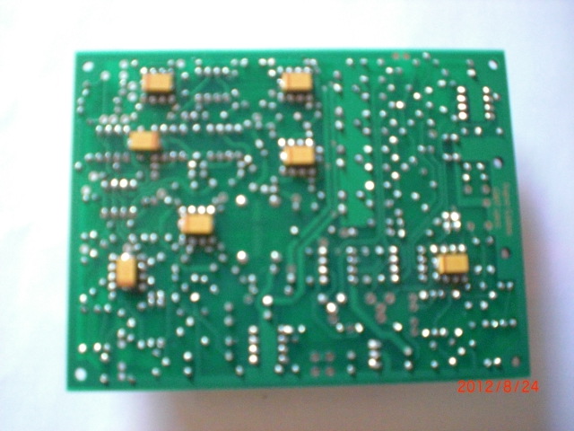

  • bottom veiw. 3,6MB. got non-polar 10uF 63V, use them instead 4,7uF too.

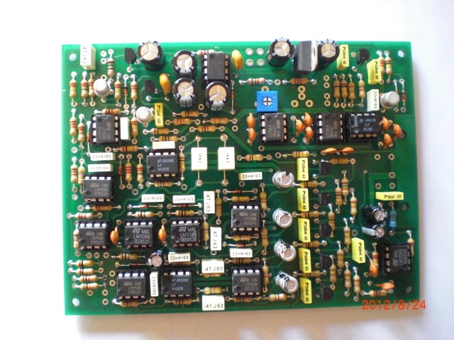

    • My PCB King Cobra is ready. Missing wires and some more. I think tomorrow I'm going to hear the voice.

        Wow, looking good, I cant wait to hear from you when its working

            Nice PCB, great work.

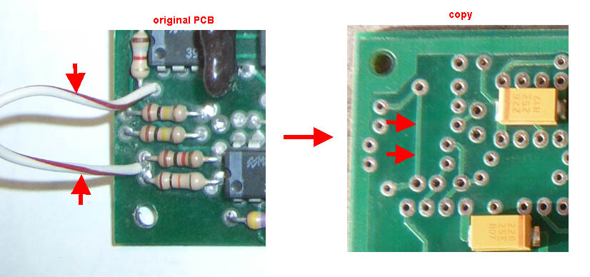

                • nice work Eduardo.
                  notice, there is not a need of to set a wire jumper, because it was done by printed line.
                  • WAW. The King Cobra works correctly the first test. With the capacitors C7 and C8 not operate the detector. This detector really works. It has 2 nice tones. I encourage you guys that works.
