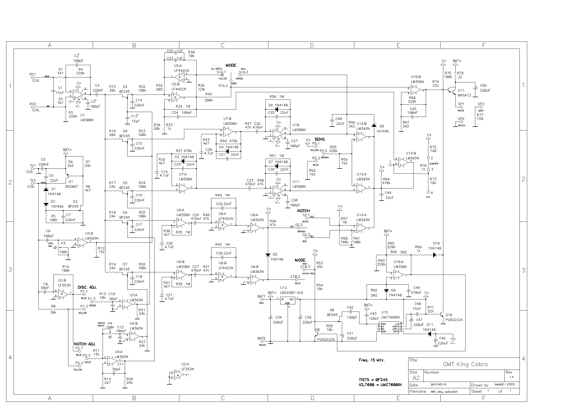

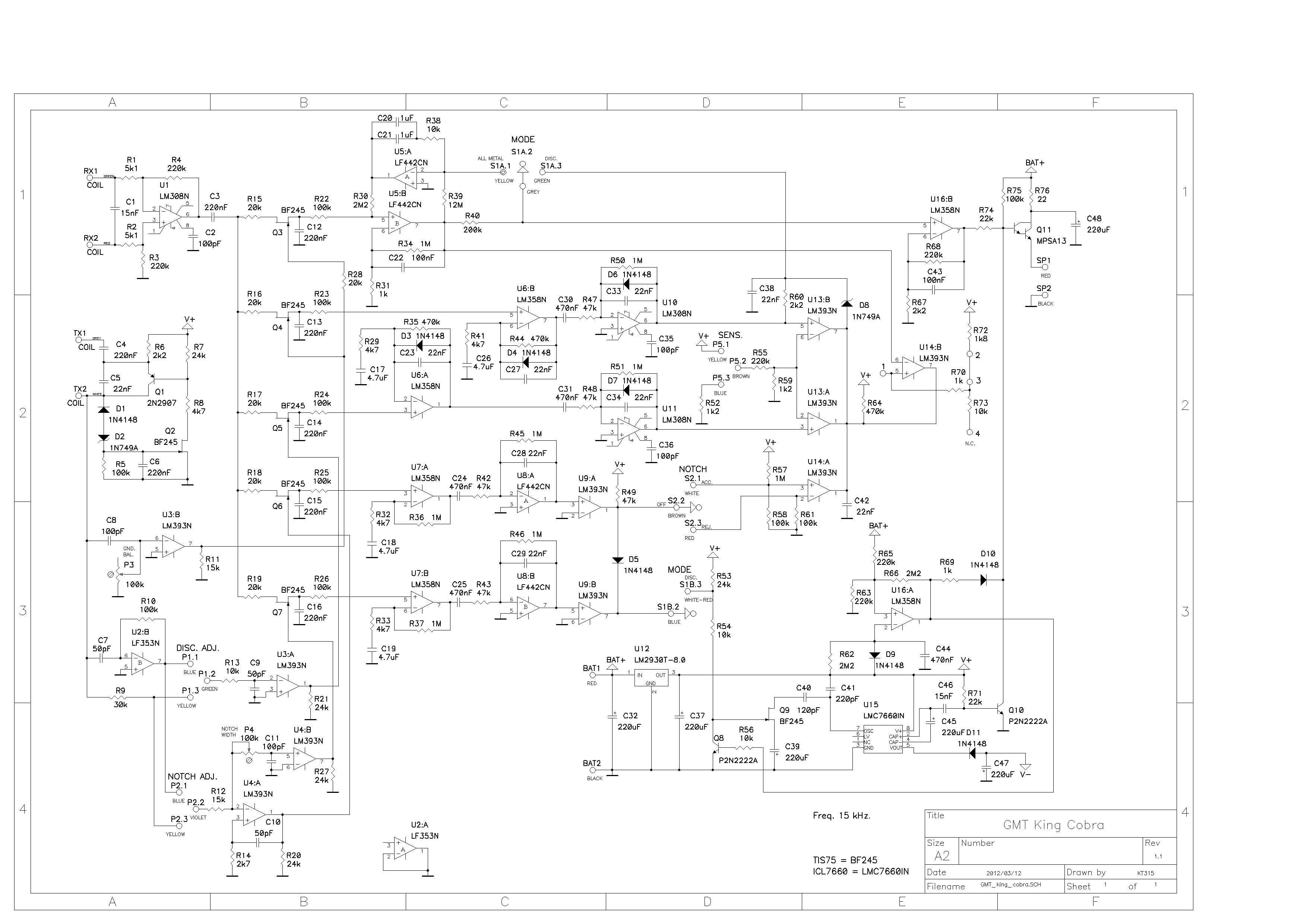

King Cobra PCB
    For KT315
    U1 pin 8 : add 100P on Ground.
    U12 pin 1 : add 470k to +V
    R75 : to -V
    R27 : 10k or 1k ?
    PCB rectified (1-2):
      Originally posted by Patrick View Post
      For KT315
      R75 : to -V
      R27 : 10k or 1k ?
      - my PCB has not the 100 pF on GND, but a place is there, so I added it.
      - OK.
      - no link to -V. really N.C.
      - R27 is 1k.
      also still change U3.2 pin 6 100pF, U14.2 6-7 pin 220k.
      thanks.
        renumbered

            Agree, most probably is the same coil as for Golden Sabre etc...
            I didn't draw pcb for it yet. Not sure if i will ever. Because; basically it is the very same "platform" as Golden Sabre. Except use of 7660 instead 4024 and those 2 transistors in negative supply. Is it better? Maybe it has better features with 7660? Maybe not. I am not sure.
            And of course; unlike Golden Sabre, Cobra has ppoint mode (static, nonmotion). Nice. If i ever decide to draw pcb for it i would probably exclude Notch part again...

                added some capacitors.
                  updated.
