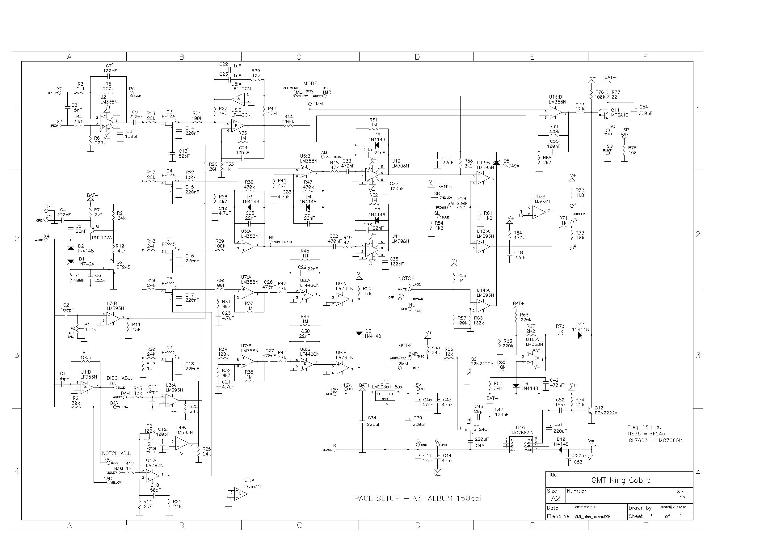

They are nice just like a king cobra and he has a few that are drilled and a few with blank faceplate box mounting hardware also for 20$each its a pretty good deal I got some for my KC project and my GMT 1650 project .

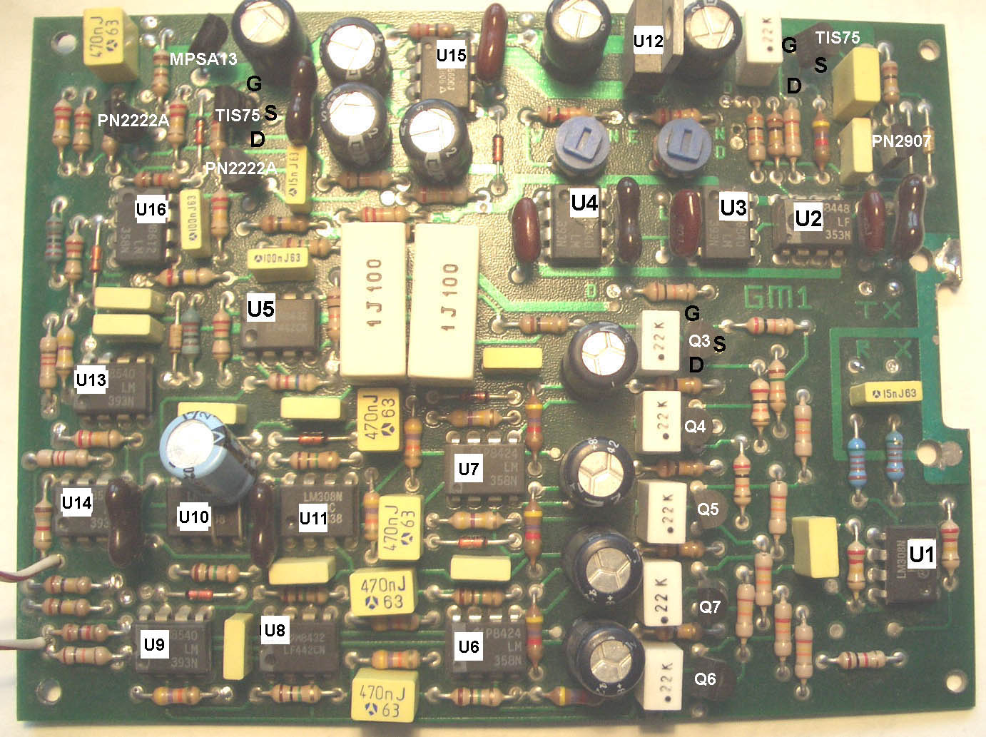

should be 300-350mV p-p and should lag TX by 44uS..
