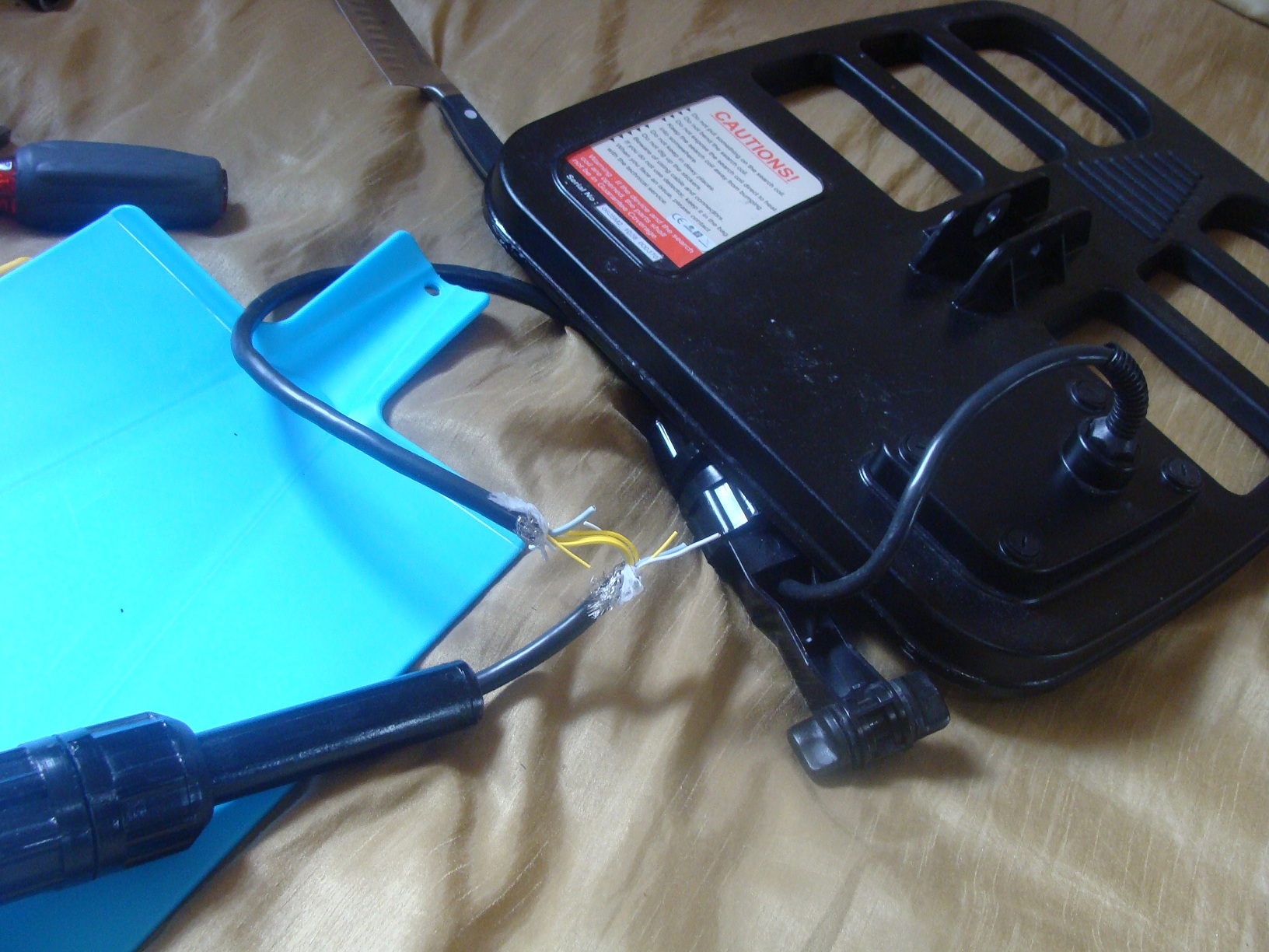

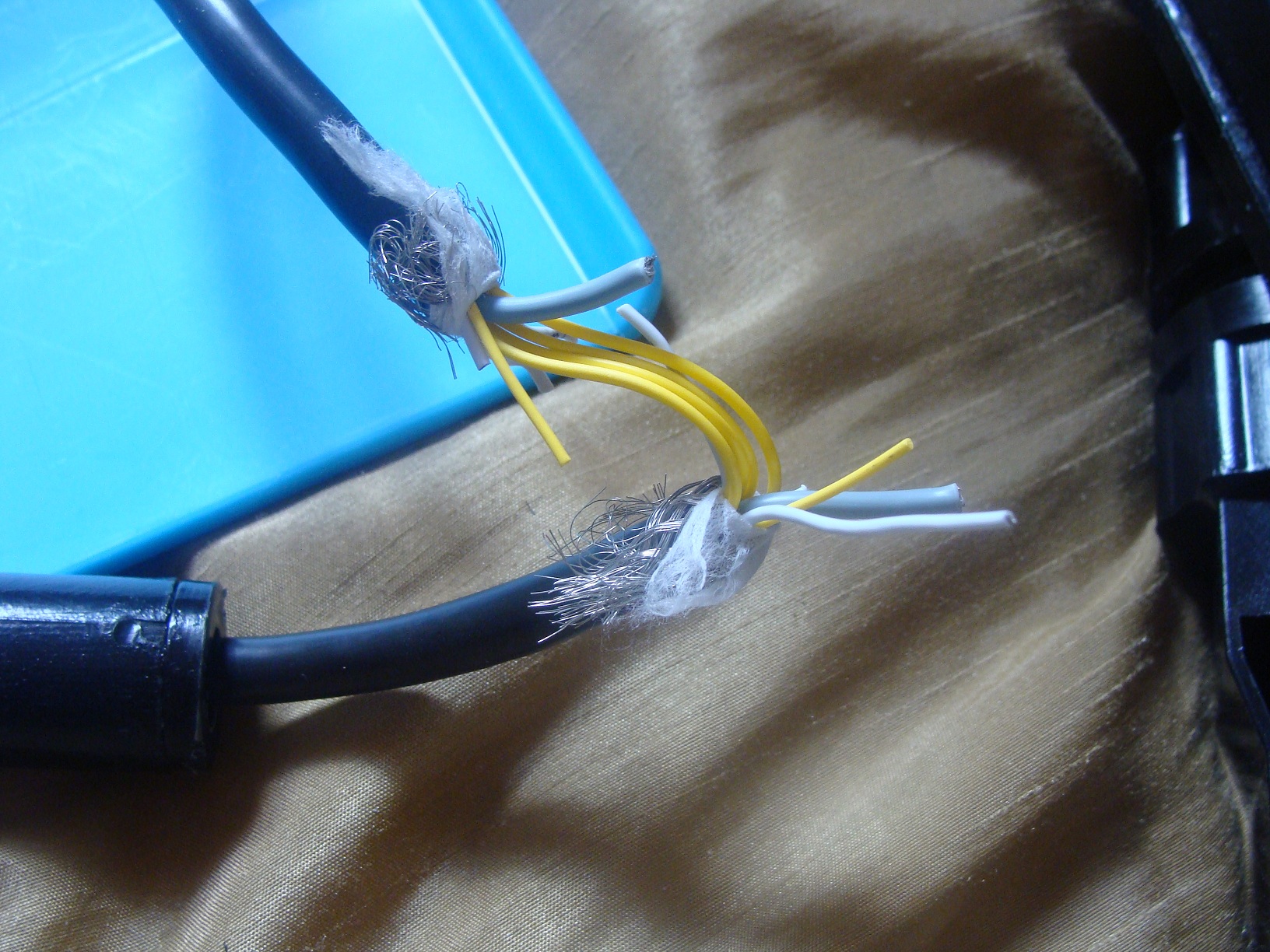

      my dog bit me the cable, pick me, I can tie it but I worry that those yellow plastic wires do not know if they are to strengthen the cable inside or if they are sensors ... someone could help me?, which would you recommend?
      please see the 2 Pictures!!!
      • we need help...
        • Wow fantastic - this is the chance for you making some experiments with other coils... - just joking - could be too dangerous if you don't know exactly the purpose and what way or how the wires are connected.
          Are you shure it was a dog? 'Cause usually that area of the cable is inside the holder-bar.
          Well, repairing this is pretty simple:
          - unisolate yellow, grey and white cables 2-3mm and solder them together.
          - isolate them with thin scotch tape a few turns and bundle them, cover this bundle with tape and now solder together the shielding. This is very important - and next use some short piece of alu-foil for even better shielding-contact and stability.
          - finally cover the repaired area with strong and flexible gaffer etc. tape so it is water-proof.
          Do all this work while Jeohunter is switched off and coil cable is not connected to main unit.
          If you need some experience first cut an USB-cable apart and fix it again.
          If the soldered broken cables are alot shorter than the intact ones (especially if the shielding wires are too short), you also can do the following:
          first mark all cables (with color or stickers etc), cut them to the same lenght (slightly shorter as the shielding) and solder everything as it was described.
          Don't use too much soldering-tin at the little wire connections because this could negativly influence the final performance.
          Here you also could get a new standard coil for 600 us$ but I don't know if it also comes with the cable:
          http://www.metaldetector.cc/index.as...OD&ProdID=1190
          If you like to do me a favour you also can measure what coil-connector plugs/pins correspond to what wire.
          Tell and show me with pix how the repair works and just ask if you need more help. Good luck!

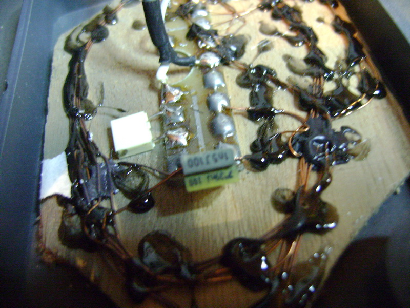

          • expensive toy, laughing toy jeosonar
            all the same, a board of wood in the coil. Laughter to tears. 600x1000 coil does not detect the car in 2.5m. 3D you can forget, it has no function

              How large is this wooden plate that seems to be directly at the coil cable connector? OK, this looks not so good, but as long as it works...
              And I could clearly detect alu-case 35x45cm @ 2m distance with standard coil and also big high-voltage electricity pylon up to 5m.

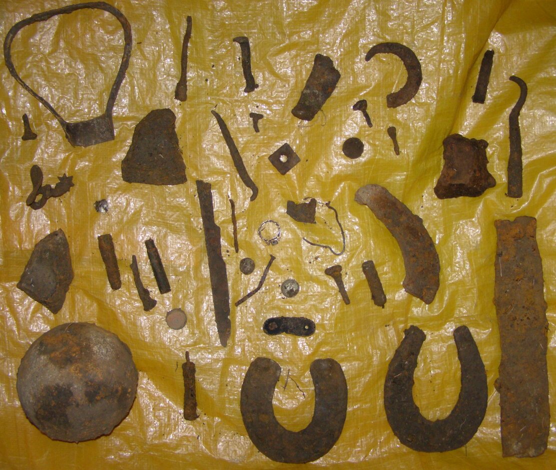

                          • Welcome to the real world, pigheaded Jeohunter-haters and ignorant Jeohunter sceptics!
                            Below the finds of today - approx. 7h of search, in the middle of a lonesome wood with small meadows and all the time little hills.
                            That's why I searched only around 2/3 with the whirlwind method @ 90% sensitivity, iron on, ground balance minus 150 to minus 50.
                            The first time that I found two horseshoes within one day and it brought me really luck - stumbled over a 12 pound heavy / 12cm diameter 200 yo cannonball that was only 5cm below the grass!
                            But I also got very little stuff! Muscet-ball (15mm diameter), 2 coins (23mm) and even very little part of pulltab (12mm).
                            Size of searched area: 80x300m, very wet and loamy soil.

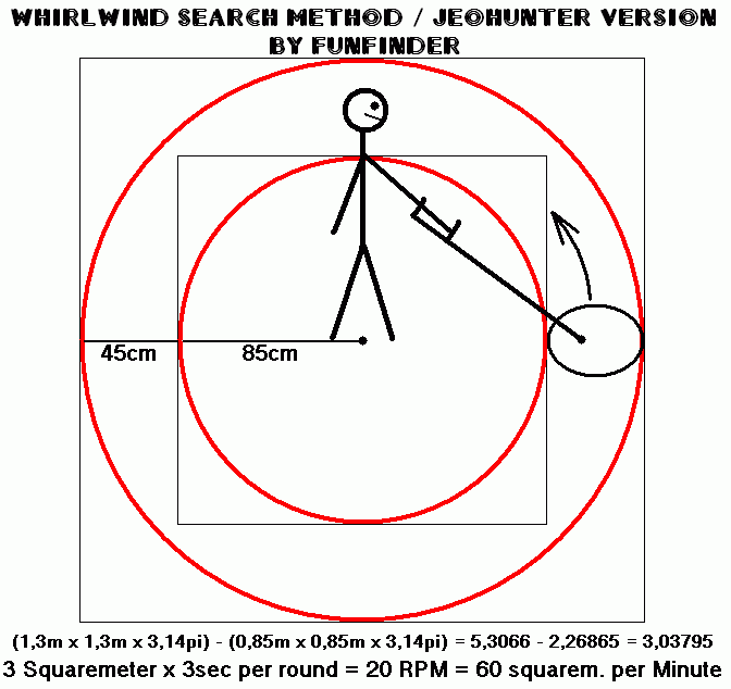

                            • Draw a nice graphic to illustrate the whirlwind searchmethod!
                              In the beginning it needs a bit concentration and body coordination but after a short while it is pretty simple and only one counterturn is needed to eliminate any vertigo.
                              But it really pays off: Until 60 Squaremeters per Minute or 3600 sqm in one hour with a 45cm coil.
                              And a second important info: The Jeohunter accu-pack (as most if not all accus) discharges itself after a while. A 3 weeks ago fully charged accu has only power for 3h left while a fresh charged one has the double amount.
                              So the best is always having 2 accupacks with you and the second one is freshly charged.
