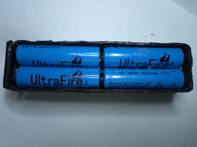

      • joehunters news accu pack
        new year new resolutions for my joehunters visual ground scanner
        hello my friends long time no see sorry for the late news because i have already finised my accu pack batteris it take long time to me to build it . i must be careful to the accu pack batteries .i don't want to make mistake again and don't want to damge high tech device .bro i consider to build the ultrafire back for what did you says.i am
        not give up person but i try my best for this device because joehunters is the best and simple high tech device for me. bro i just buy my (lipro balance charger )it is a cheap device are you think it ok ? thank for you advise for fun finder joehunters visual ground scanner . see picture
        geo-i

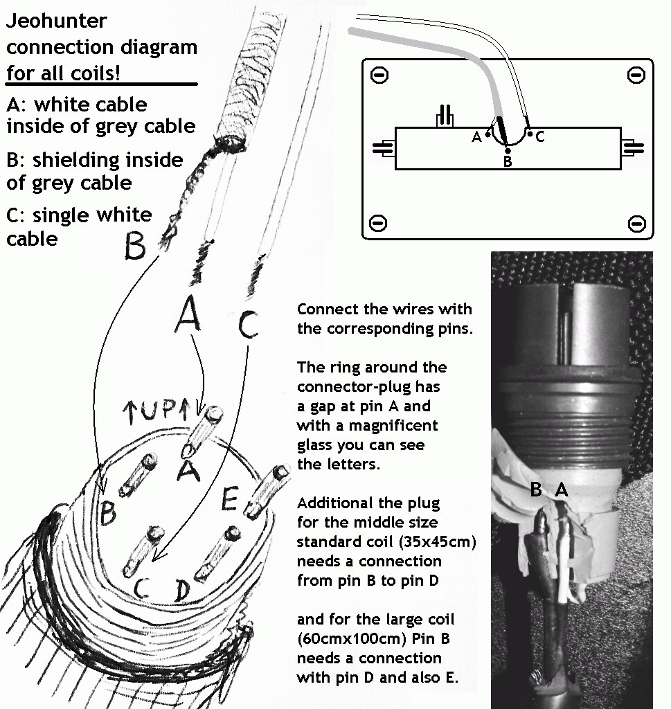

        • Jeohunter Cable Connection Diagram
          This is the complete and full diagram -
          now I have opended the 1m coil connector
          and where the cable is attached at the coil.
          The thick black cable has an additional coax
          shielding which is not connected by default,
          but perhaps the performance would be better
          if this shielding also is connected to ground
          (to Pin B). Perhaps sometimes I will test it.

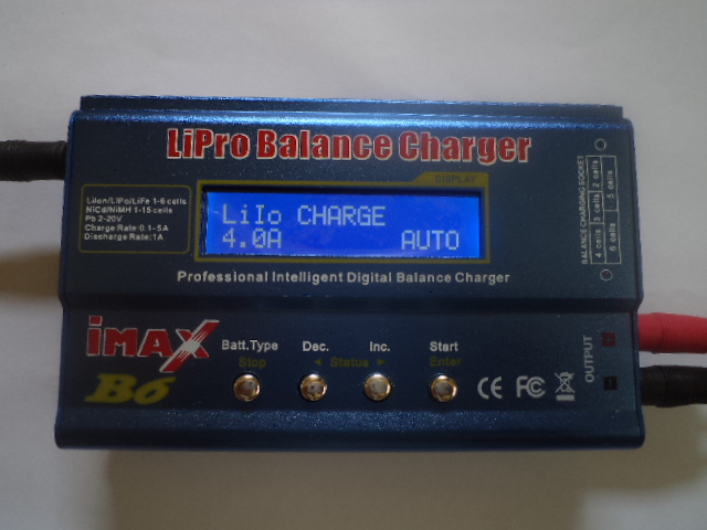

          • Congratulations geo-i !!!
            Hi geo-i!
            Fantastic! This is very good job and best possible solution!
            Full respect !!!
            You made best idea now really working! Absolut Perfect!
            And very good you have been very careful.
            Yeah - your LiPro Balance Charger seems to be really good!
            But always check correct polarity before connecting and loading
            - otherwise the charger could be damaged.
            You built my described ( Jeohunter accupack original) connection?
            __-- -[- 3.7liion +]-[- 3.7liion +]-[- 3.7liion +]-[- 3.7liion +]-+__
            ....-- -[- 3.7liion +]-[- 3.7liion +]-[- 3.7liion +]-[- 3.7liion +]-+
            With Lithium-Ion or polymer balance charger it would be possible to charge every single cell directly which is a little bit better for the cells but you would need wires for each cell or a special loading-housing for the single cells.
            The "Balance" means that the voltage and loading state of each cell is as good as in the same state/condition but the difference is not that big if you charge 4cells or in our case 2 times 4 cells in series.
            The original Jeohunter accus are not balanced and I never had any problems.
            Those packs are still the same powerful as they've been 2 years ago.
            Thank you for the Pictures!
            I see you have 100% fully charged batteries now! Thats great!
            If you like you can test how many hours the Jeohunter can work with the accus.
            And now you can try to built a second accu-pack or you can buy one of those very powerful packs for radio control helicopters etc. with 14.8 volts.
            But the accu you have now is perfect because you can attach it directly at it's original place within the Jeohunter.
            You are really very cool! Because only very few people dare to open closed lithium-ion packs and "repair" them!
            And your 6000mAh accu-pack now is plus 50% more powerful than the original one!
            Very good work , much luck and please give us more info and pictures!

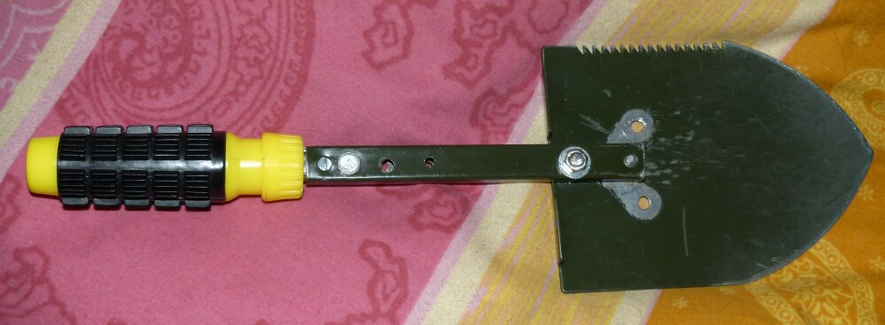

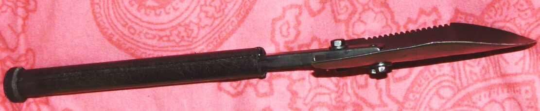

                    Below the new mini-shovel I've created today!
                    40cm @ only 350grams and sharp like a razorblade.

                          • @ geo-i
                            Now the shovel is super stability improved and: it uses the short fiberglass pole of the Jeohunter's holder which fits perfect! It's 22cm while the other part is 26cm and the weight's only 365 grams.

                              • Hi geo-i!
                                Thx. Yeah, such a lightweight mini-shovel is perfect. 43cm complete.
                                This was the original:
                                http://www.militarism.ro/en/lopeti-l...-cu-capac.html
                                but it was almost flat (no stability while digging), not very durable
                                (shovel broke off) and the weight was near the double - 680grams.
                                Here are more mini shovels:
                                http://www.alibaba.com/showroom/mini...ng-shovel.html
                                You can buy one and also improve it!
