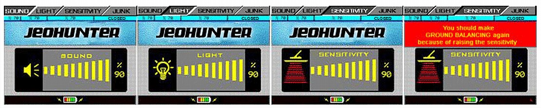

                      • Hi syed ayub basha!
                        Congratulation for your new Jeohunter.
                        Believe me, this was the best choice you could made and
                        a very valuable investment into your treasure-hunting future.
                        I'm sorry you have some problems at the moment but I'm shure
                        those will be solved very fast. For the beginning you may get a
                        little bit expierence first but you will see, after one week or so
                        you can work very good with this detector.
                        First we have to solve the continueing sound.
                        I need more information but if it is not a production issue you can try the following method:
                        This is very fast:
                        Switch on the Jeohunter - wait for the ground balance screen - press accept button.
                        Now press the setup touchpad at the upper left, you will see the below screen.
                        press two times the plus button and then the accept to go into sensitivity menu.
                        now press accept and minus to get 60% sensitivity and accept to save the value.
                        go back to the main menu and press setup and you're at the main detection screen.
                        Now you can press the reset button if the sound still is here and it should be quiet until you move metal object close. If not set sensitivity even lower and try again.
                        Maybe the only problem was that you have not pressed the reset button while making ground balance. While ground balancing lift coil from 10-40cm above ground, press reset button and plus minus until the detector all the time is quiet and finally accept.
                        Because of the very high sensitivity and the unique "static detection range" of the Jeohunter it will detect everything outside the very small "quiet band" which you can newly adjust everytime you press the reset button.
                        The easiest way in the beginning is to search with only 60-70% of sensitivity.
                        Hope I could help you and your Jeohunter works fine. And as geo-i already told - you will have 2 years of full warranty. Did you bought the standard version with 1 coil or the full version with all 3 coils?
                        Good luck, syed ayub basha!
