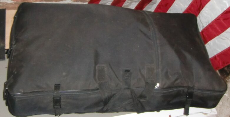

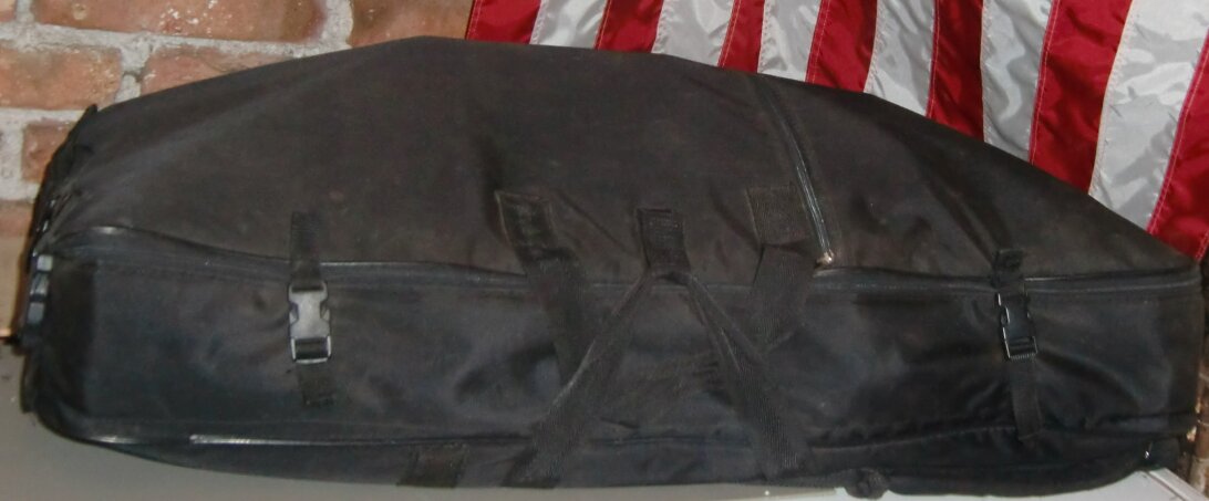

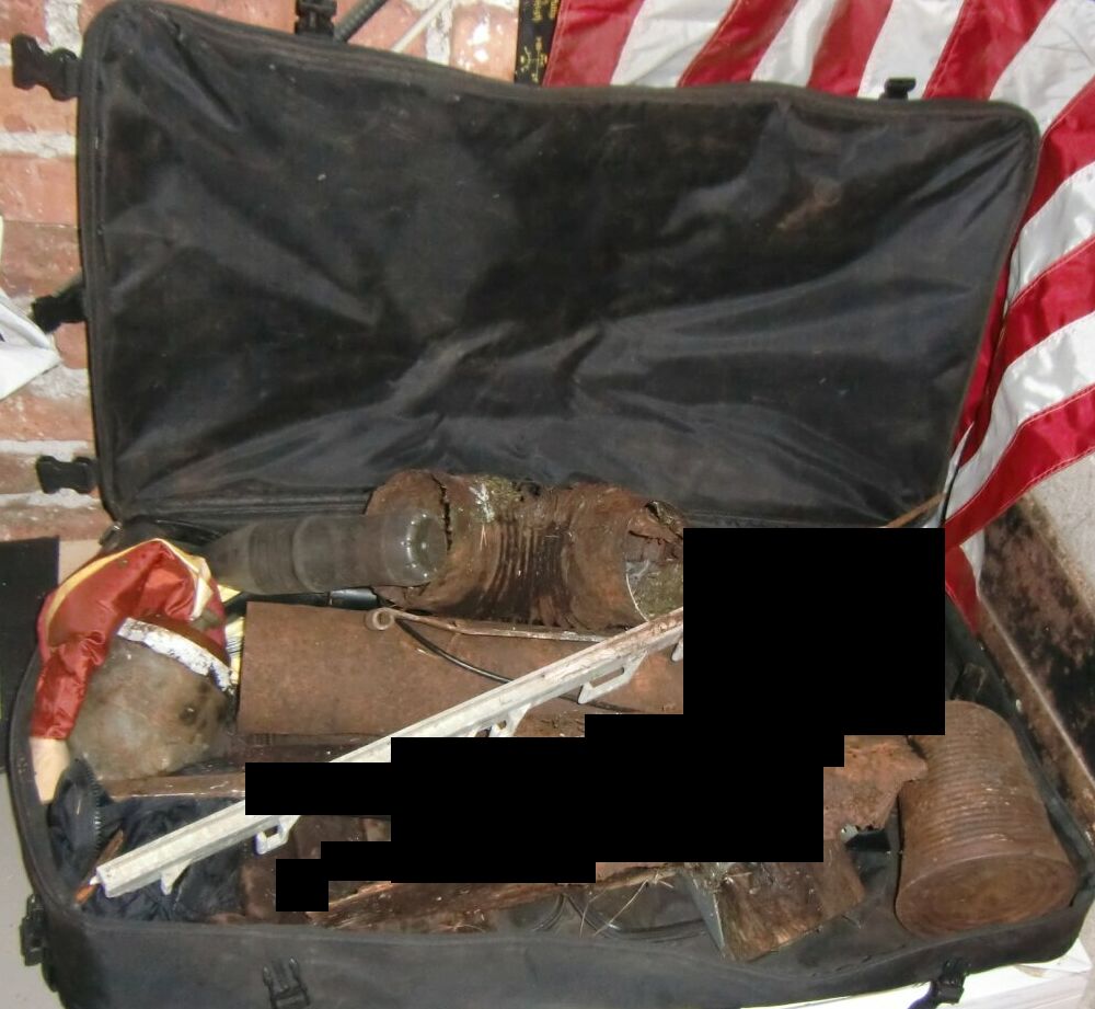

        • Jeohunter bag filled
          here
          you could see already the Jeohunter bag, but now you can see it stuffed.
          Without this bag I wouldn't have been able to transport many oversized finds home.
          • Can we take a peek inside the bag with all the finds?

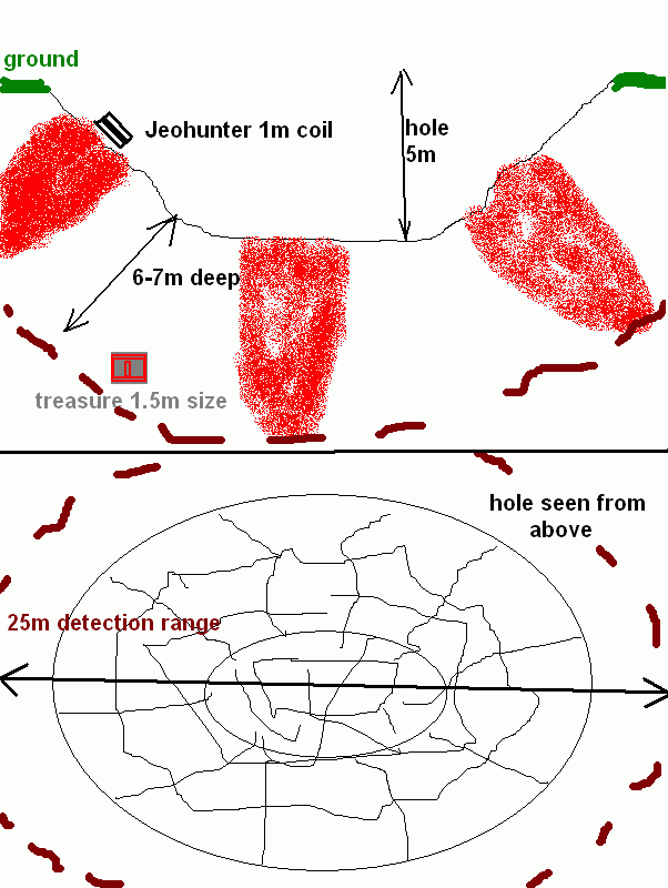

            • Hi Funfinder,
              thank you so much for your reply and the useful information. Unfortunately not really
              what I wanted to hear. Realistic 3 - 4 meter. Anyway that is as it is.
              I have a few more infos here and also an idea how to go ahead. I would really appreciate
              to get your opinion on it.
              With my site I have a few advantages. The land is flat, no hills. The land is also unpopulated and
              never was. Means if something is in the ground there a human has put it there. There is no chance
              that some old rubbish is in the ground. From there the only thing I need to know from the jeohunter
              is that something is there. I do not need to know what kind of metal it is.
              The metal I'm looking for is in the ground for more than 50 years. From there the surrounding soil should
              be perfect metalized. The size of the metal will be also significant. I can't be sure yet but at least 1.5 by 1.5 meter
              if not more.
              I already started digging but without an excavator. I'm down 10 meter and the size is 3 diameter. If the metal
              is only a meter or 2 away I can scan from the ground of the hole. But the metal is may be not that deep at all
              and I'm only out for a meter or two. My question now is if it is possible to use the coil vertical. Means from inside
              the hole I scan the walls. Considering I getting the 3 -4 meters out of it that would give me a scanned size of
              max. 10 diameter and I strongly believe I will find it in this range. From there the question can I use the coil
              vertical?

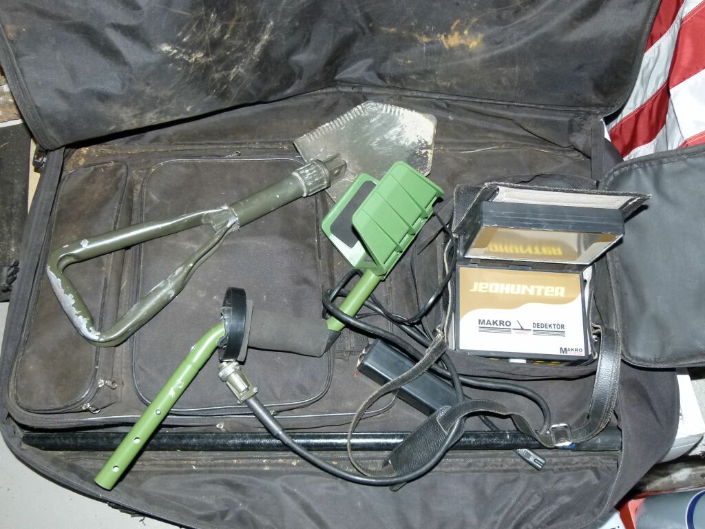

              • > ODM
                Shure, but not all what you see is just "motivating".
                The reason is the following: I wanna clear the whole location from trash so I'm always taking all I can get with me.
                This is important because often the real treasures áre buried below or near trash-locations.
                This bag is my standard bag and I use it all the time!
                The standard content inside this bag always is:
                - metal detector
                - minimum 1.5 liters of energetic drinks
                - 60cm shovel
                - pinpointer
                - knee-savers
                - some snacks or food
                - smaller bags for the finds
                - reserve accus and batteries
                - raincoat
                - special digging tools
                - sunglasses, gloves, small field-glasses, Digicam
                - protection clothes and weather protection bags for the metal detectors
                - flash- and headlights for night-hunt
                The Jeohunters bag, improved with reall backpack-stripes, is absolutly the best,
                especially if you're car is far away from the hunting location.
                35% of this bag is filled with the needed treasure-hunting stuff and the rest you can fill with even very large finds!
                Averagely seen - every hunting day I have transported around 5-10kg of finds with this bag - since 3 years.
                Some guys already thought I would transport a shot-gun in this Jeohunter-Bag and I would hunt wild dear at night like a poacher,
                but I could prove that I only hunt treasures! But you would have enough place in this bag for all kind of weapons if
                you have the need for such "precautions". The distance from one corner to the opposite is not small.

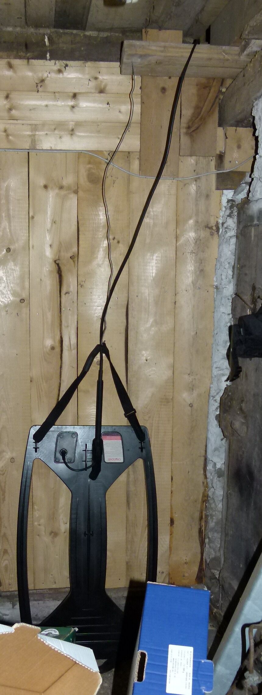

                  And I have another good news - of course you can use the 1m coil vertically!
                  I have invested 10minutes for you to create a nice picture (see below) where
                  you can see the 1m coil and the cable. If you connect the cable to the Jeohunter
                  you can "dip" the coil arund 2.5m into the ground hole or cavity.
                  You can attach a rope to one of the two already fixed holding-belts and lower
                  the coil in even very small cracks of the ground.
                  Of course you have to find out at what side the metal is,
                  because the coil is able to detect at both sides.

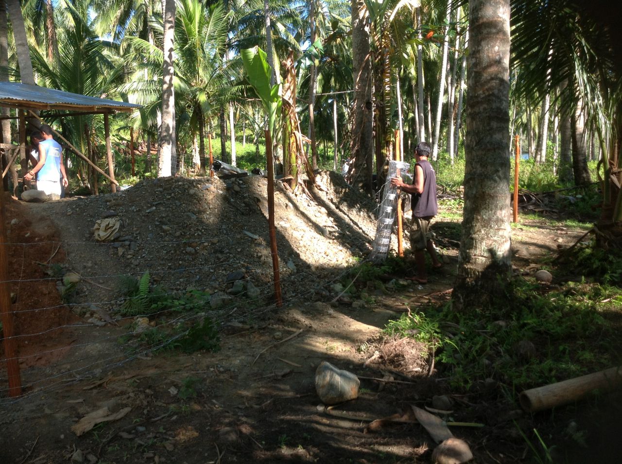

                  • Hi Funfinder,
                    Thank you again for all the information. I think my best option is to scan the area vertical as we already have
                    a 10 m deep hole. Of course I can go to the bottom of the hole and scan another 2 or 3 or even more meters
                    down but I think that in the end the vertical option will lead to success.
                    You say in your last messages that considering a big find of 1.5 will most likely lead most (90%) people
                    to misinterpret the very weak signal curve as ground mineralization.
                    Well here my question. How can I get this one right. I know this one is very specific and for sure
                    needs experience. I'm also aware that different soil and so on can give different readings.
                    So what I really want to do is to scan vertical. I try to attach a picture to show the type of soil
                    we have dig out. There are quite a few stones in the soil but few bigger rocks. It also shows the
                    vegetation around the place. As said before the area is flat and no civilization waste at all.
                    If you can get me started with this one it would be really appreciated.
                    I tried to send you a PM but somehow had problems with the comp? Have you got the PM ?
                    Thanks a lot for your time.
                    • Hi,
                      if you wait too long for reply I think you're gone and it takes longer until I check this thread again.
                      The best idea would be to dig a crater, that way you can walk with a 2nd person and the coil
                      at the slopes and you will cover a huge range for detection (see grafic below).
                      Another option for you of course would be to bury a 1.5m large test object.
                      You can try in air tests, too, but for the needed experience you better bury it.
                      That way you will directly get a feeling from what distance and what sensitivity
                      you are able to find it.
                      It didn't receive your pictures sended or uploaded by private message.
                      better attach it here directly but in moderate size.
                      You should be careful with the metal of fence and roof if it's metal -
                      the less metal near the hole and on your body the better.
                      I guess the ground and stones are just medium mineralized so
                      you will have a good chance.
Name:	treasure 1m coil area.gif

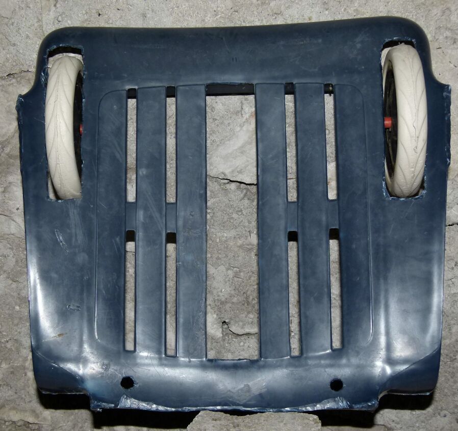

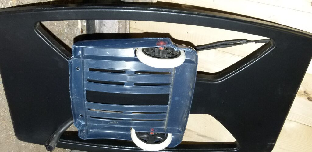

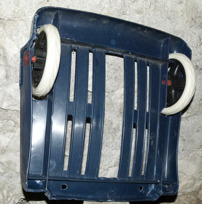

                          btw. at the moment I'm working on a rolling device for the 1m coil -
                          have already the plastic-wheels and next I will attach them; I'll show you this invention in near future.
                          • 100% plastic!
                            Well, the future is already now, just 3 days later.
                            This rolling-device was create from the seat-area of a garden-chair.
                            Today, within 5 hours. Completly by soldering iron and a knife only.
                            For attaching to the coil simply a rope is needed which leads through
                            the both holes and that is wound around the inner region of the coil.
                            The wheels are ca. 5cm behind the coils center-gravitation-point
                            so is very easy to draw it and keep the horizontal balance.
                            Perhaps for drawing I also will use some 1.5m plastic rod for even better balance.
                            Coil to ground distance is around 10cm with the wheels -
                            if more distance is wanted something can put inbetween.
                            The plastic axis' are around 1cm thick, taken from a sponge-glasses-washer.
                            At the moment it's adjusted for drawing the coil on its "small" side,
                            but with some adapting tricks I also should be able to draw it with the broad side,
                            for covering even more ground.
                            Of course this is now ment for relative flat and even sites only,
                            for other areas much larger wheels would be needed.
                            I guess some car-toys for Kids should have larger plastic-wheels.
                            But for the moment I'm very happy with my newest invention -
                            it enables me to use this 1m coil in: "top secret single person mode" !
                            And now please somebody do such wheel-thing with your 1meter P.I. coil,
                            I'm curious how it would look like!

                                About the coil and wheels - shouldn't the wheels be aligned with the shorter edge of the coil?
                                Thx for interest for my new wheel-device. Well, it doesn't matter how the wheels are orientated, because the detection is non-motion,
                                but even if it would be motion it's no problem. You also can move a DD-motion coil from backwards to forwards instead of left and right,
                                any direction that causes induction imbalances will work.
                                For the best gravitational balance of such a 1meter coil its the best if the wheels are located at a position of 55% close to the body,
                                so the back slightly heavier. This is because of the coil-cable and the holder, stem etc. which add weight which should be compensated.
                                And if the back is still a bit more heavy its still better because its more easy to push the coil-holder down while dragging the whole thing.

                                > You also wrote in your previous reply that cavity at 7-8 meters depth is beyond the reach of JeoHunter. Can DeepHunter reach that as it is newer?
                                If the "old" nonmotion circuit that works with 1m coil has been improved, the Deephunter could be indeed deeper, but this circuit already is very
                                close to the borders of technical power, especially at "Sensitivity 10 setting" so there may not has been changed alot. And the new 47cm motion coil
                                never can be deeper as the 1m coil, it has less then the half size.
