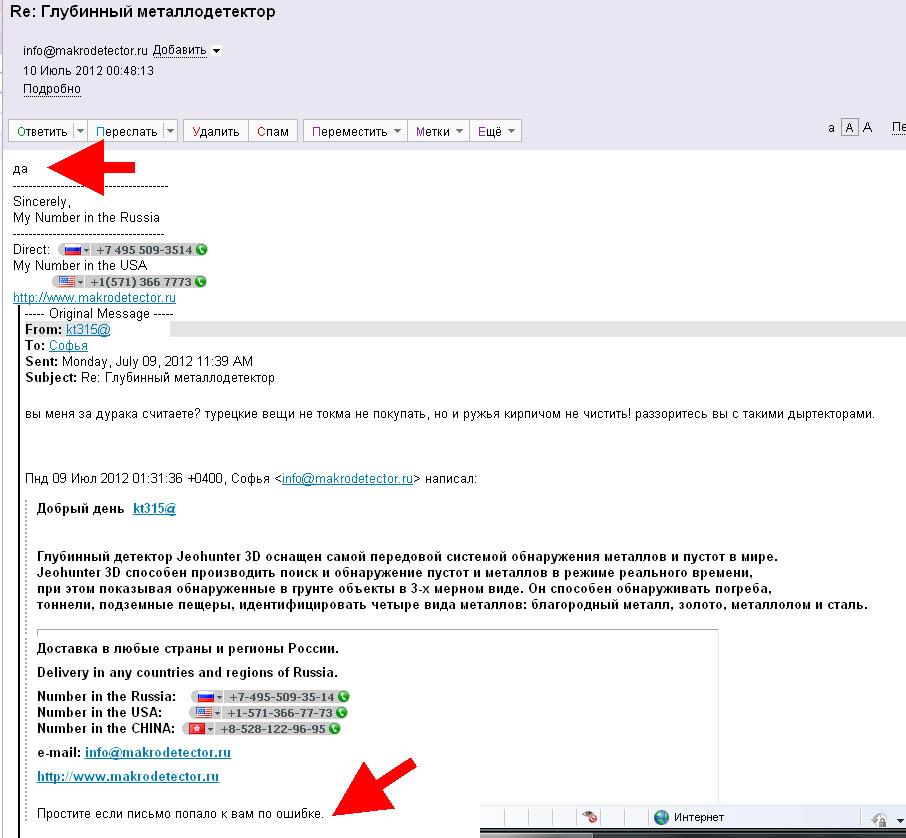

                • JEOHUJ-SPAM. Leave me OFF, idiots! Forget my addresses! such'i deti, kak vy dostali vseh svoim obmanom i debilizmom!

                  • Did they ask you to become a reseller *huh huh*
                    Well, I have nothing to do with it but thanx for the russian info.
                    The Jeohunter especially with its 1m coil is for special tasks
                    and alot people aprpreciate this.
                    This is not one of those 100s allmost all the same usual
                    MDs or all that almost the same "good" working homebrew stuff.
