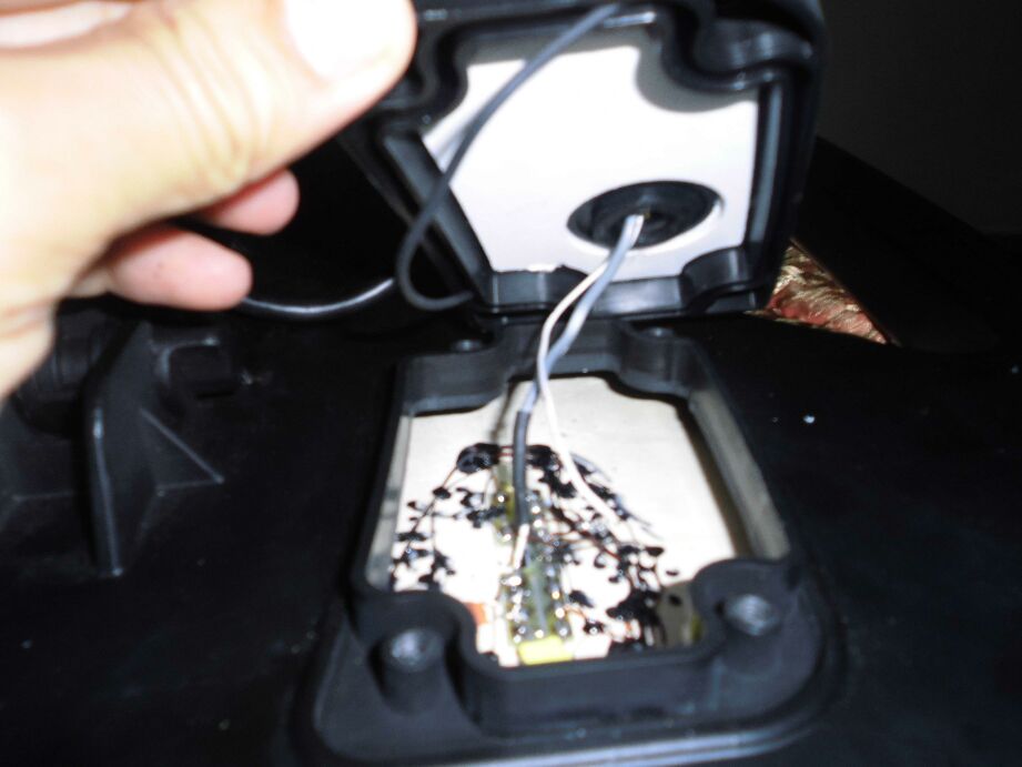

    • This jeohunter bobines have probleme with all coils,it's very sensitve to moisture.
      1m coil has short circuit because wet ground.
      • Hi maimoune,
        hope you will get soon reply from makrodetector and you can send them the box for repair.
        The electronic box is real tough, you can even shock-frost it and it works without problems.
        The coils are secure against rain or wet grass etc. but not water-proof enough to dip them under water.
        But I doubt it's moisture inside the coils resonance tuning circuit box
        usually such an issue only would lead to a temporary failure and
        after drying it everything would work fine again.
        But I hope its fully dry now inside and you can improve the water-proof issue
        by using water-resistant glue at the ouside of the coils cable box like I did.
        Good luck that everything will be ok soon, I'm waiting for your news.

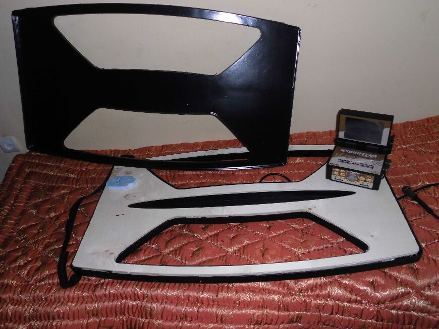

        • coils jeohunter 3D 100x60
          insid search head jeohunter

          • Originally posted by maimoune View Post
            Before posting your photos, please reduce them to around 800x600.

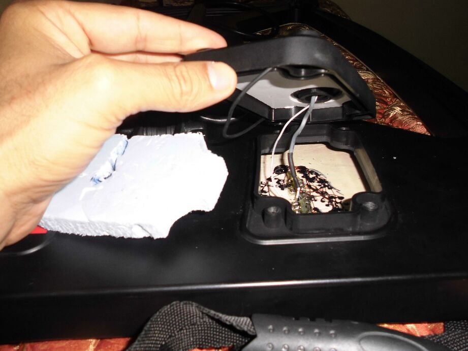

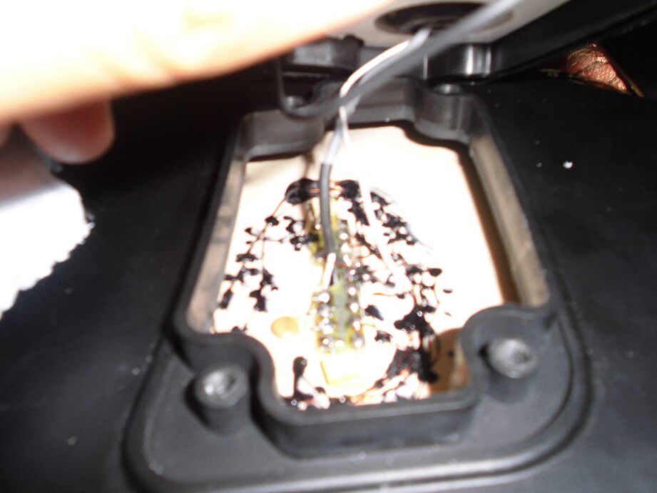

            • jeohunter coils
              inside jeohunter coils

                Well, seems the coil is alright inside, as long as you didn't ripped off any cables.
                But you must not open the complete coil, just only the part with the plastic screws
                where the coil-cable leads into the coil to see if there is some moisture or water.
                Good luck that your Jeohunter will be soon working again.

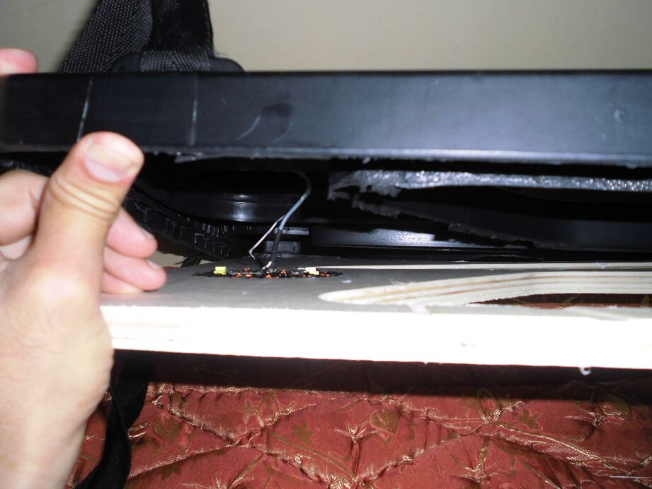

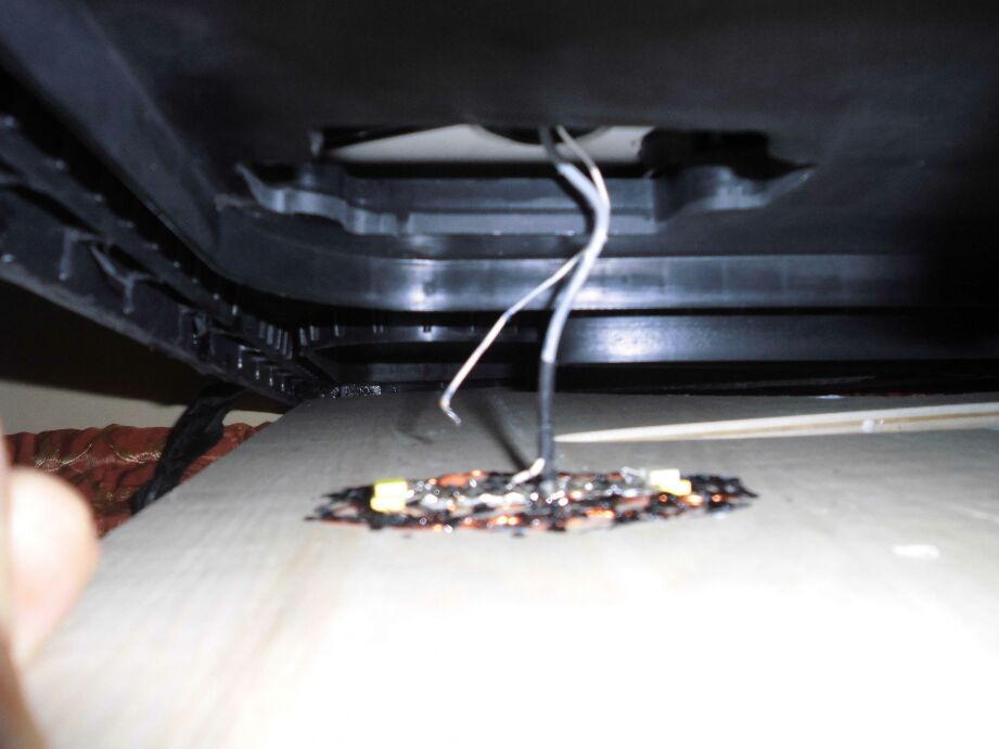

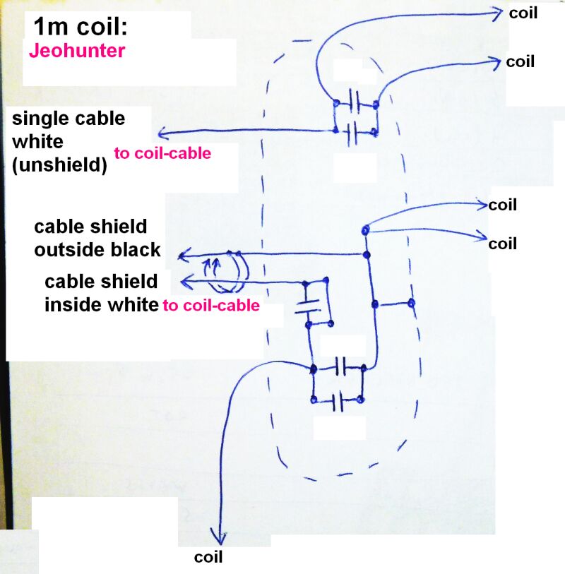

                • @ maimoune
                  I recognized that the single white cable is ripped off.
                  This is not good and perhaps it has happended while the coil was opened.
                  Below you see a plan at what location it has to be resoldered.
                  If you can't do it by yourself, please print the below drawing on paper and give it to someone
                  who can do it for you and who can find the correct soldering-location spot.
                  It is not very complicated to find it on that small single sided pcb.
                  You even may see a little piece of ripped off wire at that soldering point.
                  good luck.
                  • Thank's FunFunder
                    No ,my freind cut the white cable,and we see the message search head is not determined was disappeared, but the detector not detected anything.and when he resoldered the cable jeohunter give message that search head is not determined.
                    I think the problem comes from the box.
                    Best Regards

                        maimoume,
                        if that determination problem did occured with all 3 coils
                        it is pretty clear that the box is the reason why,
                        because not all 3 coils would be broken or wet inside etc.
                        How did you open the 1m coil?
                        And can you fix it again?

                        • Hi funfunder
                          yes, the box unit system faillure, not the 3 coils .
                          very easy to open all coils ,it's fixed with black glue selicone only , and easy to fix agine .
