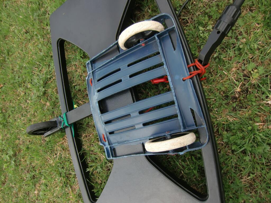

      • Welcome huge world - the 3.wheel of the 1m Jeohunter coil is ready to go!
        Finally the real "high-efficiency" treasure-hunting can start:
        Now with the 3rd wheel its possible to drag the coil the broad side over the ground.
        The idea how to attach the 3rd wheel was simple and perfect - using just some very hard wooden board for the wheel-fork
        and improve the strenght there, but usual it's only around 4-12 kilogram weight force - so no big deal.
        Depending if the 3rd wheel is attached below or over the coil (both is easy possible), the coils ground-distance is ca. 5cm to 15cm.
        This is perfect, depending how flat etc. the surface is. And as it has been tested already, its no problem to search at
        sensitivity 80-90 if this huge coil is almost directly over the floor. If it would be higher just a loss of depth would be the result.
        At very stony etc. regions or inside some kind of jungle still the possibility with 2 holding belts exists - the usual 2 persons solution.
        But sometimes its better to do such work on your own, not all the time somebody else has time etc.
        Of course to dig really deep and large holes someone to help would be great, and with this coil I will go for the real deep and huge stuff.
        In our modern days of china-plastics such a "scooter" could be produced very simple and cheap and perhaps Makro Group will see
        the fantastic possibilities such a device offers and includes it to his profi-package which also includes the 1m coil.
        If the non-metallic pole and the coil-cable is long enough or extensionable, such a "highspeed-searchcoil" also could be attached behind a car or bike.
        That way flat huge regions are open to real treasure-hunting and discovering new promising hunting sites will come in easy reach.
        With this construction now per instance even deep sunken larger war-remainings can be found just by driving around fields, plains or whatever.
        This coil is sufficent to find already 3-5cm (1-2'') small stuff near the surface but the real power starts with around 10cm finds and below 50cm depth.
        Of course everything with discrimination and also cavity can be found.
        Not to forget: treasure-hunting this way is much more relaxing! Its like a walk in the park and dragging some lightweight cart behind.
        Even some drink-bottles and food in plastic-boxes can be put on top of the coil so the backpack or whatever remains lightweight -
        at least in the beginning.
        And what I sometimes like the most is..... discrimination by size! That way someone can fully concetrate on the "huge finds".
        Many of them still are crap but its still much faster to find the real precious big stuff and those finds which are not reachable
        by the usual sized metal-detectors (with coils up to 45cm) at all.

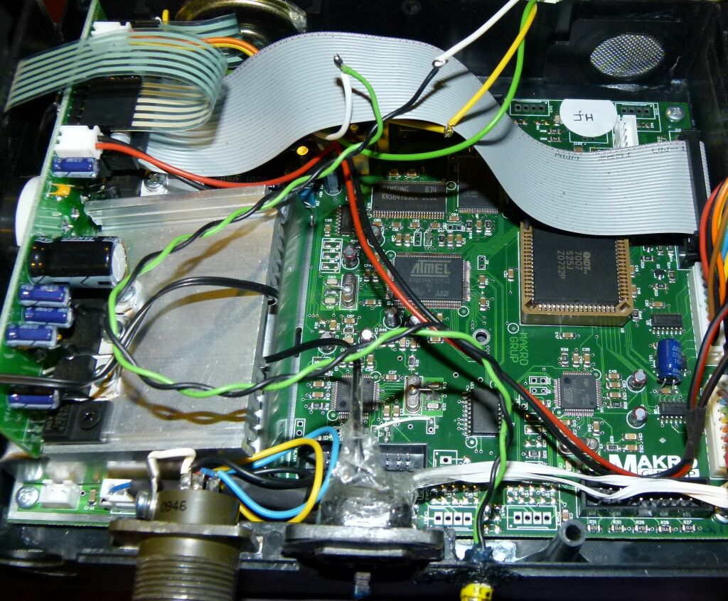

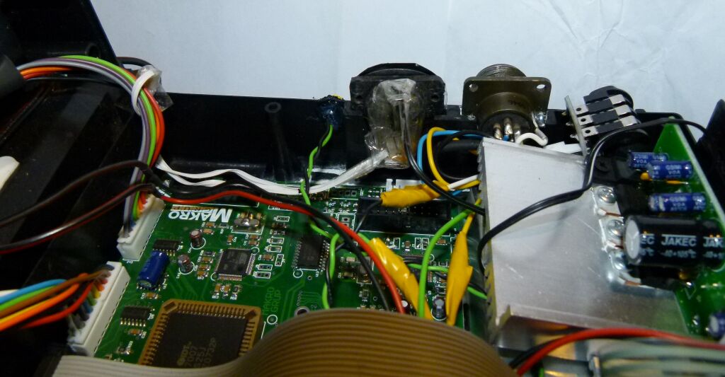

            • Jeohunter Volume Mod 2014
              My Jeohunter is already from 2010 and it was produced and developed around 2008-2009 but it is still a great and of course fully working detector!
              My DeepHunter moding-activity yesterday was inspiring, thats why today I made the Jeohunter volume mod.
              I had a spare "big potentiometer" but I wanted to save it for something else later so I used one of those little variable resistors.
              After I soldered the cables I filled the backside with melted plastic so it will hold at the Jeohunters plastic case.
              btw: learn to melt plastic with your soldering-iron, learn to bring plastic into the wanted shape and form if its fluid, it will give you alot profit.
              Afterwards fastly get fresh air into your working-room or use ventilation otherwise it coud became a serious health risk.
              But I did this already hundred of times an never had any problems, so don't be too afraid.
              And depending on the chemistry you should not get a huge amount of direkt smoke or fume into your eyes, it could feel like acid.
              But it can absolutly give you great results if you melt plastic-stuff with your soldering iron or mount parts directly.
              Have some paper tissues ready on the table to clean the soldering iron from the fuming rests directly after every working step
              to reduce poison gases and don't burn your fingers while cleaning the soldering-iron tip - it can happen faster as you think.
              the mod is totally simple:
              Disconnect and remove the accu-pack.
              Open the 6 screws on the bottom, cut the white cable (the yellow one does not work) which leads to or from the headphone jack
              and solder 2 cables and 1 variable resistor or potentiometer inbetween.
              Of course this mod is pure luxury if Audio Volume step 1 out of ten still should be too loud.
              And yes, personally I think audio set digitally to only level 1 sometimes still is a bit too much.
              btw. The most simple mod (I used so far) is to stick some cartboard before or inside the speaker hole.
              Finally find some place where to fix the variable resistor - The side with the other connectors is the best choice.
              If you are experienced in melting plastic you can directly join the resistor with the plastic box wall, no problem.
              But I haven't melted any larger grip or handle to the little usual screw-driver adjustable turnable part of the resistor,
              because it was already good enough by default at the used location for adjusting the volume directly with the fingers.
              The Jeohunter now after 4-5 years may be already "retro" for many persons but If you can get it for a good price
              and if you are interested in cavity detection and very deep larger objects it is still one of the best detectors ever.
              And you can even modify the DeepHunters 1m coil to use it with the Jeohunters coil-cable connector and use
              some wheel-roller for the ultimative treasure-hunting experience!
              Jeohunter 2014 volume mod c.jpg connectors from left to right:
              headphone, coilcable, resetbutton-connector, LCD-on-off switch and now the new volume control

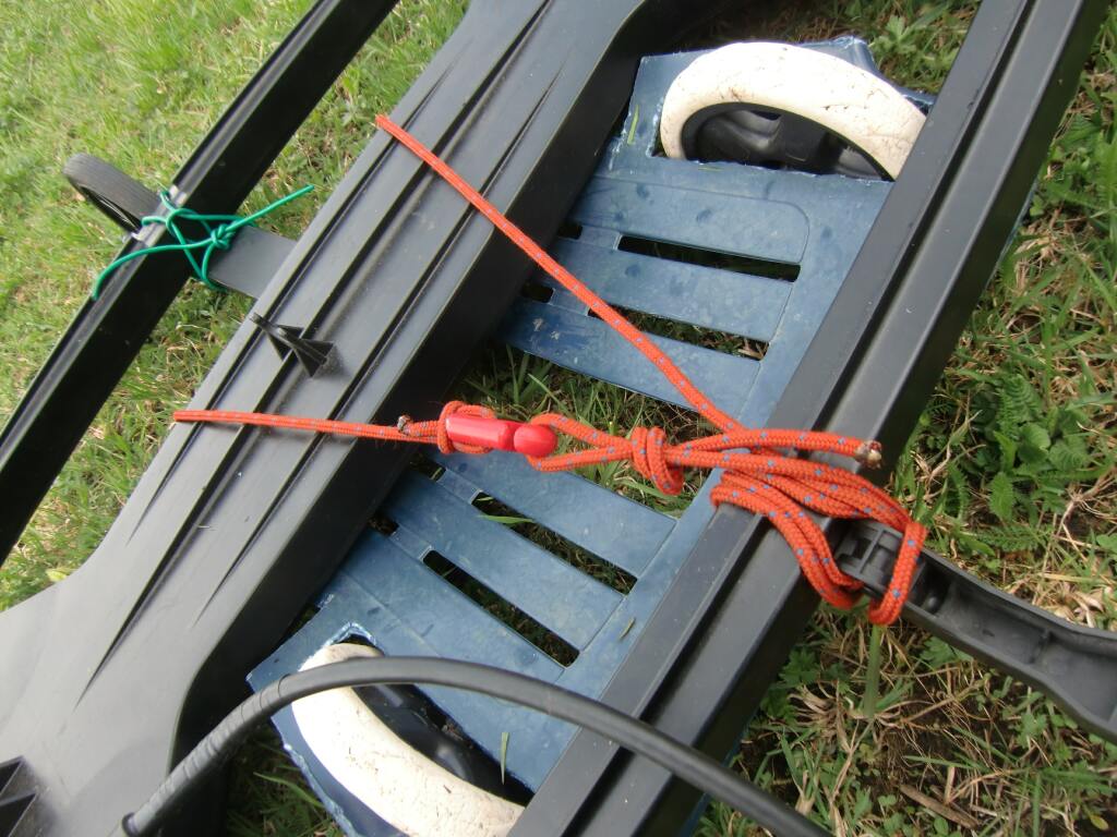

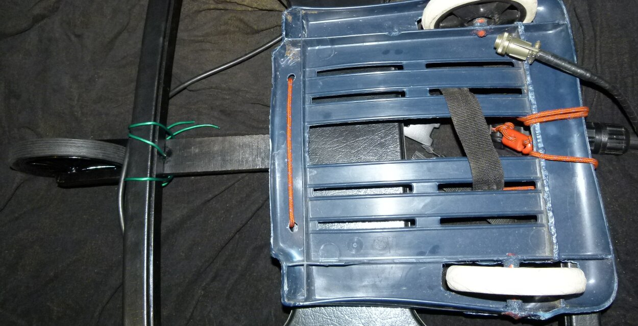

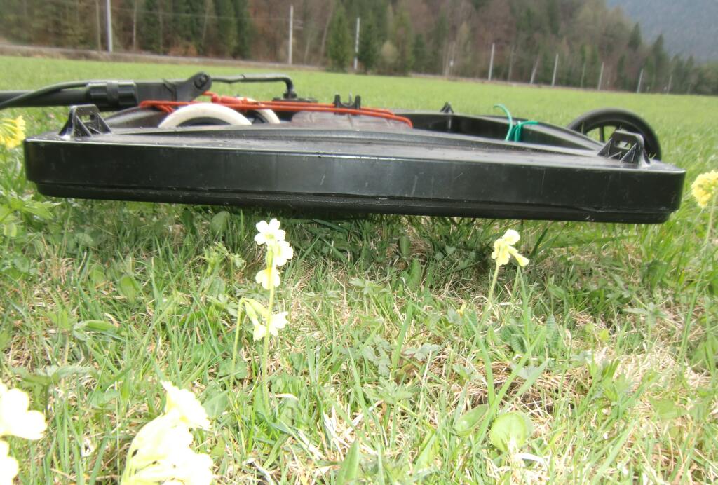

              • MEGA SEARCH
                Attention:
                The following treasure-hunting method was completly invented by me.
                It works perfectly with Jeohunter and DeepHunter ONE METER coils!
                Please don't copy it for other detectors with lousy 1m P.I. coils - you need induction balance to get it work.
                The coil moves perfectly at around 7-10cm (3-4 inches) over the ground !!!
                Draging is super easy !!!!
                See the pictures to get finally a first REAL VIEW of the size relations in this world - HUGE MEADOWS ETC. NEEDS HUGE COILS, at least 45cm!
                The pole has to be fixed beyond the edge of the coil so it can be layed down on the ground and to roll the coil forwards but also back.
                Weight:
                I brought the detector, 1m coil and what was else needed by mountain-bike to the hunting-ground, but you need some fitness for this,
                especially if you have to transport afterwards heavy finds the return way. Better use something motorized.
                Sensitivity:
                It is truly amazing, but the Jeohunter's and also the new DeepHunter's 1m coil is able to hunt with sensitivity 80% at such very close range over the ground
                WITHOUT false beeps - with iron on and at normal to fast pace speed.
                Of course this is much better concerning higher find-rate compared to walking with this coil 20-35cm over the ground with 2 persons!
                Maximum sensitivity: With some experience and with reset-button mod it is no big deal to hunt at 100% sensitivity and with iron off.
                User-Friendly:
                This is perfect - even a child can drag this coil hundreds of meters over the flat areas!
                Needed:
                A lightweight Mini-Metal-Detector for pinpointing is very useful. See the last picture, such a cheap 30 Euro security-detector already does a good job.
                Cavity:
                Don't forget: With DeepHunter or Jeohunter and the 1meter coil, you also can find huge cavity and cellars. No P.I. will show you them.
                Searchcoil-cable:
                It has to be fixed near where the pole is attached to the coil to reduce swinging and moving around.
                It is absolutly no problem leading the coil cable over the outer ring of the search-coil and fix it directly where the pole is mounted by a rope.
                turn around radius:
                ca 1meter or 3 feets
                This means if you wanna go back you can "drive" easily if the road is 2meters broad
                but of course you also can move the coil by hand directly 180° against the earlier direction.
                Extremly high amount of searched area:
                This coil is 1meter broad (and it can find already stuff from larger coin size if its close to the ground !!!).
                Here some calculation:
                1meter broad and walking forwards 2,8 meters in one second x 60 = 168 square-meter per minute !!!
                168 x 60 = 10080 squaremeter per hour which is a size of 100 x 100 meter or 10 x 1000 squaremeter
                which means you can search 10 rows each 1km long if you walk at 10km per hour speed.
                With usual detectors (and heavy 45cm coil work) only a 5-10th of this is possible not to forget
                the extreme burden for the muscles while draging the 1m coil is as good as no work at all.
