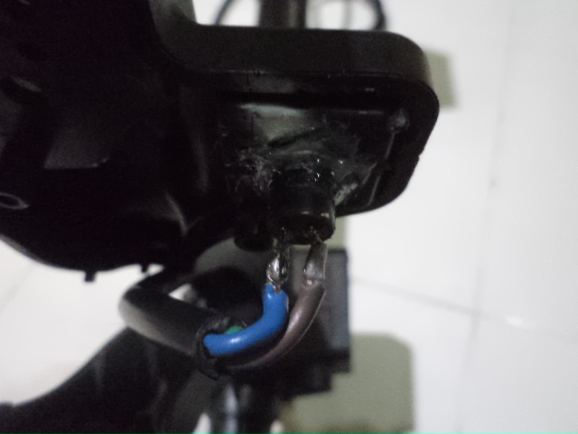

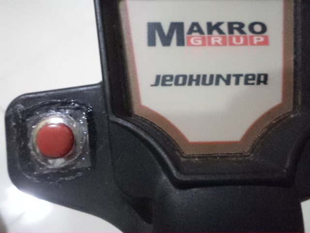

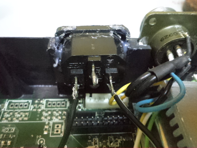

              • reset button modification
                hello my friend fun finder can you help me i try to build
                reset button modification as you show but all recipes is
                enough i thing why the functions is not right are you
                sure the connection circuit that you give is correct ?
                i hope you can help see picture
                geo-i

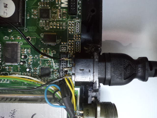

                • tried double check
                  hello friend perhaps you are mistaken
                  please tried double check again bro
                  when i try to install the joehunters
                  the screen ground balance it sound
                  repetitive and the ground balance
                  cannot be adjust switched cannot
                  move are you test the device bro
                  what happen and the problemo .thanks bro
                  geo-i

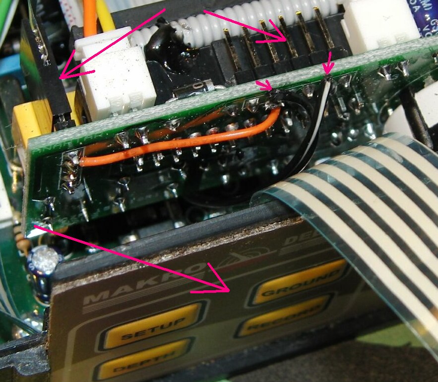

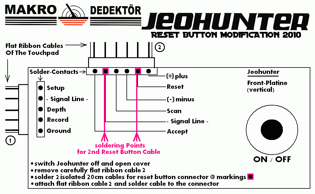

                  • Hi geo-i,
                    my big respect! You are the first who tries the reset button mod!
                    You will see this will work perfect!
                    But first I will help you to find the error.
                    We will find the problem very fast because this is just a simple multiple on-off switch configuration!
                    If you press a touchpad button, a contact will be closed:
                    from the (both connected) signal-line contacts to the corresponding button (see below)
                    What I can see is: you have soldered the wires in the right way but you may have forgotten to attach the flat ribbon cables after the work or you have plugged them in from the wrong side!
                    Attach the flat ribbon cables in the exactly same way as they have been before.
                    Both should describe a bow form from outside view.
                    And make shure there is no permanent contact between the new cables,
                    the both connectors/plugs or the switch / little pressable button you want to use.
                    Please show me a picture of the attached flat ribbon cables and of the touch-pad panel so I know this is the same.

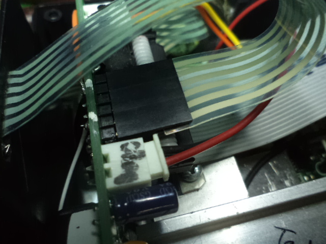

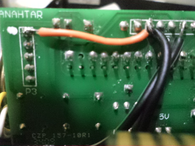

                            • touch pad& flat ribbon
                              hello my friend fun finder here is the picture of the attached
                              flat ribbon &touch pad panel bro .but i have a another problemo
                              with the window screen goes like crazy bro please help SOS
                              i hope you can finish this problem.thanks
                              geo-i
