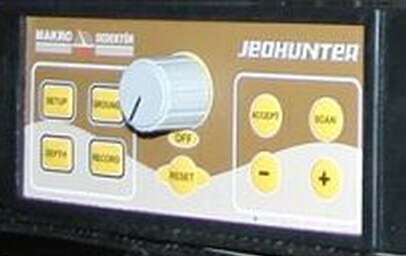

  • Hi geo-i, my brave friend , hope you're still relaxed and confident.
    OK, the above flat-ribbon cable is attached correctly.
    And if you haven't done anything with the left flat-ribbon cable
    then there's no way for any problem with it.
    If it's the same front touch-pad panel as you see below
    then the connections have to be identical.

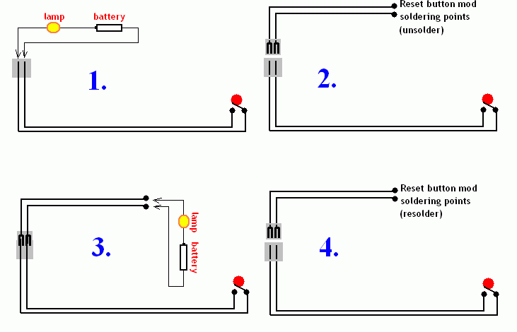

    What we do now is to narrow the fault:
    1. create lamp-battery circuit, unplug reset button cable
    and test if lamp only shines while new reset button is
    pressed (if lamp always shines: find and remove the
    shortcut or damaged button and test it again)
    2. unsolder the both wires near the flat ribbon
    cable and test if Jeohunter is working OK now
    3. plug reset button cable and test if lamp
    only shines while new reset button is pressed
    find and remove the shortcut and test it again)
    4. carefully resolder the both reset button wires
    (don't create any soldering shortcuts)
    ONLY while you press the button the test-lamp should burn
    or the Multimeter electricity should flow.

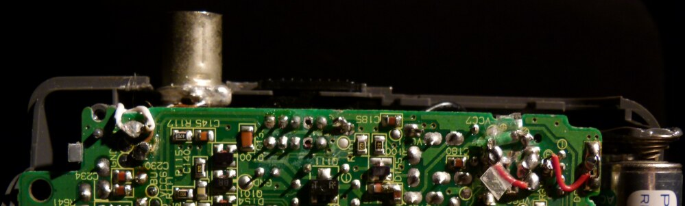

    PS.
    Below you can see my newest microscopical work:
    Casio LCD-TV net-adapter plug minus to plus reversed
    (the area was 1x1cm) and attaching an antenna connector.

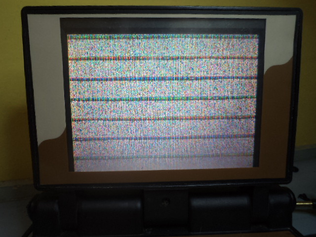

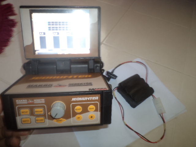

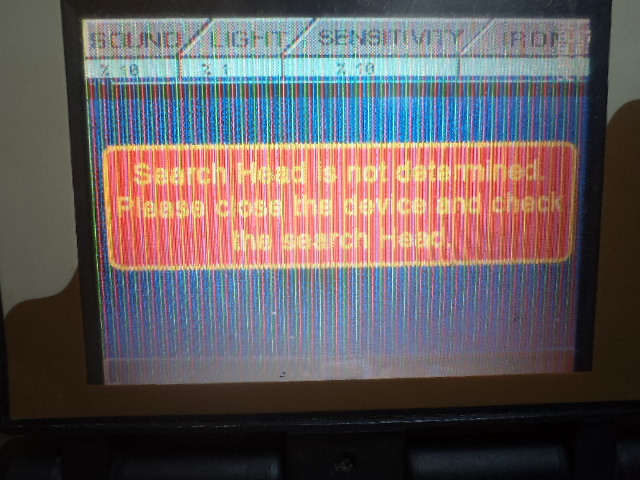

        • window screen joehunters
          hello my friend fun finder thank every thing but i have a big problem
          i am worry about my joehunters the screen does not produce
          proper way and the picture do not stable no sound got out
          it like dizziness please help me bro SOS
          this are the picture of '' window screen goes like crazy''
          • Hi geo-i,
            this window screen is crazy!
            Do you have really had connected the
            coil-cable while shooting this first picture?
            I really have no idea what's been happened,
            but the Reset Button Mod cannot be the fault,
            because even if you had created a shortcut this
            only would have the same effect as if someone
            presses all the time the touchpad reset button
            while turning the off Jeohunter to on.
            So there must be a different cause!
            Perhaps while opening the box you have
            created some loose-connection at one of
            the plugs. Check out the 2 plugs with the
            colored monitor wires in the back of the box.
            Try to remember exactly what you have done
            after opening the box.
            - Have you switched off the power first
            as I've told or removed the accu-pack?
            - Was there a smell of any burned?
            - Have you removed a cable and forgotten
            to plug it back?
            - Have you touched a part of the mainboard
            by some piece of iron, wire etc.?
            - Have you done the above described 4 step test?
            - is the reset-button cable still there or removed?
            I need answers to all of those questions
            if we should have a chance to find out
            what has happened. And if you may have
            made a mistake you know about please tell it.
            At the moment I can't make any predictions
            if your Jeohunter is somehow broken or not.
            It may be only some kind of plug problems.
            It would be fine if you could make some
            detailed pictures of the opened Jeohunter.
            Let's hope the best for the moment. :detective
            PS: Yes, you have the identical touchpad -
            it can be seen at your picture from here:

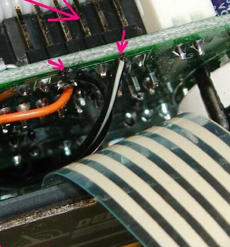

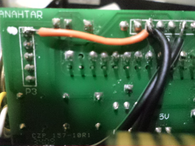

            • direct soldering!
              geo-i, your DSC00660.JPG shows me that you have
              removed the vertically printed circuit board. Why?
              This board holds the on-off switch which is very
              dangerous if the accu-pack was still attached!
              This whole vertical circuit board removement
              was not as described by me (see below),
              because you can simply solder the both wires
              easily without removing that PCB and
              without creating possible troubles.
              Because the both needed contacts are directly at the
              opposite side of the upper flat-ribbon cable.
              I hope nothing serious has happened at this action.

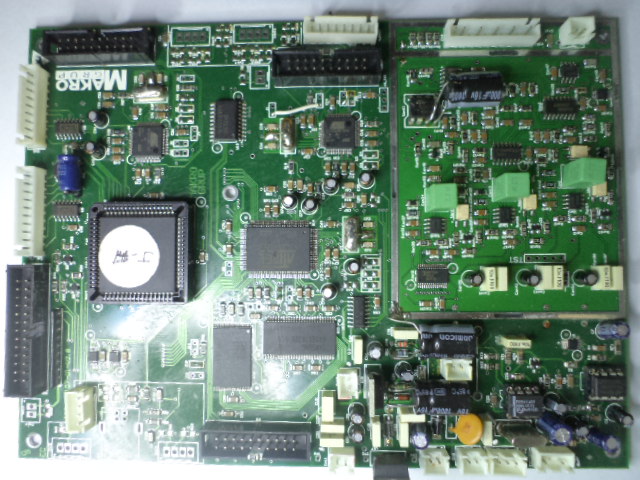

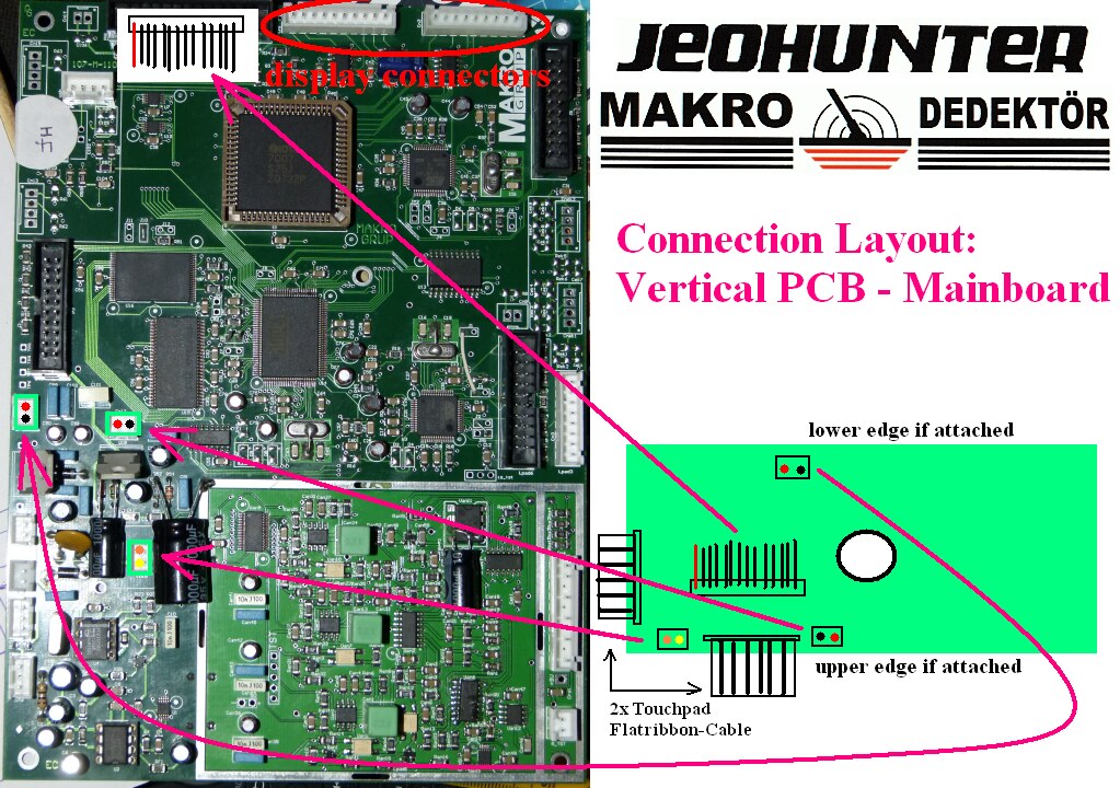

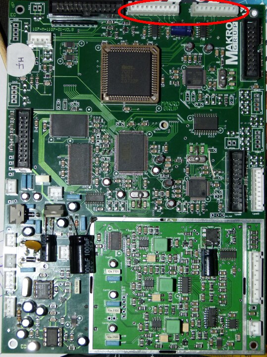

              • Jeohunter Connection Layout
                Hi geo-i,
                hope the especially drawn 4 U schematic helps.
                You must control that every cable of the
                vertically pcb leads to the correct plug.
                Check out first if you have the same mainboard
                as shown below (the lower right region contains
                the transmitter/receiver & detection circuit and
                is usually hidden below an alu-housing so only
                compare the rest of the board if it is identical).
                Be very careful about the 2 black/red wired cables -
                don't confuse them - one contains the full 14.8v.
                Always draw a little schematic of the
                correct wiring before you remove cables!
                Check out that the cables really lead to the
                correct plugs like you can see in the layout
                and that the plugs have a good connection.
                Make shure the color of the wires finally
                will have the same position as shown!
                Good Luck!

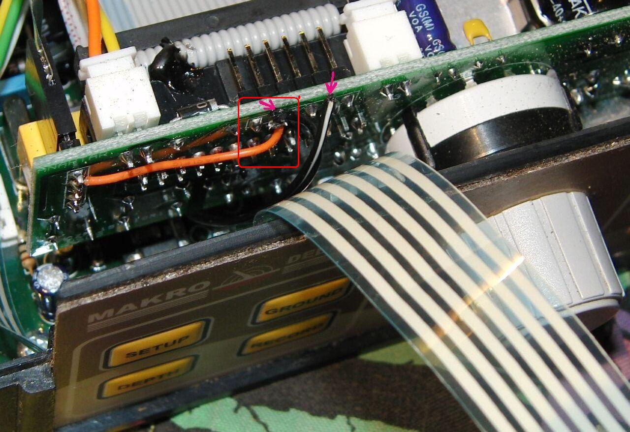

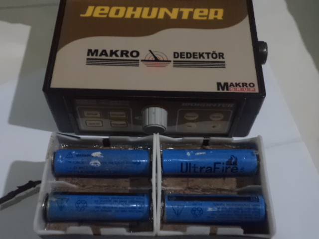

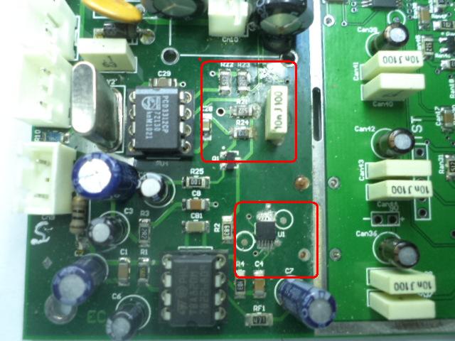

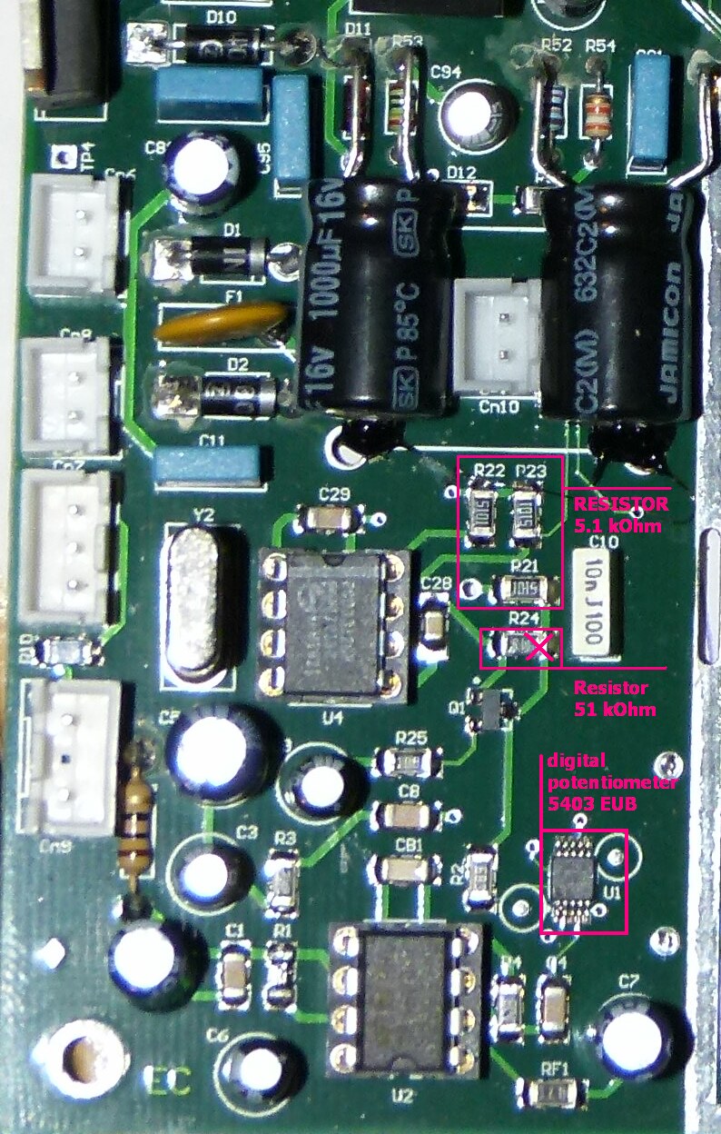

                    • correction of circuit
                      hello my best friend in your question there is a many answers
                      yes i switched off the power fist and remove all the accu pack
                      and i remembered last week when i build the joehunters accu
                      pack with the ultrafire i discover di scomfort smell burned in the
                      box of joehunters i quickly pull out the accu pack switch and
                      removed all cabel . after that incident i did not use the device
                      for one day and decided to build new joehunters accu pack
                      but with different case it can remove easily i waited for 7 hours ,
                      after i saw your modification reset button i am i feel more interest
                      to make one but i was doing it wrongly due to the circuit is not clearly
                      shown . i only decided the ciruit got burning smell shown in 2 red circle. thanks
                      geo-i

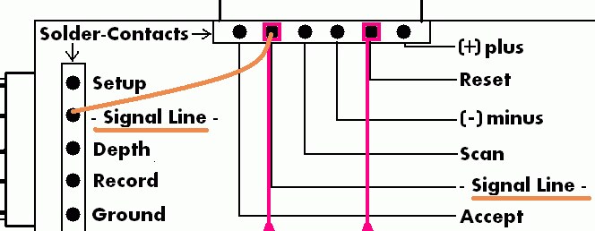

                      • direct soldering
                        hello my friend according to the picture diagram shown i am quite confuse
                        about the connection whether both of the 2 cabel orenge and black is been connected together see the picture.thanks
                        geo-i

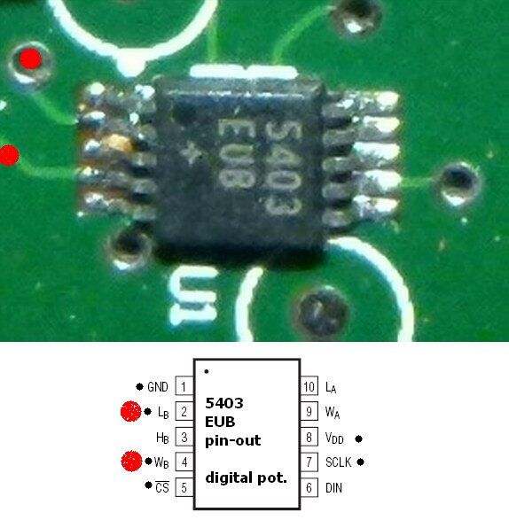

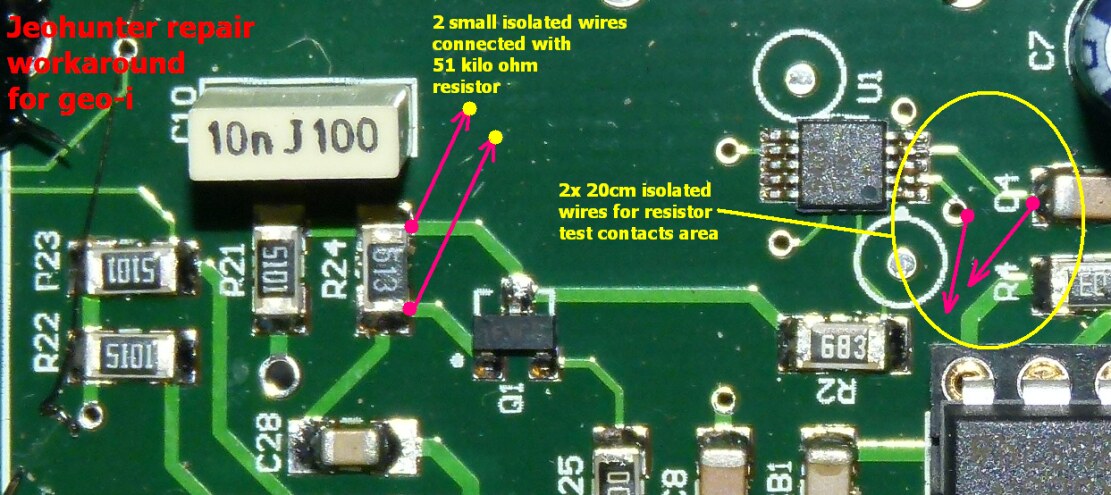

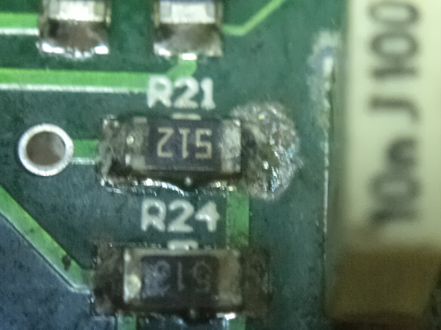

                          • @ geo-i

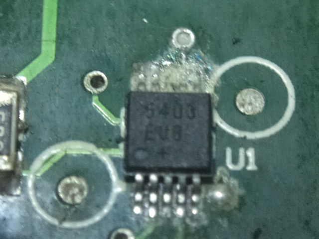

                            Looks like your later accu-pack wiring
                            has destroyed parts of the power circuit.
                            Before you do anything further you have
                            to be 100% shure that your accu-pack
                            really has 14,8V and correct polarity!
                            Your picture is OK but very hard to see -
                            seems R24 was burned and U1 5403 EUB.
                            R24 is replaceable if you are very careful
                            with a small 51kOhm resistor but the U1
                            which seems to controls the LCD screen:
                            DigChip is a provider of integrated circuits documentation search engine, it is also distributor agent between buyers and distributors excess inventory stock.
                            will be a problem.
                            Perhaps there is a simple bypass possibility
                            so you will have a fixed screen brightness...
                            Are you really shure that U1 has been damaged?
                            Can you recognize some brown, burned stuff there?
                            > i am quite confuse about the connection
                            If so please ask before - the diagram is really clear.
                            the both "power-line"-pins are connected together by
                            an orange cable. However it is very simple to solder
                            the cable to the correct pins - which you have done well.
                            Good luck, geo-i, if we're lucky we'll find a workaround.
                            If it's the U1 we need the pin-outs of this IC and
                            have to find out how exactly it functions.

                            • geo-i
                              listen very carefully:
                              I found out an unrisky and possible workaround.
                              BUT:
                              You have to work extremly carefully, you should
                              get some experience first in soldering extremly
                              small contacts and it's fully your own risk. But
                              because now the damage already is done you
                              have not much to risk anyway!
                              What you have to do is to solder 4 isolated wires
                              to the shown contacts. At the end of the left 2 wires
                              solder a 51kOhm resistor and the both ends of the
                              right 2 wires (those are near the U1 chip) will
                              became the "variable resistor" area.
                              The wires are important because for testing you have
                              to reattach the vertical board and after this you don't
                              have any access to the below area.
                              For the resistor test wires to the right on the picture:
                              In the beginning you will start with a very high
                              resistor (100kOhm) to find out the effect.
                              Perhaps nothing will happen, so you can try a
                              lower one (50k) and test again.
                              How can you solder such tiny contacts?
                              You have to use very thin isolated wires.
                              Now solder a small amount of soldering-tin
                              to the contacts of those wires.
                              Press the tinned tip of the wire exactly over
                              the soldering pin and heat it from above
                              carefully until the wire is soldered onto the pin!
                              Try and repeat this technique first at a test
                              board until you have enough expierence.
                              For the moment this is your only chance if you
                              don't wanna send the mainboard to Makro Group!
                              Describtion of this workaround:
                              Usual the digital potentiometer will create a
                              variable resistor output between the pins 2 (LB)
                              and 4 (WB). But because you have told me this
                              IC was burned there is no longer any current
                              flow or resistor activity!
                              At the moment Pin 2 and Pin4 are cutted off
                              and that's the big problem.
                              By the way your crazy screen indicates that
                              before this IC was still functioning but already very bad.
                              Anyway - if you bridge Pin2 and Pin4 with your own
                              resistor, you can re-activate the needed connection.
                              But this has to be done very carefully!
                              You have to make shure that the end of the wires
                              will create no shortcut! Isolate them if you don't
                              use them for tests!
                              You should use ca. 20cm long wires for the
                              workaround connection so those are long enough
                              after you have plugged everything as it was before.
                              And as I have told already:
                              First go shure your accu-pack works correct.
                              You have nothing to lose! At the moment the board
                              doesn't work and it makes no big difference if there's
                              one malfunction or another one additional if it comes
                              to replacement.
                              But what you can gain:
                              - saving ALOT of money and time
                              - having the great feeling that YOU could "repair" it
                              - getting experience in electronics
                              Best wishes and good success!
                              • some brown
                                hello my best friend fun finder this are
                                the picture that some brown burned stuff
                                that i see with the special lenz.
                                geo-i
