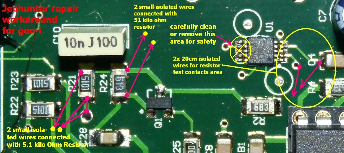

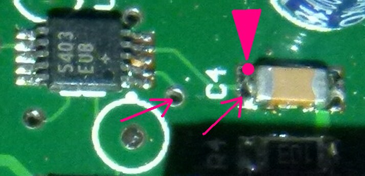

      • Workaround update and precautions!
        Hi geo-i
        thx for your kind words and that you you're so tough in
        such a frustrating situation. Also my respect that you
        wanna try to repair it and I have a good feeling that
        you could make the Jeohunter work again.
        And Thank you bro for the new very good makro pictures!
        Before you start some additional precautions:
        - if you think the soldering pins are to tiny
        for you better find some with good soldering skills!
        (or buy a soldering iron with a very small tip)
        But if you work cautious by the method I have
        described (soldering tin only at the wire-contacts,
        holding wire onto the marked point and heat wire with
        soldering iron until metal melts and creates connection)
        you should have no problems.
        - be very careful at the C4 spot (see picture - dot of the "!")
        here you must try to solder as short as possible
        because otherwise to much heat will destroy the C4
        (this is a very small capacitor, surface mount device and
        we don't have the value, so we can't replace it)
        But the marked spot for soldering at the left side of C4
        is pretty "large" so you should make it.
        Just try to solder as short as possible at this location!

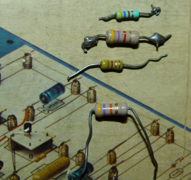

        - you can find the replacement resistors in old
        electronic stuff like broken TVs, VCRs, radios etc.
        All you need is a pliers to break them carefully off
        (plug of mains and be careful if you disassemble TVs,
        those can contain loaded high voltage capacitors...)
        The color codes of the needed resistors are:
        51k resistor: green-brown-orange-gold (or silver)
        (or gold-orange-brown-green if you hold it reversed)
        5.1k resistor: green-brown-red-gold (or silver instead of gold)
        (or gold-red-brown-green if you hold it reversed)
        If you don't find them you could try to use a resistor
        that is very close to the given values:
        for the 51k R. from 45k to 55k)
        for the 5.1k R. from 4.5k to 5.5k)
        pleas google for resistor color codes and how to use them.
        - try to clean or carefully remove the burned area
        of U1 to avoid shortcuts form there
        but I hope it will work without it, because
        if the IC is burned there is no more dangerous
        connection inside of this digital potentiometer
        (a potentiometer is just a variable resistor)
        ! geo-i, perhaps you can call yourself really lucky
        that only replacable parts got burned!
        Let's hope nothing else has been damaged!
        If nothing else was destroyed the chances are
        really good that our workaround will work!
        But this time you really have to do it PERFECT !!!
        Good luck and take good care!

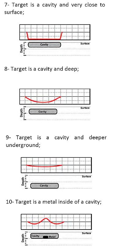

                  • @ syed ayub basha
                    > Sir you modifies all this for what purpose, tell me.
                    Improvements and technical development!
                    As example your Jeohunter 3D now has
                    "reset button mod" as a standard feature.
                    If you have more experience, it is very easy
                    to check with it even at high sensitivity if its a
                    real hit or the cause of ground mineralization etc.
                    btw. at some big US MD-shop (shipping worldwide)
                    I found the attached below info about cavity-detection:

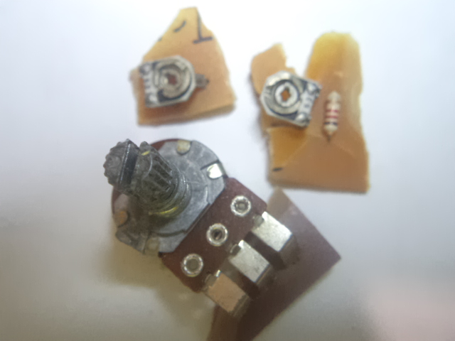

                    • Hi geo-i,
                      it is very good that you're looking for the parts now.
                      You can use 47kOhm and 4.7kOhm resistors instead
                      of the 51k / 5,1k and you can see them on the picture.
                      But if you find those 51k and 5.1k resistors it's also OK.

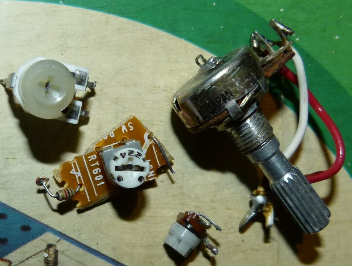

                      You cannot replace the digital potentiometer on your own
                      but you may find analog resistors / potis (also see below).
                      Sometimes those are used to turn the radio's volume up
                      and if everything works you could attach one of those big
                      potis to the Jeohunter box and adjust it from the outside.
                      btw. forget about "only 50k-100k variable resistors" -
                      simply look what you can get and if needed you can
                      solder another resistor in series to the variable one.
                      Good luck @ the electronical parts treasure hunt.
                      • reset button & cavity info
                        @ syed ayub basha
                        This is from the Jeohunter instructions manual
                        you can download from the above page as pdf.

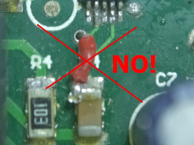

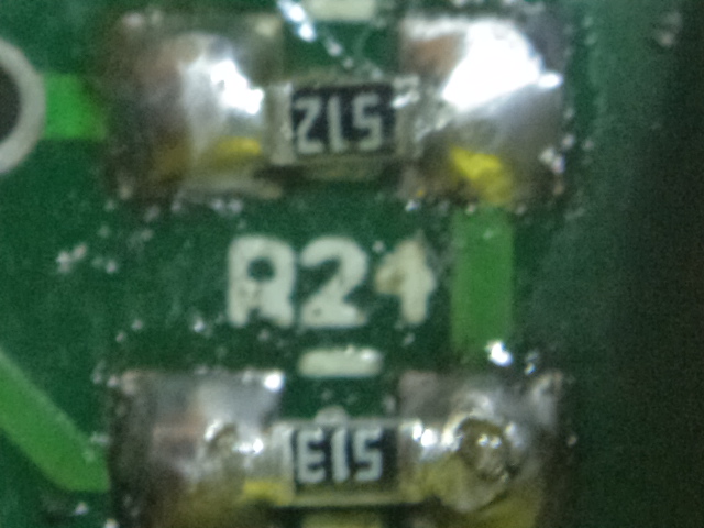

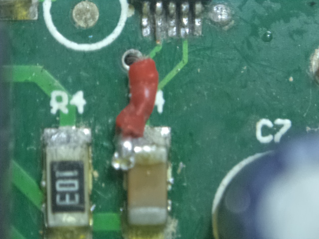

                        • replacement of resistors
                          hello friend fun finder how are you bro.
                          I did replace the 2 mount resistors from the broken radio
                          and I also have and analog resistors should I remove it half
                          of the U1 at the left side or remove it all .
                          let make it clear to me ,regarding the 2 resistors I replace it
                          new one should I solder back with the 51k that you mention
                          and please show me how to install the analog resistors so I
                          can straight forwad installed. thanks
                          geo-i

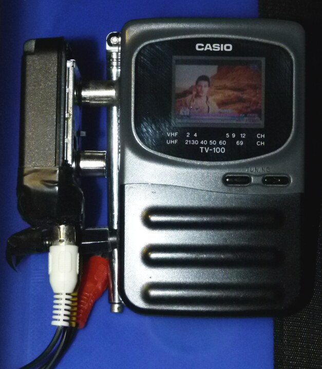

                          • Hi geo-i,
                            thanx for asking, I'm fine, successfully finished the little
                            LCD-TV project - now I can watch composite in (SCART)
                            and the needed power directly comes from the batteries.
                            accu-light longtime test is done, too:
                            the lamp shines continuously (is this greek language? )
                            for over 250 hours !!!!
                            It would work even longer but after 250h the li-ion accus
                            are down at 3V and for safety it's better to keep this limit.
                            I hope you also have a good time, geo-i!
                            Congratulation, you soldered very well the SMD resistors.
                            > should I solder back with the 51k that you mention?
                            No, your already soldered mini-resistors are fine,
                            as long as they haven't been damaged.

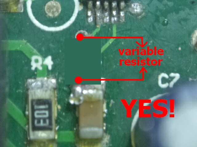

                            But what have you done at C4 - this is a possible shortcut!
                            Why you do such things if the advice tells it clearly different?
                            Perhaps such contact is OK after many tests, if it's shure this
                            connection is capable for full power, but absolutly not yet.
                            btw. always be careful creating no electrostatic charges
                            while working at the mainboard - it contains sensitive
                            computer etc. parts!
                            And have you checked the vertical circuit board
                            that everything's OK there?
                            Your accu-pack really has the correct voltage and polarity?
                            If yes and after you have soldered the 20cm long and
                            of course isolated wires at the described position you
                            can reassemble the Jeohunter but you can leave the
                            box still open.
                            Don't remove the U1!
                            Attach all the cables as shown in the diagram some posts
                            earlier. Don't confuse them and plug them with correct
                            polarity (check the color dots at the diagram!)
                            If everything is done we have to identify the value
                            of the variable resistors AND/OR you need to solder
                            some 500 Ohm resistor in line for safety.
                            And check out which contacts of the variable resistors
                            are the variable ones. If there are three contacts mostly
                            this is one outside and the one in the middle.
                            Good luck but don't try any new "experiments"!
