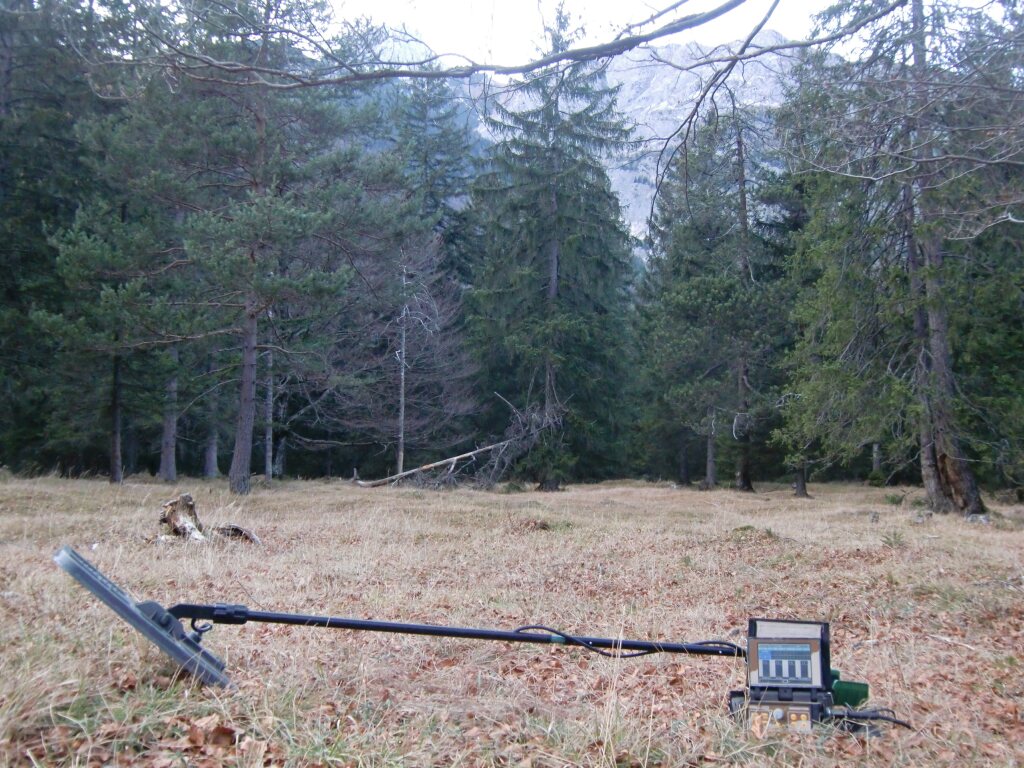

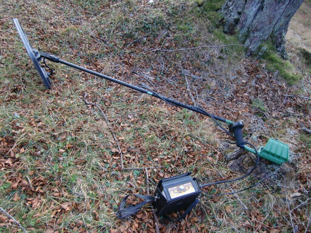

                    Todays Testresults:

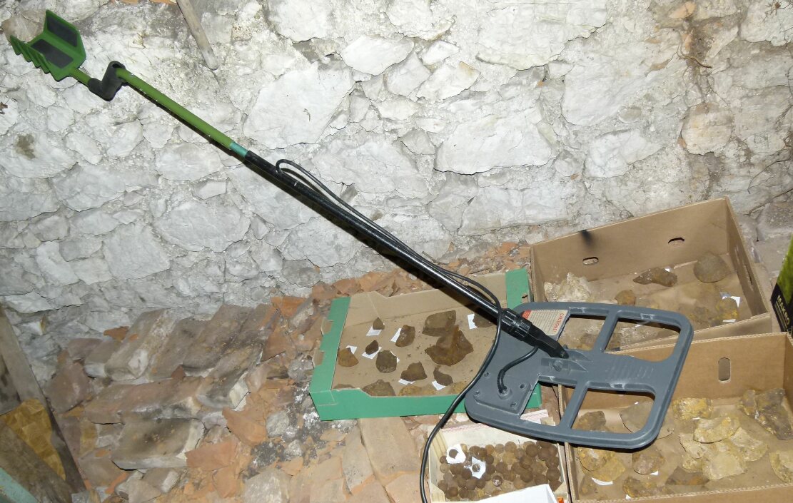

                    In the morning I finished the new coil holder. It weights a half kg less than the original one and the lenght is up to 2meters (before it had around 1,3m max.)
                    I created the handle in the most comfortable way. See picture. The flat surface above the fist has soft foam-gum so the fingers have much less work. Alot more detectors - espec. heavy ones - really should have the same!
                    The Reset button is hidden and pushable without almost any finger movement!
                    In the afternoon the real test started. Never searched on Dec. 1st - but it paid off.
                    I've had 3 different long alu-tubes with me and with the smallest it's around the formerly lenght - but of course I used the longest!
                    Shure, the weight is not easy if the coil is 2m in front of you, but while turing in circles it doesn't matter at all. I have to compute how many square meters I can cover, now within 1 turn that lasts just around 2-3 secs! btw. this would be impossible with a PI and it's slow recovery speed!

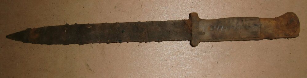

                    I found a WW2 bayonet and alot other things - never found so much stuff just within 3 hours!
                    The original coil cable is at it's limit but everything worked very well. The ground is high mineralized there but searching at 80% while pressing now and then the reset button was no problem.
                    With my special search method I can make around 10 squaremeters in just a few sec. and this would never be possible with a small 25cm coil while sweeping slowly from left to right. It's a huge waste of movement-energy, too.
