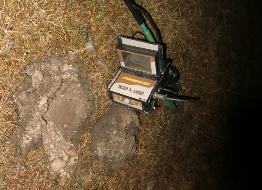

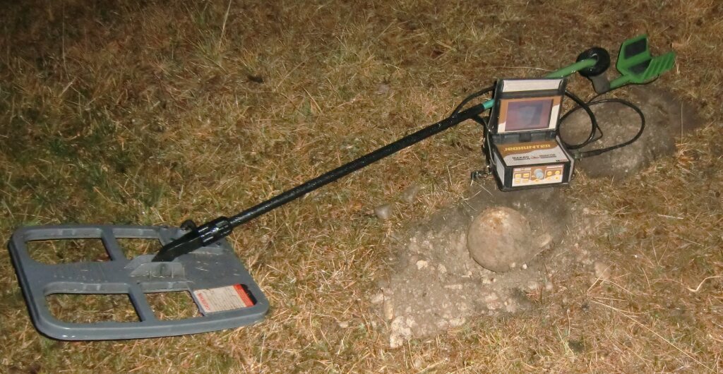

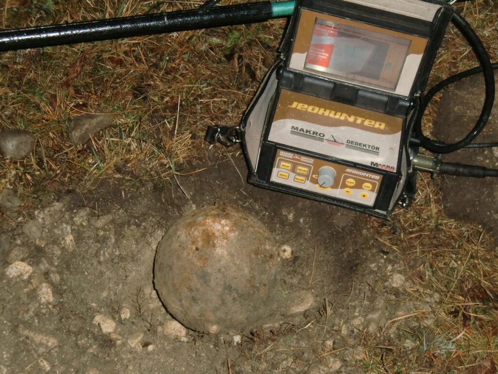

            • Absolute Lucky Strike !!!
              The Jeohunter really rocks!
              Because it finds everything! A little 2cm small musket 12cm deep (in the afternoon) and an ultra rare 17cm special cannonball just 8cm below (in the evening). This is reality, it happened today!
              At 80% sensitivity on high mineralized ground with alot of small hills, trees, roots and wet grass, not to forget 380kv lines nearby.
              Search radius around 1.70m with medium alu-tube.
              Because one of the most important things treasure-hunters forget is that this world is huge and the search coils most of the time are much too small and short! Those can find coins or gold-nuggets at a small area per day but even this could take ages.
              Thats's why the Jeohunter is such a fantastic solution:
              I finds small stuff and larger very deep stuff and cavity and has a huge coil that covers alot ground!
              Any searchcoil has to be very close or above the find - that's the most important thing. Shure, todays finds I would have found even with the cheapest MDs - buuuttttt: Such cheap detectors most of the time have very small coils and not much depth or search range outside the coil-diameter and covering huge sites with such detectors would take 10x longer at minimum. And with large PI frames you will miss small finds for shure and most of the time there isn't alot big and deep stuff out there.
              Anyway:
              This find is really fantastic now! And it's absolute authentic, believe me. The last time when I found a special cannonball I did not say that I found it with the Jeohunter because this would have been a lie and unfair. It's just not my style because it wouldn't be objective and I don't need cheap tricks, it would be below my honor. And btw. I have nothing to lose with the Jeohunter anyway. If persons are interested and clever enough they can understand or find out the truth by themself and otherwise it's their business and I don't care.
              However this todays find is another proof that you will! have good success with the Jeohunter!
              The new reset-button works great - even with gloves, and those coil-holder modification after just 3 days has shown it's great value!
              Because you really have to cover alot ground to find something! Everything else is unrealistic or childsplay! Today I'd run a search-circle of around 400 meters in diameter - within ca. 5 hours. Of course this circle has had more the shape of a potatoe with alot of zig-zags but luckily finally it did lead me to that lucky spot.

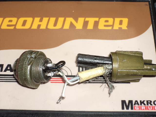

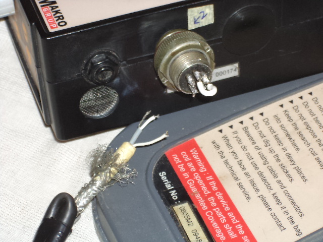

                    • hello my fun finder my bad luck today i had a problem with the joehunter my cable cut off at the main plug during work i tried to install the improvement it does not work correctly .does anyone can help how to connect correctly .see picture
                      • Originally posted by geo-i View Post
                        What picture?

                          @ geo-i
                          I'm sorry you had bad luck with the cable. What mod did you made? Please tell us exactly where the cable was cut off and attach picture here so I have the needed informations for helping you.

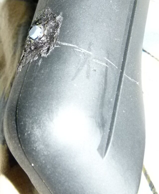

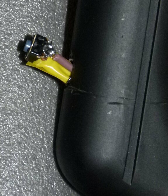

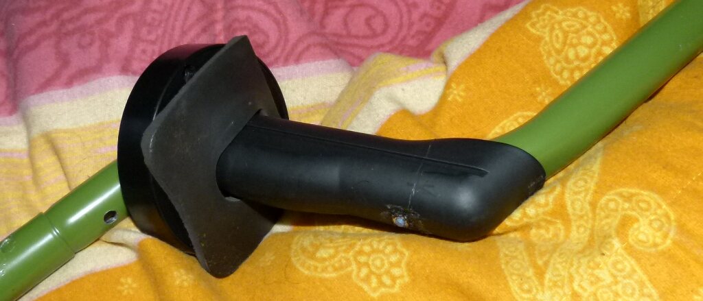

                          Below you can see my new tricky resetbutton:
                          It's pushable by the little fingers (both hands) because the whole weight is concentrated at the upper region of the handle inclusive the stronger fingers there for holding. This way the coil can be still moved perfect controlable without losing power. btw. the orig. Jeohunter holder is shaped for right hand use which makes the search by the left hand a little bit uncomfortable. The best solution however is a handle with a very soft foamgum above the holding hands fist so around 75% of the holding-weight goes there and not into the fingers. I used the holder of the Garrett GTI 1500 for this mod which has a hard plastic part there which was very good to drill and melt the reset-button into it. Afterwards it was covered by the soft foamgum of the Fisher 1266-X.

                            hello friend my problem now is cable disconnected form the main plug i dont know the location of the main soket wayer please an indication of the orginal position (picture) wayer need to be connect

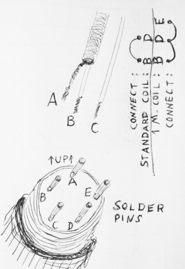

                              Thx for the info and pix, geo-i - here a little help, my friend.
                              Below are my connections for the soldering pins which
                              can be seen on your picture and should also work for you.
                              important:
                              Make shure that your coil-cable has been put already
                              correct through the pole and stuff how you liked it and also
                              drag the gum-parts and second part of the metal connector
                              over the cable before starting soldering.
                              next:
                              Bridge pin B and pin D with a small cable so the
                              Jeohunter recognises the coil as the standard coil.
                              (the small coil needs no bridging and the 1m coil
                              gets recognised if B-D-E is connected - see graphic)
                              Solder the shielding of the grey cable to pin A
                              and the white wire of the grey cable to pin B.
                              Solder the single white wire to pin C (see below).
                              The large shielding is not connected.
                              finally:
                              Connect the plug with the Jeohunter and start
                              to make a short test if the coil works fine again,
                              isolate the cables well and close the connector-plug.
                              Depending how good are your skills in soldering you
                              could use the chance of this broken cable to create a
                              little bit longer cable now for the Jeohunter but only
                              if you want to get more than 2 meters coil-distance.
                              Good luck! , geo-i , and tell us your results and other infos.
