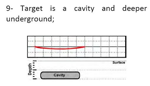

    the 'effect parameters' are special values to calculate
    depth, the type of metal and / or if it's cavity.
    - magnetical: iron, not iron (perhaps also paramagnetic, diamagnetic)
    - frequency: eddy currents or frequency shift
    - mineral: ground elimination and cavity detecton
    - electric: conductivity
    - mix & carbon effect: i guess this is an industrial secret
    For you very important is the below cavity screen!
    What you have to look for is a very weak cavity
    signal but this signal must have some
    lenght and a geometrical shape.
    And please first read the attached manual. Good Luck!

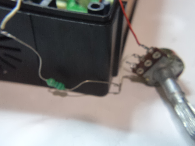

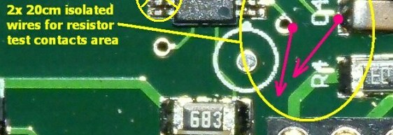

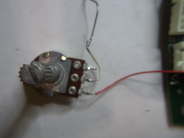

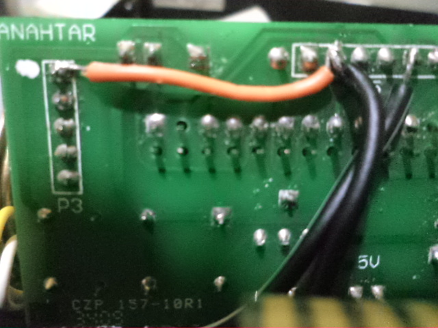

      The vertical board is the PCB shown on the picture below.
      Just take a closer look so we know nothing was burned.

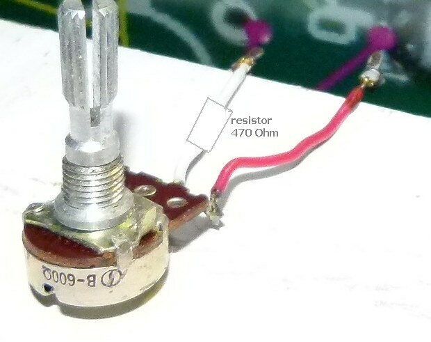

      And you can see the variable resistor connection in "real".
      But you need 20cm wires and solder a 470 Ohm
      resistor in line, between the cable and the resistor:
      This is a simple sketch of the correct connection:
      -------470 Ohm resistor------18cm isolated wire------> jeohunter board
      | variable resistor |
      --------------------------------20cm isolated wire------> jeohunter board
      After this attach everything the right way and carefully.
      Next we are ready for the tests. Good luck.

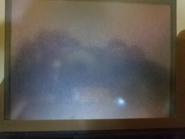

          • result test 470ohm resistors
            hello my friend fufinder I have already finish the
            470ohm resistors bro but nothing happen just only
            repetitive click sound and white blink sound , bro
            am I doing the the right thing because all the connection
            you give is good is 51ohm resistors and 5.0hm resistors
            should be change as well because I already change it
            what is your opinion ? friend thanks.
            geo-i
            • 470ohm resistor
              470ohm test resistor & white screen
              • Hi geo-i
                sorry to hear about the problems.
                Have you tested before the variable resistor really works?
                Do you can get any difference while turning the variable resistor?
                OK, you may change the outside 470 Ohm by 220 (red-red-brown-gold)
                Or do you already changed it to 5 and 50 Ohm without success?
                The white screen is the background-light without any picture.
                But this is a good sign that at least the screen now is stable.
                And the power providing / dividing circuit is working.
                Do you get the melody while turing the Jeohunter to ON?
                Do you have connected the coil cable?!!! You must connect it.
                Can you get some beeps after you are pressing the reset or accept button?

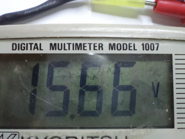

                Do you know what was the accu-pack mistake?
                either it was wrong polarity or it was double voltage (29,6 V).

                If you have pictures of the 2 isolated 20cm wires
                you can show them (from the soldering area).

                  resistor get from the shop, the polarity of the double volt is 15.66v
                  before charges .ok my friend i hope you guide me and help thanks.

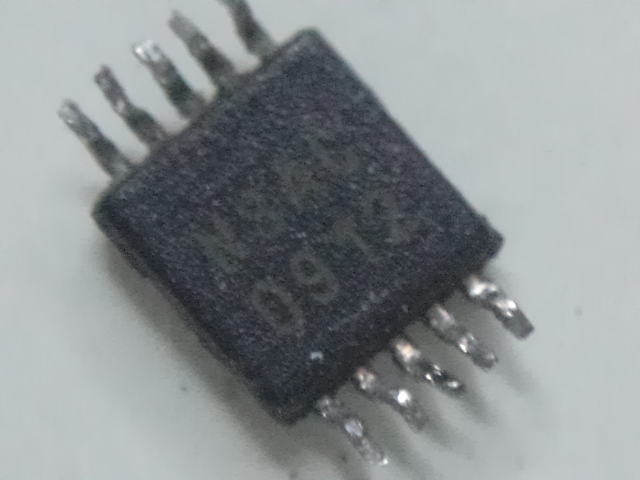

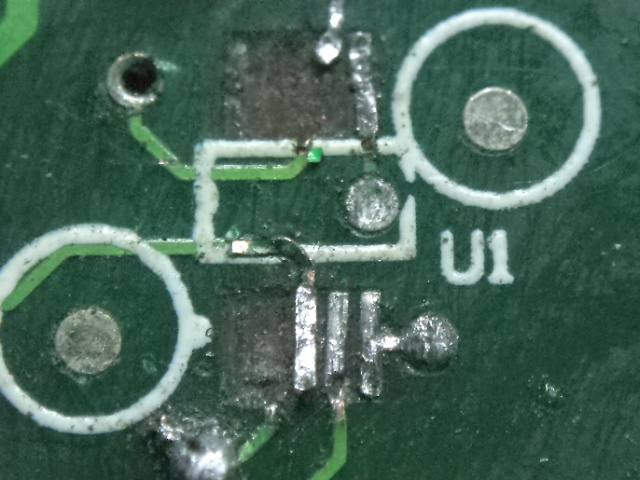

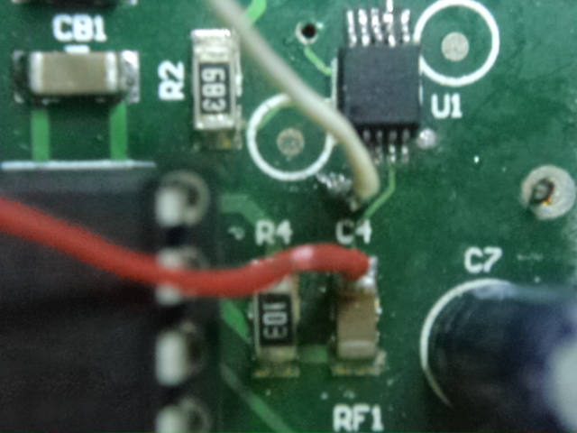

                    At your picture:
                    Is this a new digital potentiometer chip or is it the
                    old one cleaned?
                    If it's the burned one now you can carefully remove it
                    and test again.
                    Perhaps this chip causes some shortcut and if removed
                    this problem would be solved.
                    If we are lucky this is the last simple repair chance.
                    Please try this first, remove carefully this chip but
                    don't rip off the isolated wires while doing this.
                    After this the same test series:
                    potentiometer with 470 Ohm resistor in line
                    if this doesn't work with 220 Ohm and at least
                    without additional resistor.
                    Don't give up hope, it could work or it could not.

                      • potentiometer chip
                        hello friend sorry about the questions digital
                        potentiometer chip the chip is old one
                        cleaned bro.
                        geo-i
                        • result potentiometer digital chip
                          hello my friend funfinder I have got an answer about the digital
                          potentiometer digital chip auctual when I remove my digital chip
                          I saw the circuit board is broken and saw no burns is happen
                          at the digital chip do you have any opinion bro, how to save
                          the circuit board thanks .
                          geo-i
