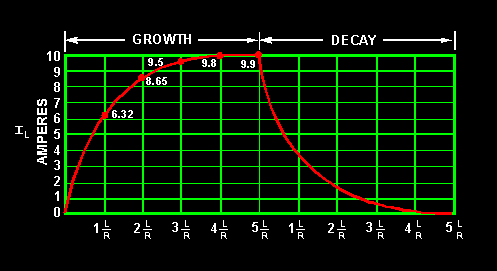

    To tame the smoke I've got to tame the pulse window to 3rd multiple of L/R so as not to avalance the FETs and detonate the Caps ... effectively to tame the flyback tidal energy which comes rushing in ... and then to break the waves by raising the barrier synchronously in a interfering manner such that wave's energy unpacks or demodulates itself in a smooth fashion ... oh no this is not a poem....

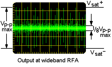

          There is another advantage: it greatly simplifies power supply design. So is it really an incompetent design, or just another way to do things that works perfectly fine in some applications? Can you name a popular commercial detector that has this kind of search coil?
          Carl, many times I use the term "incompetent design" in this forum, which means that the project does not achieve the purpose of my hobby - the highest possible sensitivity of RX and efficiency of TX. If a ham radio designer would design a metal detector, it will seek to achieve this by making at least five things:
          1. To maximize the modulation index of TGT signal so that it almost looks like a SSB modulation. This is achieved through suppression of AIR & GND signal in RX input. The easiest method to achieve this is to use induction balanced search head. I showed in the forum that IB is best suited for all types of metal detectors. If I see a project, even if it is BFO, which is not used IB search head, I call it incompetent design because I can easily improve it and get a much better sensitivity with induction balanced coil.
          I can not call Howard Rockey (Bugwhiskers) incompetent designer. I like the project QED, but I think it is an incompetent design to the point where someone thought to involve induction balanced search head instead the monocoil.
          2. Maximize SNR (Signal to Noise Ratio). At metal detectors, the SNR is not determined by thermal noise and interferences because the synchronous demodulator suppresses them. Furthermore, the noise and interferences are significantly weaker than the parasitic modulation of AIR & GND signal, which is obtained due to the movement of the TX coil relative to ground. If I saw a circuit diagram of TX for CW metal detector, which has no P-I-D controller to suppress parasitic amplitude modulation, for me it is an incompetent design. Minelab and Garrett are using a P-I controller, which gives good results.
          Now I remembered a design of Eric Foster. He puts a big TX loop on the ground and seeks with RX coil inside. So there is no modulation induced by the movement of TX coil.
          3. Maximal efficiency of TX circuit. This is the main goal of the designers with my hobby, though our TX only occasionally is powered by the car battery. However, metal detectors are powered only by battery. Because energy wastage in the conventional PI detector, The designers with my hobby call it "incompetent designed wideband metal detector". The analysis with Frequency domain shows what wavwform of TX current is most effective for wideband metal detector.
          4. AGC of RX preamp. In an incompetent design, the operator should manually adjust maximal possible amplification at actual ground conditions.
          5. Carrier recovery for phase reference. The RX should operate as wireless device. A narrow band RX for metal detector is incompetent designed when uses a wire connected to TX to obtain phase reference. That needs impossible phase stability for correct discrimination.
          • #50
            Mike, I mostly concur with your conclusions for most things, yet here I think your radio bias got better of you at points 2, 4 and 5.
            2. Invariance of S/N is an illusion due to the sub optimal Rx coil design of most detectors. Physical reality is that Cu wire has only a limited conductivity, and given the opportunity to operate in a non-resonant mode with impedance matching preamp input noise would prove you that there is a thermal noise, and that a synchronous demodulator has very little influence on it. Semi-resonant configurations certainly may qualify as incompetent designs as they screw phase response.
            BTW, AM at Tx is a bit less of a problem compared to the variation of harmonic content. You are not wrong, but the culprit you are pointing at is a bit different.
            4. AGC is very useful for maintaining modulation properties of a received signal, except for FM where limiters are used to remove the AM component from the signal. Surprisingly metal detectors have only a little use for amplitude, hence a soft limiter is the best option. Not AGC. Designs lacking a soft limiter or compression of any kind are certainly incompetent designs.
            5. Independent Rx design would require some sort of Costas loop, but even then such a system would not be much different from a current solution with phases referenced to Tx. Furthermore, if we decide to employ some sort of frequency hopping (which is an intentional exaggeration) a system coupled to a Tx would be much better off due to the problems of loop filters' lag. That's why I consider incompetent all the designs that employ PLLs for phase shifting.
