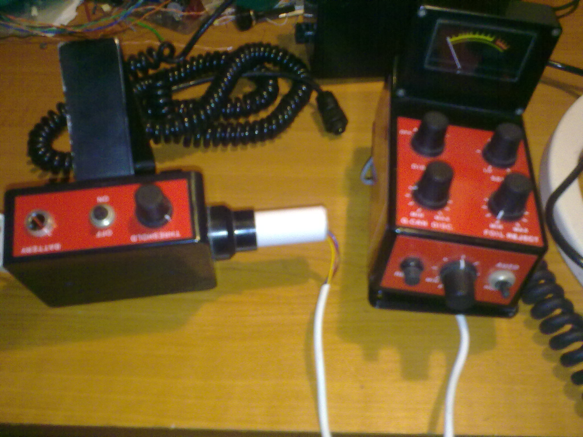

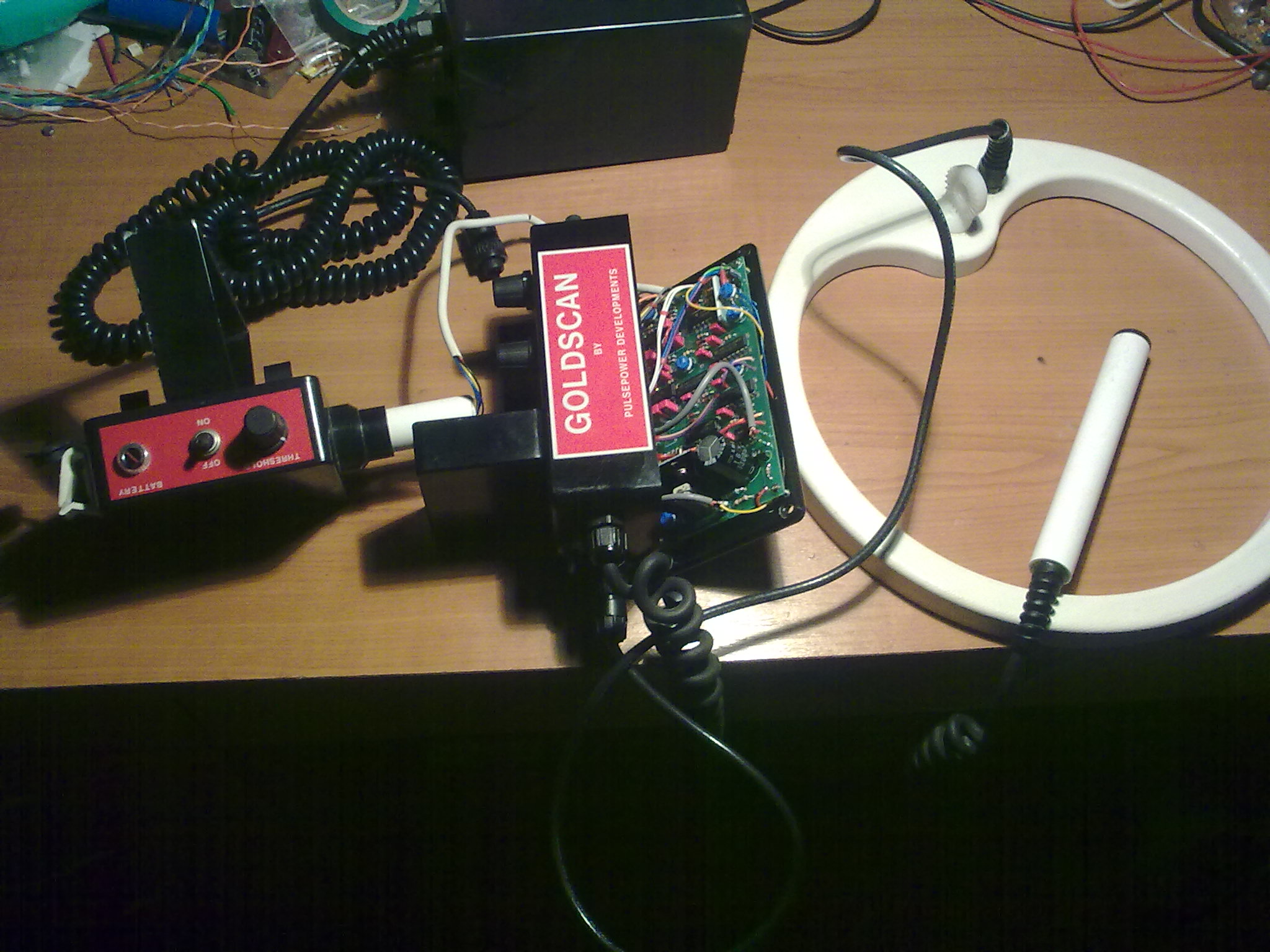

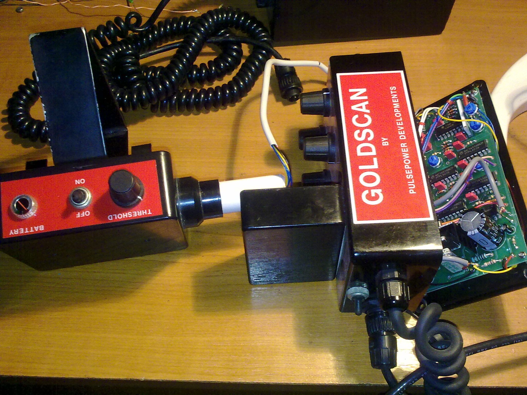

                              D15 and D14 are not oa 85 they were originally 1n4148 signal is positive polarity.
                                Hi Orbit!
                                Can you make more pic's on Goldscan pcb?
                                10x!
