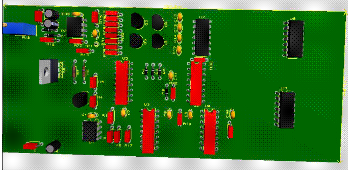

          Goldscan 4
          these pictures are original ???
          If your construction
          is not the same schema and pcb!!!!!
          • #50
            Original 100% Goldscan Gs4 made from Eric Foster......you can see how is populated and cables distribution......good design for the circuit especially for the front end!!!
            • #51
              I started to draw the pcb
              could you help in unseen places
