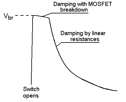

        Jon, the MOSFET operates also as damping element because at breakdown it dissipates energy.
        See also

            About the mosfet limiting the coil surge voltage, I was aware of that when I chose a mosfet's with a breakdown voltage of over 600, I understand that the higher that surge voltage can get the faster it will end, is there any real disadvantage to letting the voltage peak so high besides dealing with it on the rx? Dose it reverse the field in targets making them harder to see or something weird like that?

              There are several other parameters that come into play, in addition to what mikebg already mentioned about the breakdown voltage. The RDS(on) affects the TC of the circuit and the current flowing through the coil at switch-off. The total current flow possible will be calculated from the series resistance of the circuit, which includes the RDS(on) of the device. The current flowing at switch-off will be calculated by the total current flow possible, the TC of the circuit, and the pulse width (where are we at on the TC curve?). The Coss affects the total capacitance of the circuit, and will change the value of damping resistor required to achieve critical damping. Adding a diode in series between the MOSFET and the coil will greatly reduce the capacitance contributed to the circuit by the MOSFET. There are other things to consider as well, such as the speed at which the MOSFET can be switched off td(off) and tf, which is also affected by your MOSFET gate driver circuit and the Ciss of the device.

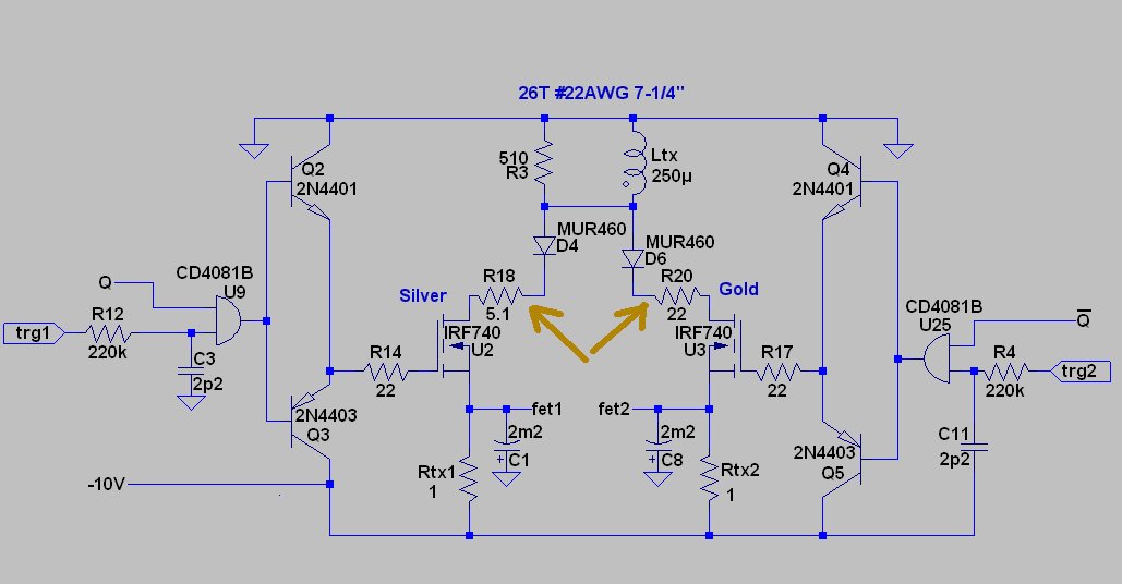

                Adding diode between MOSFET and coil is not a good idea at all. Trust me, i tried this many times, and in many different configurations. During the flyback period, diode will be forward biased most of the time when MOSFET breakdown voltage is reached, and will not "isolate "it, neither increase breakdown voltage. Finally, when it cuts off, at the end of cycle, what is remaining in the circuit then will be inadequately damped whit existing value of R dump. And as a result, this will ALWAYS be slower compared to MOSFET alone. Measured dozen times.

                  -Is that what happens exactly when you install the diode between the coil and mosfet.
                  However, this modification allows to increase the value of damping resistance.
                  The end result is less time delay.
                    That's correct. The diode has no impact while the MOSFET breakdown voltage is exceeded. The diode's impact happens when the coil voltage drops below the MOSFET breakdown voltage and becomes reverse-biased.
                    As Jose mentioned, you must change your damping resistor value to compensate for the overall lower capacitance in the circuit, otherwise, you're over damping the circuit, causing the voltage across the coil to dissipate much more slowly than it can, due to the excess current flow. You need to adjust the resistor value higher until you achieve critical damping. Additionally, when adding a diode to an existing circuit, you may want to change the pulse width to a longer value to compensate for the loss of current through the coil, due to the diode's forward voltage drop when the MOSFET is on. It's not a bad idea to also add a high-value resistor from the MOSFET-diode junction to ground to bleed off the excess voltage prior to the next pulse being generated.

                      Ideal ringdown condition is pure LRC circuit, adding any nonlinearity to it (breakdown condition) will make it just slower. Adding even more nonlinearity, in form of diode or active dumping will just make things even worst. (I know US patent is given for this, John Hopkins university and active dumping, but will we ever see it in any MD, without being more complex than MD itself, and will it work?)

                        Well, I'm already using a series diode in a Surf PI Pro as one of my mods. I can sample down around 10uS, as opposed to 15uS stock. I'm not where I can verify the components right now, but I believe the diode I used was a 1N4937, and I believe my damping resistor is somewhere around 470 ohms. I'll have to double check these values later, as this is all from memory at the moment.
                          I won't enter the fray about a series diode. It seems apparent that there are pros and cons either way. I have a design in the works that generates an interleaved waveform (such as 1:3, 1:4, 1:5, etc.). Two FETs are used, with one FET transmitting the single pulse and the other FET transmitting the multipulses. With two series diodes and two different values of series resistances I can have two different levels of coil current from a single coil. The diodes serve the purpose of isolating the two series resistance from the coil when their associated FET is not active, but that is not exactly related to your previous discussion about series diodes. My point is, limiting coil current with series resistance can enhance flyback speed. (See where I mention the CS6-PI below.)

                          One other thing he did (in his CS6-PI, notably) is use a series resistance (but no series diode) between the tx FET and the coil. That series resistance limits the value of peak current that the coil will charge to. That probably reduces overall depth of detection, but it also enhances flyback speed. He also used appropriately short TX pulses so as to not waste battery power. He did NOT use large gauge wire. That is another trap... and I know about traps. (Save the large gauge wire for monster size coils??)
