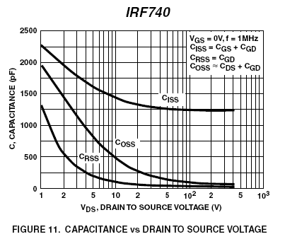

            Hi all,
            if you use a drain diode to block the mosfets capacitance, you must not use a drain bleed-off resistor! The voltage at drain should stay as high as possible to lower the mosfets capacitance. Look into the data sheet "capacitance vs. drain to source voltage".
            Look, how the capacitances fall into a lower level.
            So there is no need for the drain bleed-off resistor.

              Here is the capacitance vs Vds (IRF740):

                      The reverse-biased diode will have a capacitance that is so much lower than the MOSFET that when you calculate the series capacitance of the diode and MOSFET, the capacitance of the MOSFET has little bearing on the total. The reason to use the bleed-off resistor is to get the voltage stored across the MOSFET down to a reasonable level prior to turning the MOSFET on again.
