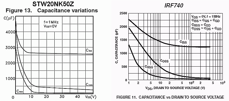

            My current favourite is the STW20NK50Z SuperMESH power MOSFET

            Most of the parameters seem pretty useful for PI use...
            Equivalent output capacitance VDS =0, VDS = 0 to 640 V - 187 pF
            RDSon 0.23 typical
            As always though, it needs a good gate driver to get the most out of it.

              Such is the case with the damping resistor. We need formula for analysis of damping resistance, not for coarse calculation and measurement of coil capacitance. The coil capacitance is only a part from equivalent capacitance of TX network. But let we start with your favorite MOFETransistor. Compare its capacitances with capacitances given in posting # 21:
                mikebg, as per the posts you refer to, the capacitance CDS for both these devices diminishes to negligable amounts so long as VDS remains high (hence the benefit of using an additional series diode such as D2 in the schematic below). The drain remains near the flyback peak voltage until the next switch cycle - so long as no bleed resistor is added! Gate capacitance is the most challenging aspect of this device, but there are some very capable drivers available for peanuts these days.
                On my test harness I swap in and out mosfets and most of the other parts shown in the schematic to make A-B comparisons and select parts accordingly. The flyback transient says it all.
                I'm not sure I understand you point about the formula's. Having made a coil, its parameters are required in order to calculate a ball-park figure for the damping resistor. To get the most out of a real front-end the value needs tweaking for sure, but with the coil in-circuit, quite an accurate measurement of its intrinsic capacitance for the (purposes of damping) can be made by resonating it with an external pulse while the diode (D2 above) is reverse biased or removed from circuit. The inductance of the coil and connecting lead doesn't change appreciably either in or out of circuit. From my experience using this technique the required critical damping resistor can be calculated pretty accurately, but I could never resist a tweak while looking at the scope!
