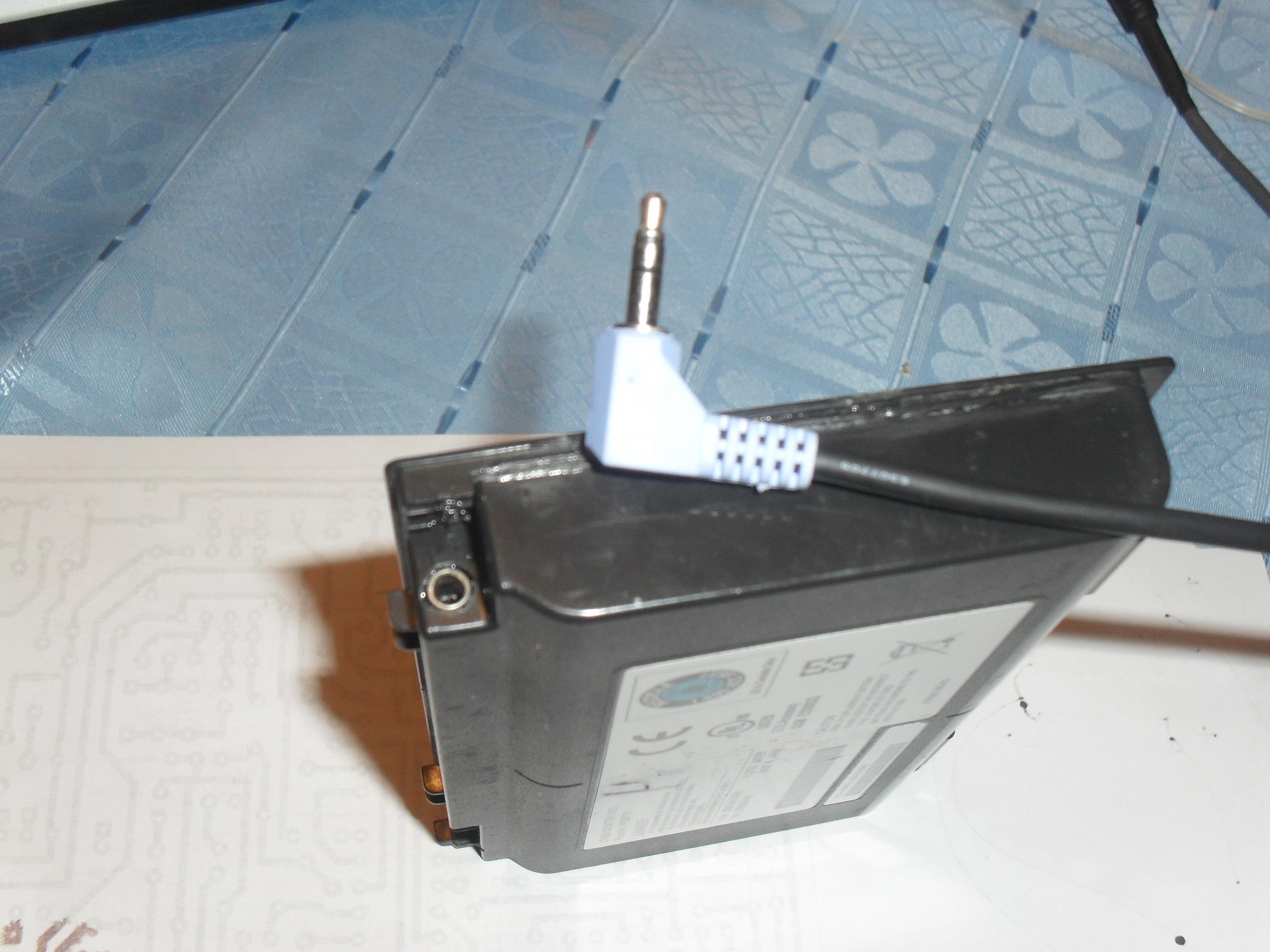

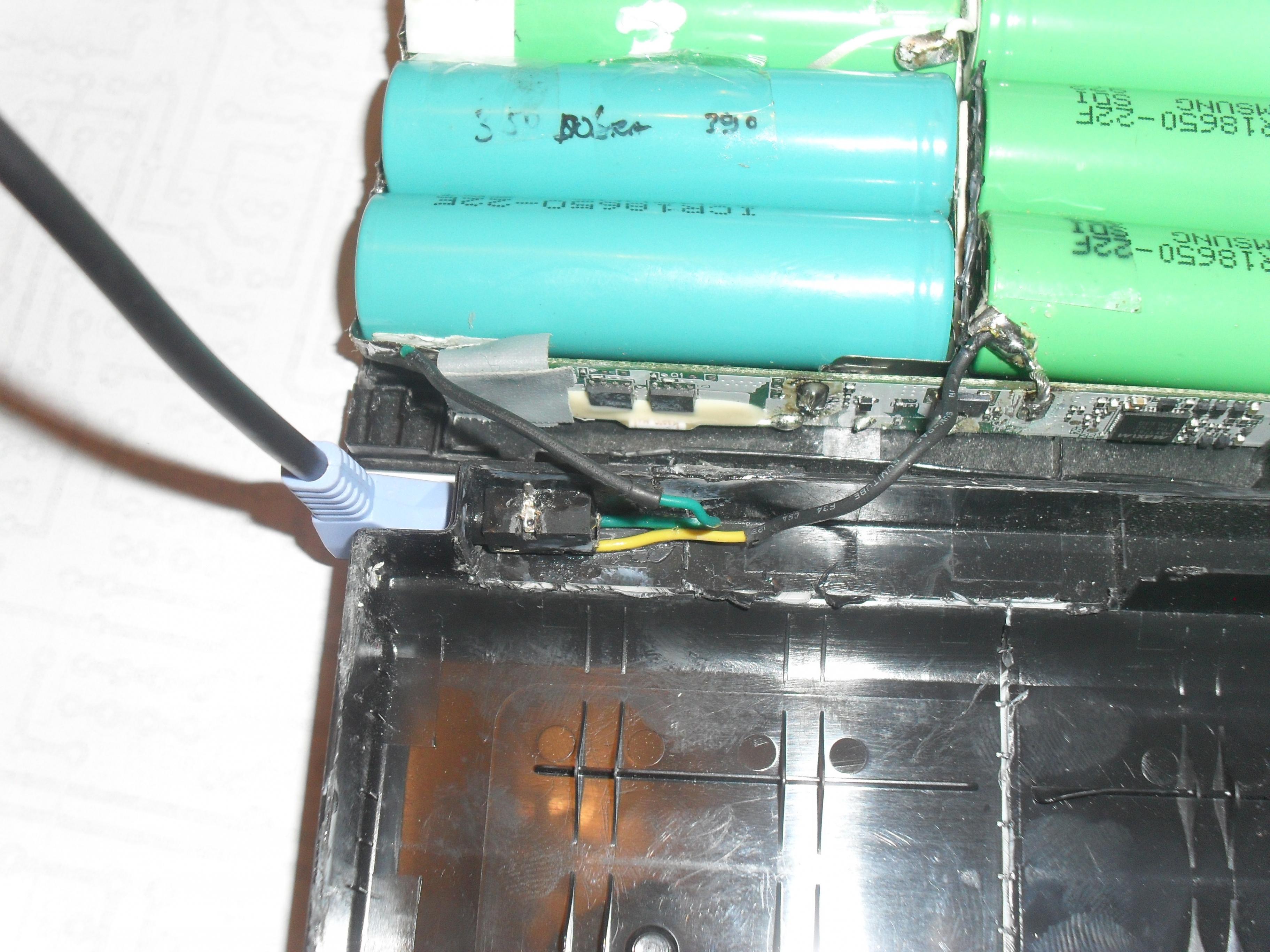

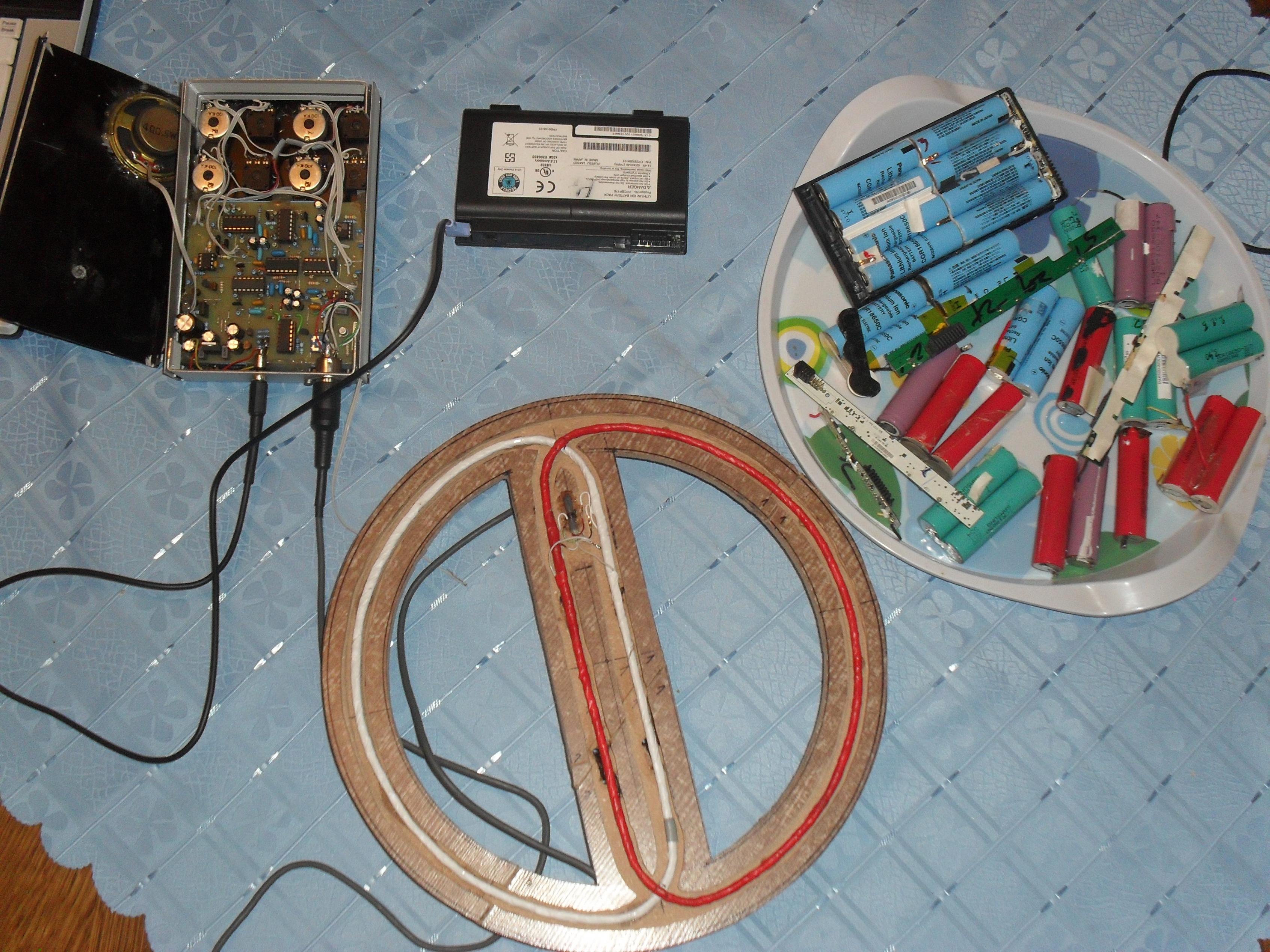

                    Thanks for your answers. I do not know whether it is in this way that you write full all 3 batteries at once the same charger or charge them one at a time?
                    I made it in the following way:
                    I opened my laptop battery, which is good and in it built 3.5 mm jack to the battery and use the laptop for IGSL. when empty and put the laptop so the battery 5200 mAh battery so that it lasts a long time but it is a fault which is great and I have to carry it in your pocket Click image for larger version
ID:	337680Click image for larger version
ID:	337681Click image for larger version
                    • You can do that. Alternatively you can charge each battery on it's own in lieu of a real balanced charger.
