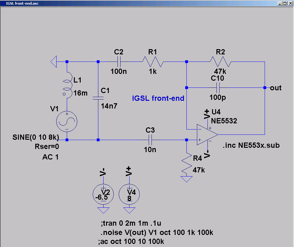

  • It actually looks as a common mode pickup of mains hum. Now, as there are a few options for connecting a coil to the preamp, and there are also a few options for coil realisation, I can only wonder what situation you have there. Whatever you have, using a device away from mains voltage, and on batteries, should eliminate this kind of hum. I can hear your device being a bit nervous, and sound seem binary. All of this will get much quieter outside.
    • You are absolutely right,
      in my home is to much interference signal. I am ready to do real tests on field, but in my area there are few interference signals - 750 kW, 639 kHz radio transmitter 8 km from my home, main train corridor, etc..
      Thank you for your help
      • Here is a kind of interim solution to a better IGSL front-end with minimum intervention to the original layout. It considers single ended coil connection to the non-inverting side of a preamp. Because all the resistors are reduced by factor of 4.7, and there is no resistor in series with the non-inverting branch, the input referenced noise drops from over 6nV/sqrt(Hz) to 3.2nV, some 6dB improvement.
        The inverting side is configured as a band pass filter, so 50Hz is attenuated for some 40dB more, which is a good thing.
        Noise figures assume an op amp with ~7nV/sqrt(Hz) input noise. It could be improved with a better op amp, and by further reducing resistors. Because input DC bias is derived through equal resistors (47k), even OP27 that is notorious for it's problem with common mode noise will perform well.

          • Assuming an op amp provides 0.002% THD (LM833) and your fundamental is at 200mV, and assuming the most distortion power is shared between 2nd and 3rd harmonics, you may expect some 1/100 000 of 3rd harmonic in output.
            Now, consider air signal of 200mV meeting a ground signal of equal amplitude, both submitted to a 1/100 000 3rd harmonic mechanism, after some tedious calculation you get ~240nV of the 3rd order product reflected back to the carrier vicinity. You want to know what it means when referenced to the input, so you need to divide these numbers with gain (47) and you obtain 5nV.
            Considering noise over a 10Hz bandwidth exceeds 5nV by a safe margin, you may consider your 200mV a tolerable figure, but only in case of LM833 or better op amp.
            NE5532 is the same topology and you can expect comparable results so it should work the same here.
            LF353 is the standard front-end of TGSL, and it has 10 times THD of LM833, hence it's sensitivity will drop at smaller values of residual "air signal" than your IGSL with LM833.
            THD is typically expressed for 1kHz, and tends to rise rapidly past 1kHz.
            And now something completely different...
            You may consider AM noise of a well built (Tx) oscillator somewhere at -140dBc/Hz at 10Hz due to components noise contribution only, so you would have plenty of headroom before you match input noise. But somehow you are barely within the limits of input noise with 200mV carrier (e.g. amplitude as seen from the preamp input). Let's see why...
            Noise performance of LC oscillators is related to the supply rail voltage purity, hence it must be superb, or otherwise...
            Let's ponder a second on it. I found that a simple 7805 regulator gives some 40uV of noise in audio band. Thus it is divided by sqrt(20000) and scaled for 7808, normalised to 200mV amplitude, reduced for gain, and we get some ~10nV/sqrt(Hz), again very close and barely exceeding input noise performance. Right here it is clear that a switching regulator would be a killjoy at this place. It is also clear that halving air signal residual would reduce AM noise injection by half.
            Filtering a power supply rail using a low noise reference, such as red LED, would improve power rail noise by factor of 10 or so. IMHO it would be a game changer in PI vs. IB depth battle.

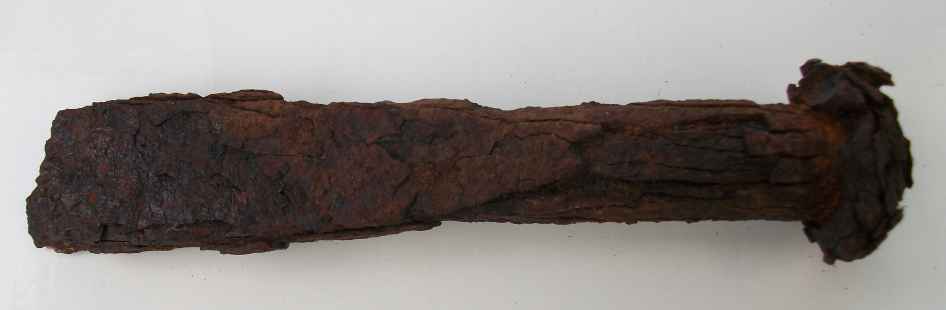

                      That could be very old indeed. It depends on the metal, the ground where it was buried (how "preserving" the ground is") and whether or not Roman ruled there at any time.......Have you any thoughts on its age?
                      I find long nails from time to time in the forest near where I live, which is very close to the "Limes" Wall in Germany, one of Emperor Hadrian's works.
                      The nails appear to be hand forged and the thought is that they were used to hold the wooden Limes wall together....I actually re-bury them now as there are SO many around where I search....
                      • Because there is some structure from ~14th century near by, I guess it must be somewhat younger than that. Other than that there is no way establishing it's age.
