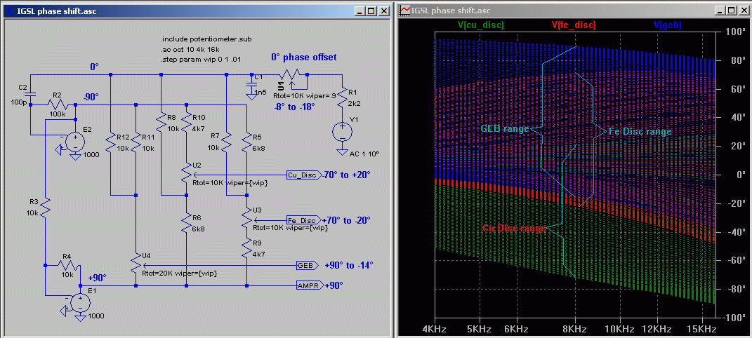

                              • And now something completely different.
                                I was playing with phase shifters in order to have all metal phase reference (AMPR) for discrimination separated from GEB, and a GEB tuning range extended over somewhat more than 90° to include sea water. Well ... I got it. So far in simulation only.
                                I realised that things become simple if Tx/Rx phase offset is compensated to 0° prior to everything else. A proper 0° is tuned by means of a ferrite and GEB turned to the far left (ferrite) position at +90°. Zero degrees is tuned by means of a phase offset trimmer, and it also serves as fine tuning when swapping different coils. After true zero is tuned all other controls work as they should.
                                Next, I already have a nice +90° shifter on IGSL board, but I don't have a -90° source, yet there is another op amp (otherwise redundant) that may serve as inverter (-1 gain) and thus providing me with perfect complementary signal source.
                                To produce any phase in between, I need only 3 sources; -90°, 0°, and +90°. A simple potentiometer will do it smoothly and continuously.
                                To have meaningful discrimination, I need some symmetrical overlapping of ranges (+ and - 20°) and not exactly full 90° range. So I decided -20° to +70° is fine (and the mirror image of it).
                                GEB must run full course from +90° (ferrite) to somewhat below 0° (sea water), and this concept provides it. Full range can be sub-divided into 2 parts to go easier on a potentiometer.
                                It can be realised in "dead bug" technology, but perhaps a small perf board would make it neater. All outputs with names go to respective comparators.
