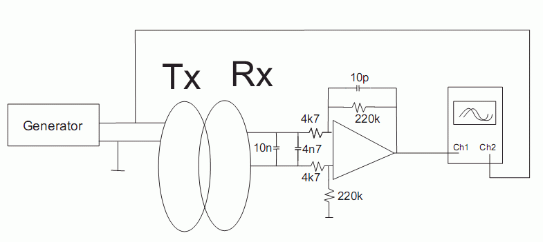

              • Hi,
                I measured my Musketeer coil with Rx preamplifier. Here are my results. I have some questions .
                What is the right Tx-Rx phase shift in the case of IGSL Musketeer coil ? Is it 20 degrees as in case of IGSL TGSL coil ? I can see, that for 20 degrees for my coil Tx frequency should be 8,8 kHz. Bigger phase shift means closer Tx Rx resonance. I can see, that phase shift 90 degrees means TX = Rx resonance . Has the bigger phase shift (closer Tx Rx resonance ) sense on sensitivity of the coil ?
                My next question is : everyone talk about milivolt coil nulling. Is this voltage measured on the output of Rx preamplifier, or is it recalculated to input of preamplifier ( Output of premplififer = preamplifier gain * input mV ) ? What is good nulling result on the preamplifier output ?
                http://www.geotech1.com/forums/showt...638#post152638 post#8
                I am asking you, because I still can not reach air detection distance +30 cm ( my max distance is still only 20cm ) for one euro
                Robert

                • nullvoltag can directly measure on rx coil
                  i think somethnik under 6mv is ok
                  at 0mV your coil is hardly undernulled

                    • Originally posted by sini View Post
                      Phase shift will be fine in 10-30° range. It also somewhat depends on the way you connect a coil to a preamp. Closer to 30° will make your discrimination ranges more meaningful because in IGSL it is also the amount of phase ranges overlap. Going too far will make your GB unreachable (it has a limited reach)
                      Closer to resonance will improve input referenced noise a little. Theoretically you could reach even below 1nV/sqrt(Hz), but at a cost of very touchy phase transition and hectic behaviour of a device. Instead you have some ~8nV/sqrt(Hz) with usual setting. Replacing 47k/220k resistors with 1k5/100k would reduce input referenced noise to ~5nV/sqrt(Hz) without too much coil loading. Connecting a coil to a non-inverting input directly (other end to signal ground), and replacing resistors in inverting branch to 470ohm/47k would reduce input referenced noise below 4nV/sqrt(Hz), which is fine because LM833 by itself has ~4.5nV/sqrt(Hz).
                      Whatever excess gain you have in the system will present itself in form of chatters, and you'll compensate it with Disc.Sens. pot. In case you don't have any chatters, you can crank up system gain and achieve more depth.
                      Your schematic of a measurement is very correct. It is also correct to measure a coil nulling directly in case you have proper oscilloscope probes. In case you are restricted to beans and bacon solution using a PC scope, a solution with observing a preamp output is more correct, as it ensures proper coil loading, and also supplies a low impedance output for PC soundcard input. It would also show signal level on preamp output, which should not exceed ~300mVpp. I'm attaching your pdf in a picture form, it is very nice.
