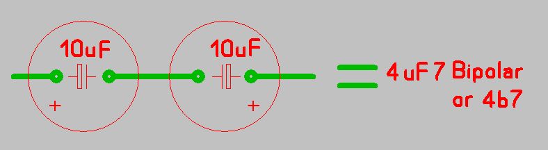

        • Parts lists for the TGSL and Musketeer Coils
          I have produced a parts list for both versions, but they need careful checking by another person before they get used. I have added some DigiKey part numbers that I took from the original TGSL Parts list, where applicable......
          I have not paid any attention to the other versions of the IGSL detecktors.....I have no schematic for them, only PCBs.....
          I also have questions:-
          1) 4.7µF Electrolytics are shown on the PCBs as being "doubled", there is no info's as to whether each "double" is half of the value needed. I have taken it as to mean that each one is 2 x 4.7µF capacitors in the parts list.
          2) C42 is marked as SPARE on both the schematic & PCB for the Musketeer version. I believe that it should be installed, and it should be a "104".
          3) There are two types of 22nF capacitor, some are marked as being 223, ceramic. The others are not detailed as being 223, but are probably Polyester or similar, that needs to be exactly determined.
          4) Some resistors were only marked with "R" and not with "Tr" as I would have expected them to be, that was R37 and R57.
          They might even be Potentiometers.
          We also need a setup procedure for all of the Trimmers.
          5) It also needs to be stated as to whether each pot is Log or Linear, I have assumed Linear.......that may be completely wrong.
          6) There is no provision for volume control as far as I can see, is there a need? Usually when on the speaker, more power is needed than when using earphones, what is a good reasonable loudspeaker volume would be far too loud for 'phones.
          If anyone can check these lists, please let me know of any errors, thanks in advance.

            1) Two 10uF connected as "+- -+" in serie are acting the same as one 4.7uF bipolar. So it should be BIPOLAR 4.7uF (AS NOTED ON SCHEMATIC: "BI-Pol").
            Using two ordinary 10uF capacitors in serie - is a sort of "heritage" from the past, from the time i did first TGS... Since than i'm rather using ordinary caps. They are much cheaper and they do the very same job there.
            2) C42 is "spare" and i already explained that. Simply FORGET IT AND OMIT IT! Just leave empty holes on pcb.

            • Hi Ivconic,
              thanks for your time and your answers, you have cleared up for me at least everything except the the following:-
              I hear you, but I could myself not understand from any of the information supplied, up till today, that I needed two 10µF capacitors in each position......sorry.....
              I fully understand capacitors in series (or parallel), but I did not know for certain what value was needed.
              I do feel that any parts list needs to have each individual capacitor with its correct value given, otherwise many of us may have bought the wrong components. I was assuming you were looking for a combined value of around 2.5µF.......thanks for clearing that up for us all.
              I will correct the parts list and post them here shortly. Does anyone want them as Excel files by the way?
              Andy
              • Hi andy,we need 4uF7 bipolar and we make it from 2x 10uF.
                Grt Nakky
