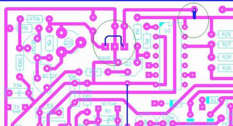

          • Aha! One more thing!
            I also made another check!
            I removed U92 (7809), C2 (220uF) and D17(01) from pcb. Made two connections as on picture bellow and made oscillator to be supplied from the main 7808.
            No difference!? Everything is working just nice! So... actually no need for my previous "over philosophy" with additional voltage regulator, cap and diode.
            So those can be freely omitted!
            Shame on me!

              Yes, I observed the same thing. Powering the oscillator from the main 7808 seems to work just fine.. At least for the "Minelab" oscillator I added to my TGSL.
                Yes that's the fact. Seems i wanted to be "smarter" than i am; adding those there....
                The fact is that i wanted to see if additional 1V supply will make any difference, but it didn't. "Useful" range of amplitude seems to be from 11 to 16Vpp at this particular design, and this can be achieved from main 7808.

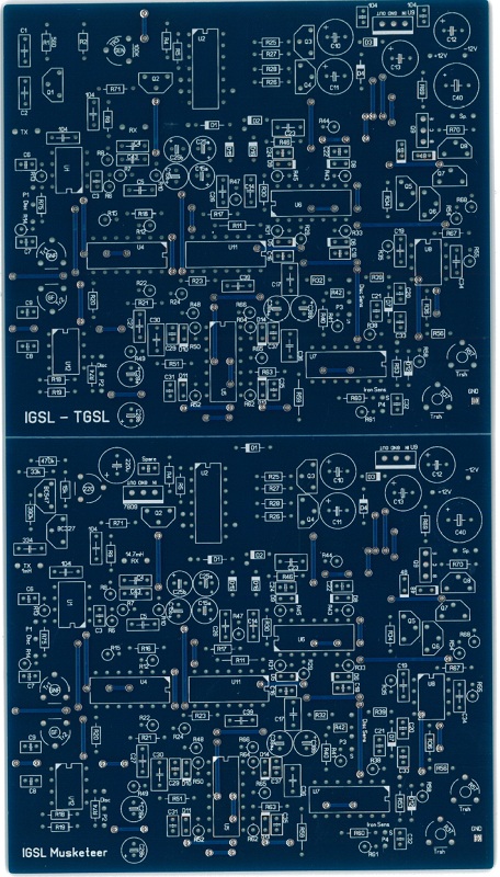

                      • IGSL Boards
                        Back from my summer holiday and IGSL boards are here
                        As previously stated they are a pair of boards with a snap off groove between
                        One board for each coil type
                        They are in my shop now
                        Kits will be added in a few days
                        thanks again to Ivconic
                        Silverdog

                          • Silverdog, I would like 2 or 3 boards of each, sent you a PM.
                            Just picked up a Musketeer coil
                            • i was a step before ordering last night
                              but i will wait for a kit (two board plate and components for at least build one of them completly)
                              it would take too long if i collect all single parts at local shops and web
                              but when the kit is in stock i take it sure and some extra pcb then you have to go to postal office only once
                              good job andy

                                Splendid pcb's ! Very nice!
