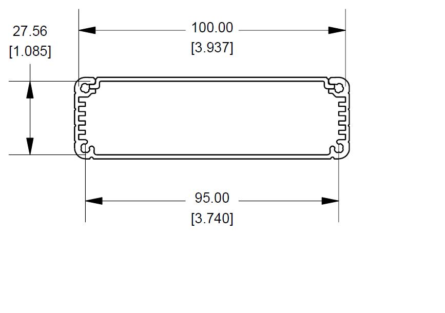

      • Hi its a real shame it wont fit the standard Eurocard housings.
        The IGSL did this too unfortunately.
        100mm is the size to aim for if there is a 3rd version looming.
        Steve
        • q
          • http://www.kelco.rs/katalog/images/1455N1202.pdf
            • my favorit
              http://www.ebay.de/itm/Euro-Gehause-...item3cbb8db491
              all plates (front, back, up and bottom) are removeable
              if anybody has problems to fit pcb in euro housing (pcb is a little bit smaller) glue a second pcb or a sheet of abs or polystyrene sheet under igsl pcb - ready

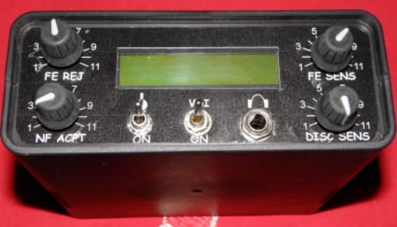

                    • Hy here are my IGSL thanks to all
                      compadre
                      • hello compadre
                        nice
                        (if you need full version of front designer, write me or search this thread- somebody has linked it)

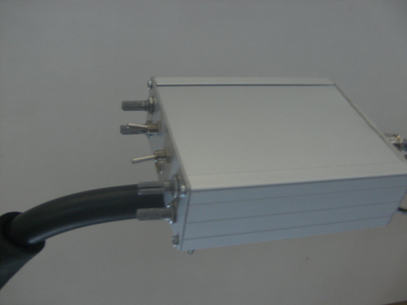

                          • here it is
                            ready for field test
                            ok ich weiß in welcher schublade bf3 liegt na mal sehen evtl ist weihnachten dieses jahr früher und mal so nebenbei hier das neue video vom igsldetails stehen in der beschreibung zum video#Ung&uum
                            regards bernd

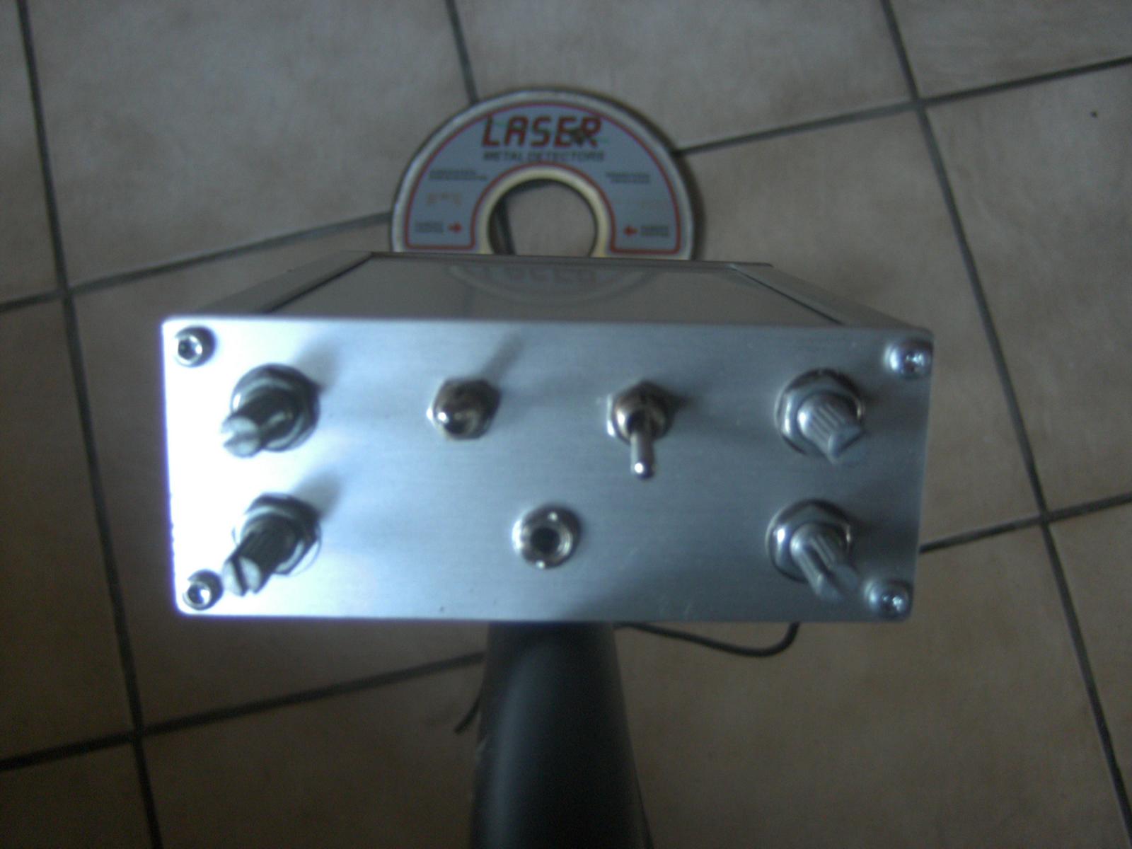

                            • My IGSL
                              Just to post a photo of my IGSL musketeer detector, it turns out to be a very flexible machine, I'm still playing with the settings but you can tune it to a double tone on a cartridge head or a bottle top while still getting a nice clear high tone on coins, Thanks Ivconic for a very good piece of work. I've equipped it with the VDI from Holyuser, seems to work very well
