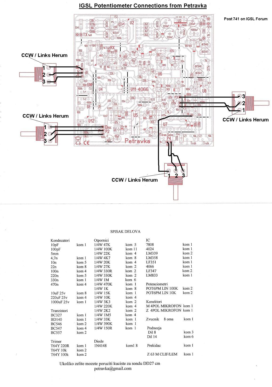

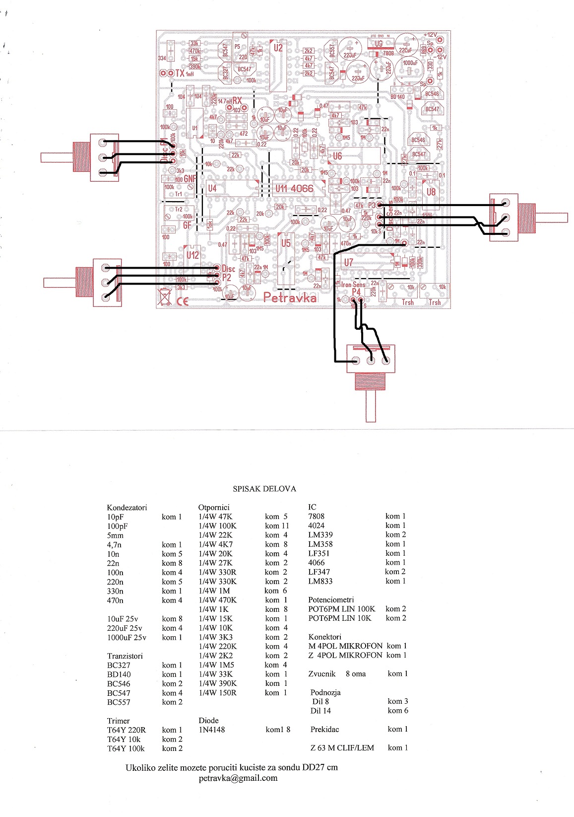

Defining the position of the pins on a potentiometer
Tut mir leid/Sorry, I think I understand your question to me much better now.....the diagram helps a lot to explain your question...Originally posted by bernte_one View Post
Its easy understanding which one is the wiper just by looking at the schematic, on all normal Pots & trimmers anyway that I have seen. The problem is identifying the "end" position as this can give a reversed action when wrong and make it REALLY difficult to understand a setup from someone who did it the other way round.....
Simon Baker tried to make it easier to understand by marking on post 622 I believe, the CCW - Counter Clock Wise (links herum) position. But as that was TGSL, it was not 100% useful for me with IGSL.....
The position marked CCW, is the side where the wiper has the minimum resistance to a pin (one or 3 connecting to 2, which is the wiper). A multimeter should define this easily....
Petravka has posted a good diagram here, the best I have seen, for IGSL. It should be fine for both Musk & DIY Coils. I have added a little info that I believe is correct, perhaps Petravka can make sure for me, that should help you further.
I am sorry that I was unhelpful before.......talk to you again soon Compadre.....
AndyAttached Files
this are the problems i had toOriginally posted by ivconic View PostIt is easy to wire up pots.
I input letter "S" on pcb draw, meaning "(S)rednji" = "middle" or wiper.
I forgot to translate it on English later...
Yes, Petravka's draw is explanatory enough.
this is why i asked but the diagram from petravka makes it sure
thank you very much

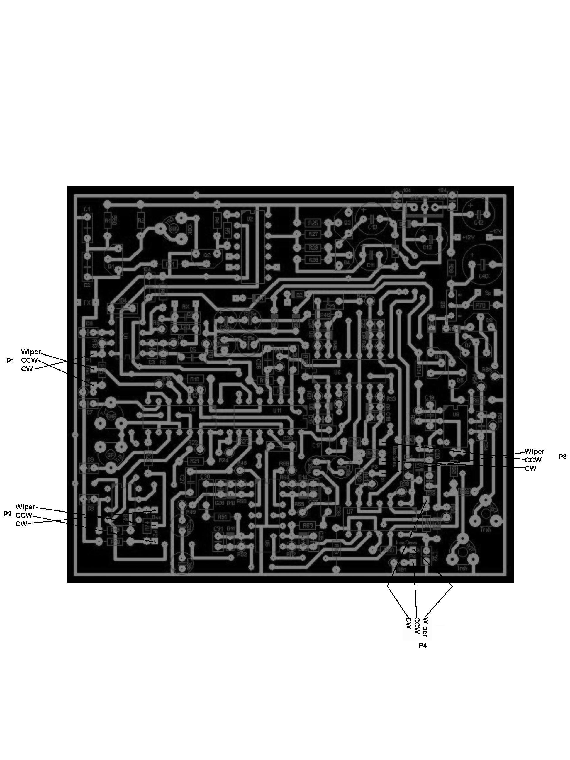

IGSL Potentiometer Connections/Direction
As far as I can tell, this is an accurate representation of either SilverDog IGSL versions, of the Potentiometer connections. The reason is that the SilverDog PCB versions are slightly different to that previously posted by someone else.
CCW = Pot connection at 0 Ohms when fully anticlockwise. Links herum.
CW = Pot connection at 0 Ohms when fully clockwise. Rechts herum.
Wiper = Middle wiper connection.
AndyAttached Files
