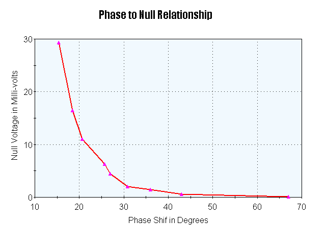

              Here are the results of some experimenting on phase vs coil null voltages last year. I only did this on one coil so I should probably repeat it sometime to see if the results agree.
              You can see that as the null voltage drops towards zero the phase shift increases.
              These reading were taken with the coils pushed further together from the zero null point.
              Next time I do this I am going to show a complete curve for both inside and outside of the null point.
              Jerry

                Hi Jerry ,
                Great graph , wouldn't it be also very nice and interesting to display in this graph the source voltages of the Fet's ( TGSL : U C15 & U C12 ) in relation to the Shift and 'Nulling voltage ' ?
                What did you use for shielding and what kind of cable did you use ? Just to get picture complete ...
                kind regards ,
                Dennis the Mennis

                  Good point. I did not think of that. Will give that a try the next time. This coil had aluminum foil for shielding and a USB cable. I got excellent results with it but will use mylar on the next one. The foil I used was pretty thick.
                  When I posted this last year, I was hoping to get others to make the same test to see if these relationships hold for different coil sizes and shapes. When I do it again I will post more complete information.
                  You have given me some good ideas.
                  Thanks.
                  Jerry

                    Interesting graph Jerry, thanks. This is one that been puzzling me. Does nulling your coils to the minimum voltage represent the optimum coil location for good depth, and discrimination? or do you then move the coils again slightly to another location for best operation. I'm hearing different opinions from others on this board. Some say null for best ferrite rejection! PS, Ive been using a usb cable which was what I thought had pretty good results. Now Ivconic and others are recommending Belden cable. Does anyone know what application Belden cable is usually used for? Sometimes knowing this make it easier to obtain at cheaper prices. Like audio cables, mike cables etc.

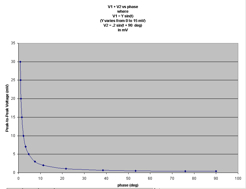

                              That is food for thought. It makes me question my theory that the null signal is a pure magnetically coupled signal added to a non-magnetically coupled signal which is 90 deg out of phase with the TX signal.
                              For comparison, below is a graph of voltage vs phase when you sum a signal with another one that is 90 degrees offset.
                              I chose .4 mV PP for the size of the small signal that is 90 deg shifted. The signal at zero deg phase I varied in PP magnitude from 0 to 30 mV. I thought this might be typical of the coil Jerry was playing with.
                              My theory has been that the RX null signal consists of a variable (depending on position of coils) signal that is 0 or 180 degrees relative to the TX signal, added to a small "non-magnetically" coupled signal that is constant but approx 90 degrees relative to the TX signal.
                              Notice how my graph is "steeper" than Jerry's measured data. This suggests the null phase may be more complex than the sum of a variable signal plus a constant signal. Or could some scaling factor explain it?
                              I will keep thinking about possible models that might produce a more shallow curve like Jerry's data.
                              -SB
