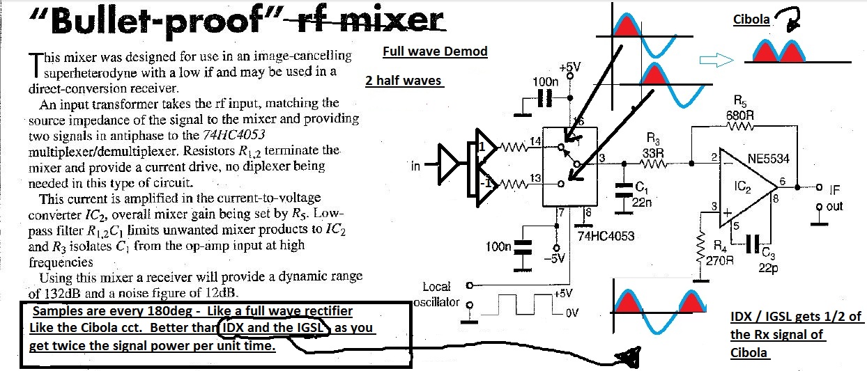

Talking of a better sych det to give better depth - like a modern mid price machine. Pls read attached.. SAttached Files
There are better reasons for full wave sampling than twice the samples, like 2nd harmonic suppression, common mode suppression, and offset suppression. Please note that PWM induced fluctuations resulting from 2nd harmonic content are largely ignored in most of the designs, including my beloved IGSL.
If the PWM does not shift the phase of the signal, does it really matter?Originally posted by Davor View PostThere are better reasons for full wave sampling than twice the samples, like 2nd harmonic suppression, common mode suppression, and offset suppression. Please note that PWM induced fluctuations resulting from 2nd harmonic content are largely ignored in most of the designs, including my beloved IGSL.

Oh yes, it does. There is always some residual unbalanced signal from the coil on top of which you'll find the targets' response. Any floating there will be passed forward as an amplitude change in case of half wave, but not with full wave. By floating I mean EF, 50Hz, internal voltage change ... you name it. Most of these are cancelled out by the full wave switching, and THAT is the main benefit.
I guess there are the three mixer styles
in approx order of performance...
Full Quad demod - proper good machines. Tier one GMP etc £800 - £1500
Balanced type with alternate 1/2 cycle sampling - eg Cibola. £350 - £800
The single ended type like a single cmos switch used in IGSL/TGSL/IDX £200 - £350
S
So some machines only see half the RX signal' In a ideal situation by seeing all the RX signal theres lots more to be gained but not 50% worth, nearer 10% if your lucky but by getting that your putting another 100% worth of guts into the machine together with the full quad demodulator which gives you these prices of £1500.
Its all horse for courses, lots put in little gained, but of course that extra 10% can be wether you get the hit or not so worth it to some.

I don't see how full wave detecting fixes that, because it just acts as a full-wave rectifier instead of a half-wave rectifier. Amplitude modulation of the TX signal will still come through whether it is full or half wave detected.Originally posted by Davor View PostOh yes, it does. There is always some residual unbalanced signal from the coil on top of which you'll find the targets' response. Any floating there will be passed forward as an amplitude change in case of half wave, but not with full wave. By floating I mean EF, 50Hz, internal voltage change ... you name it. Most of these are cancelled out by the full wave switching, and THAT is the main benefit.
Even harmonics are always canceled and don't contribute to the SD output. Odd harmonics contribute to the signal, regardless of half-wave or full-wave detection.
So I don't get the idea yet, maybe a detailed example would help.

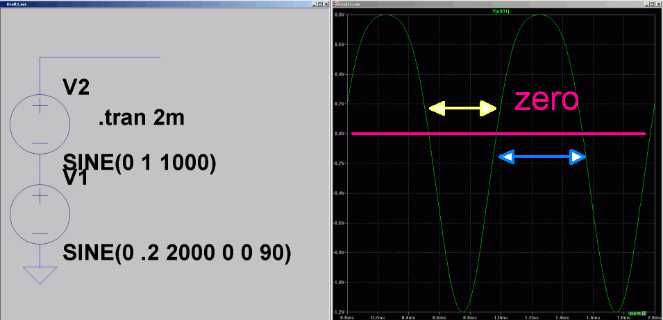

2nd harmonic is a source of PWM here. You'll see it in a picture below. Problem rises with offset, and there are many sources of offset, including various modulations. The way full wave switcher fixes things is by successive reversing the offset contribution, and thus suppressing it. In fact full wave switchers also suppress the carrier as well - they are balanced mixers.
All of that, of course, in case switchers are supplied with symmetrical timing. Full wave will suppress most of the artifacts even with not-so-perfect timing, but the half wave switchers will not.
Our rigs are usually made with single ended oscillators (which are fine sources of 2nd harmonic), and phase shifted AC component is compared with ground to obtain the switchers timing. Now, consider waving a coil against the rough surface and think of it as a variable loading - guess how it reflects on offset in PWM terms with changing levels of 2nd harmonic in amplitude and phase (due to the phase shifting).
We may argue that these effects are of second order, but there is a large unbalanced signal that is supposed to stop at motion compensation filter, and it's modulation will pass through. Microvolts of target signal on one side against milivolts of unbalanced Tx on other.Attached Files

Just imagine how changing ground proximity would influence Tx coil Q and the 2nd harmonic content, and next just look at the picture above and see how 0V is not placed at a value that stands for equal off and on times.

Any second harmonic (I assume that means twice the frequency) of the TX frequency should act the same as the fundamental, only smaller, in a half-wave synchronous detector, should it not? In other words, if the TX signal is integrated to zero by the SD, then the second harmonic would integrate to zero. If the TX fundamental integrates to some voltage (due to phase), then the second harmonic would also integrate to fraction of that value -- it would behave like a small percentage addition to the fundamental.
So while I see the point of your picture, you haven't shown how that causes a problem when you follow it through from TX to target to RX to SD. I'm not saying it doesn't cause a problem, I'd just like to see more clearly how.

These effects are related to your sweeping speed in the same manner targets do, and while the soil response is phase shifted and reduced by properly adjusting GB, the unbalanced Tx signal modulation passes through. Point is that even due to some voltage fluctuation in the rig, this will be happily passed through to the audio, and the same thing happens with the ground proximity changing the coil Q. As a direct consequence you have varying 2nd harmonic fluctuation that directly causes offset shift PWM style, and it all passes through the motion filter as well. As a consequence you have a rig that behaves as if you can't find a proper GB anywhere. It is not severe, but I noticed it. It can be partly cured by finding the Tx oscillator bias Goldilocks point. Thanks Ivconic for a Tx trimmer - some VLFs don't have any.
In conclusion, this is not a problem for a deaf rig. Going any deeper and it catches up on you. First thing to do is going full wave, and second is running a Tx with suppressed 2nd harmonic, e.g. a symmetric one.

1) It's not 2nd harmonics that are bad, it is modulation of the 2nd harmonic at about 10 Hz that might be a problem.
2) anything that modulates 2nd harmonics in the TX oscillator does so by modulating the amplitude of the oscillator, causing the distortion profile to change -- and anything that amplitude-modulates the oscillator signal is going to ding the audio, with or without 2nd harmonics and whether it's half-wave or not.
3) The RX circuit removes DC component from the signal and a lot of low frequencies -- so a waveform that has a large 2nd harmonic will quickly establish a new "zero" level where there is equal area on either side of the zero level -- so the SD should integrate about the same signal strength on either half-cycle (if my math is not crazy).
4) The biggest danger I see would be a low-frequency (10 Hz) "additive" differential signal coming from the RX coil. This would shift the 14.5 kHz signal up and down, and cause modulation of a half-wave SD output, and is a good case where a full-wave SD would greatly reduce the problem. Note that this would happen even without any 2nd harmonics at all.
