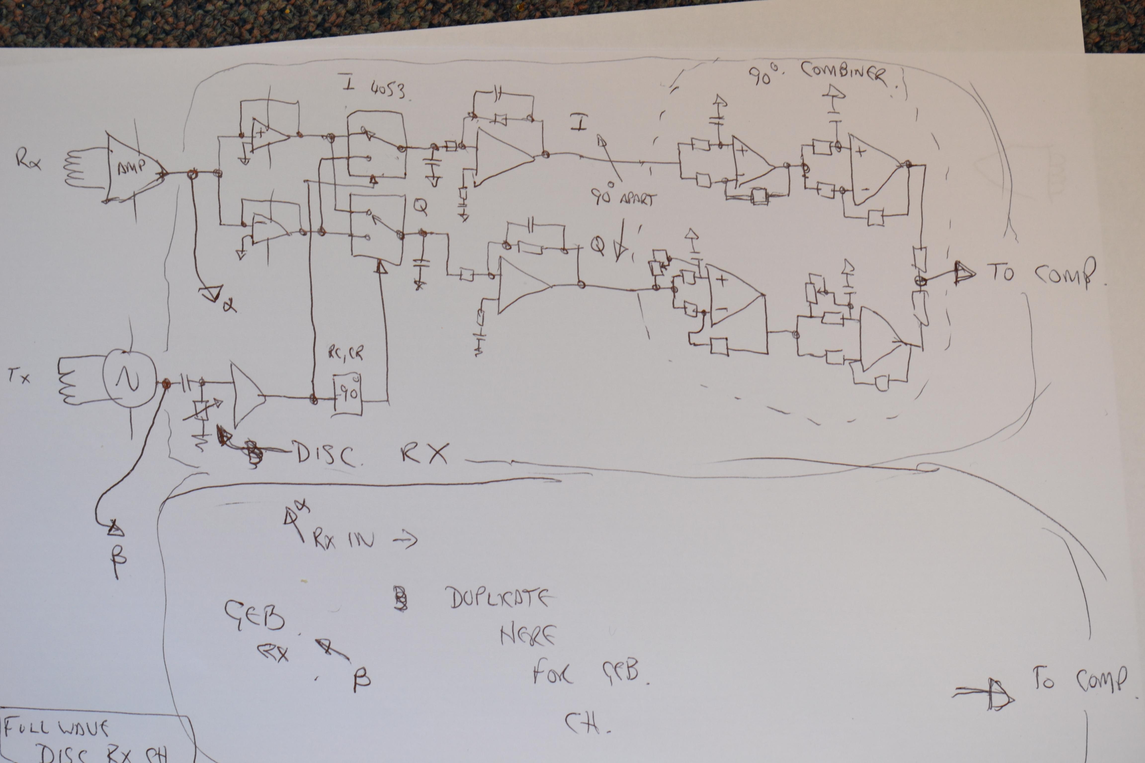

    • [QUOTE= I'm very sure my future project will have this dual discrimination, but I'm greedy and I wish it to be a 4-quadrant solution as well. We'll see. QUOTE]
      I know good commercial machines have full wave/fourquadrand/balanced mixer/tayloe detectors. IGSL, IDX effectively have a single diode detector like an old AM radio (good its day)
      If you wanted an IDX type unit with a single disc and Geb on way of doing it is like my sketch...
      I too want to one day make something with that elusive 10" depth on a mid size coin,,
      S
        ...way of doing it is like my sketch...
        There is a bit more to it than just combining. Phase detection requires multiplication, not addition, but good thinking though. From olden Fishers onwards, including IDX, such addition is used for phase rotation. IMHO the TGSL/IGSL phase extraction technique is more robust with large signals, and that's precisely where I want to be. As it is now, my mods of IGSL extend the unspoiled discrimination for at least one decade north and south, and I'm sure Fisher-style phase rotation would be a limiting factor.
        Extracting phases directly from Tx is very meaningful if you don't want to pursuit futile equality of the channels gain and frequency response.
          There is a bit more to it than just combining. Phase detection requires multiplication, not addition, but good thinking though. .
          I think you missed a bit Davor...
          The schematic is Only for a single Dic Ch. Recombining the quadrature signals gives you the amplitude increase while maitaining the phase information of the Rx signal coming through.
          You Duplicate this schematic for the GEB channel.
          Effectively making an IDX but GEB and Disc are Full wave domods you see. Like a good detector should!
          S.
          • Exactly! The only missing detail is either a rectifier if you are into all metal, or a multiplication circuit that will narrow the response to a single quadrant.
            You may achieve the rotation of phase response either by addition as per your sketch, or directly rotating the phases of the switchers' drivers. I prefer the latter because it is way more robust with strong signals.
              Im a bit lost here how do you mean - with this statement..
              I dont have a neat solution for these full wave puppies.
              My aim is to get a sensitive solid quality Rx. That is what I have in sketch -
              1)full wave quad demod - for a single Disc channel.
              2)full wave quad demod - for a single Geb channel.
              This would make an IDX in effect - but with sens and depth approaching a commercial mid range unit - rather than an 80s low end unit.
              Thats my input , as ever its only opinion and I am wrong regularly.

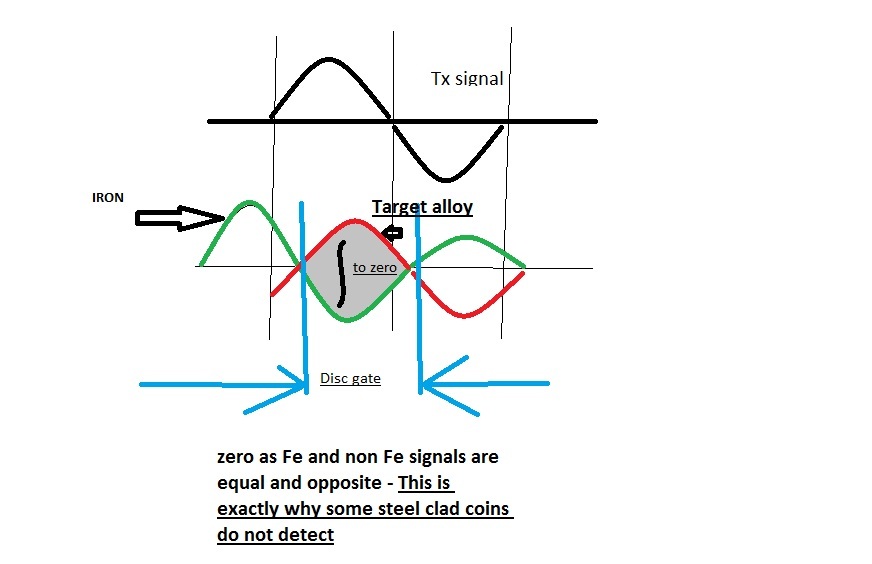

                  • When we do the next kit - can we get the DISC and GEB POTS on the edge of the pcb - like in pic please.
                    Can we keep the Rx pre amp and the Transmitter circuits more than 2mm apart - with a sloid copper gnd rail between them, local decoupling. etc
                    Disregard the image on LHS It is error - and I cant remove them once on..
