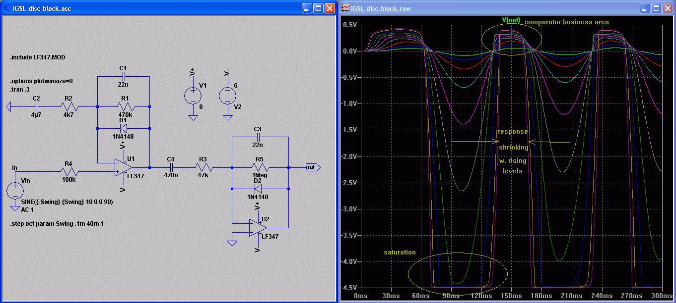

                        • Now about the gain stages. There are two opamps, first in non-inverting, and the second one in inverting configuration. Together they are inverting an input signal.
                          Business area of a comparator that follows are positive signals, so the expected input would be negative, and (without further elaborating IB theory) it is band pass filtered to ~10Hz peak. Bandpass means also motion compensation.
                          Input signals can vary in a wild span of several decades, and someone mentioned 6th power law response viz the target distance. Anyway, it is a lot to squeeze into a nice "beep".

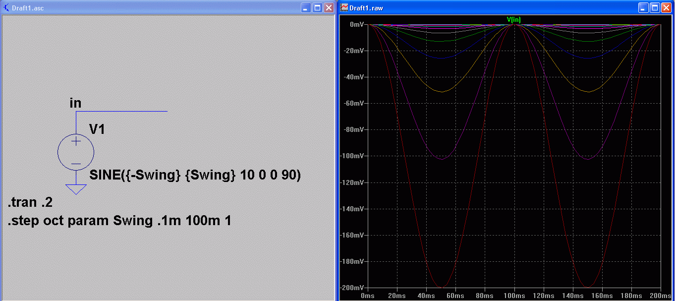

                          To go along with the requirements of the task, I prepared a signal source that mimics a coil swinging response (10Hz) right after the bilateral switches (featuring phase detectors) in case of the expected beep, and stepped values are in octave relationship: 0.2mV, 0.4mV ... 200mV. Altogether 3 decades.
                          • Next is the existing solution and clues to what's wrong with it. First please note that the response of a target is squeezed to under 0.6V (diode, eh) and the comparators really work with that much, and the sensitivity control is really designed to work with this much. It is the same with TGSL.
                            Furthermore, the non-response part is saturating, and also widening in a process, which leaves active part ever shrinking with rising levels.
                            Picture speaks for itself...

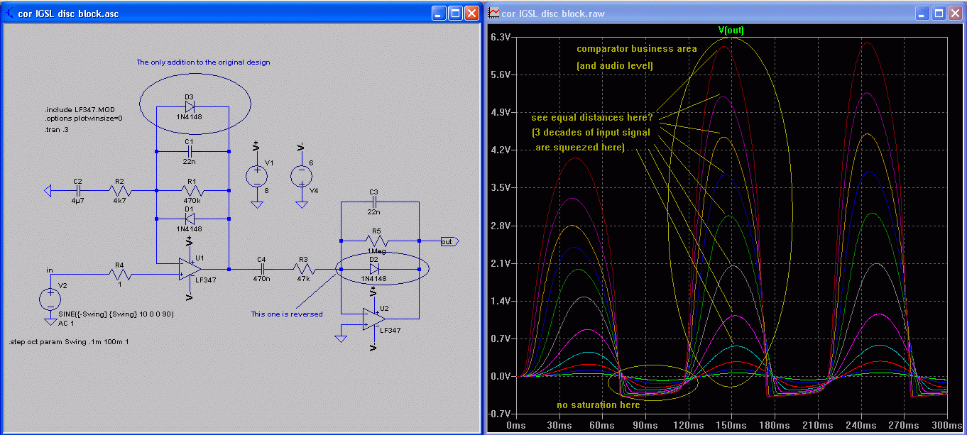

                            • Now comes the solution that does not change much in the existing design. Actually it will require some changes further on, but lets play with this for the time being.
                              First of, the D2 polarity is wrong. When reversed the output swing is allowed to go beyond the diode barrier voltage on positive side, while the previously offending saturation is kept well under 0.6V. That's a start.
                              Next I wish to enable as much gain as possible, while maintaining a log relationship at the output. To do that I reverse a diode in a first stage. To avoid floating with rising signal (this is a motion compensation design) I need to introduce an additional diode in counter-polarity to the existing one. I checked it with various offsets and it always works good. Now the response signal shape looks good, and the output swing is ~6V, with no saturation, no shifting left or right, no shrinking of active response, and the best of all - it is logarithmically compressed. See how octave increase maps into linear output?
                              I'd say that whoever designed this stage had an inspiration, but somewhere in a process he/she made a small mistake.
                              And a completely unimportant one: 100k in series with the first stage is doing nothing but increasing noise. At least with LF347. Just get rid of it.
                              Please feel free to play with these designs. I'd say they are pretty elaborate, but for some unexplainable quirk in a process of implementation they just got wrong.
