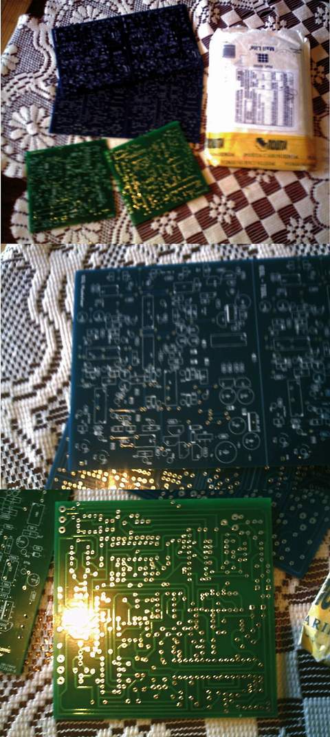

                        • Just received pcb's form Silverdog...WOW!
                          Top quality!
                          It is joy to make detector on such pcb!
                          Splendid job again Silverdog!

                            • Looking at these, for real top notch pcb's... i am starting to think that maybe is not bad idea to transfer IGSL to SMT... later, maybe in Winter...
                              Because, i refused to think on SMT so far, simply because i hadn't conditions to get such hi pro pcb's!
                              But now.. different story..!
                              So.. till winter i will do my best to upgrade ISG project a bit more.
                              I don't have any finished idea by now (don't suspect in that der fisherman! ).. but will do my best to have something till winter...
                              So than we will talk about SMT...
                              I am so so skilled with SL5 when conventional, through hole pcb's are subject, but i am not skilled at all with SMT.
                              So if someone of you have good will to transfer it in SMT - be my guest!
                              Or, better wait winter to get updated IGSL than.
                              Silverdog with his splendid work will change my attitude and point of view toward hobby electronics!

                                I haven't done any SMT (do you mean SMD? Surface mounted Devices!), but I do have Eagle 5.4 which can do SMD.
                                Also KICAD which is completely free can do it to I am very sure.
                                The secret is that both have extensive libraries of components, its unlikely that you must design a new component, but still possible if you do.
                                I am putting this a bit simply, but all you need is a finished schematic and apply SMD devices to it instead of conventional ones and then tell Eagle to make a PCB......(it is more complicated than that, but I hope you get the idea!).
                                I would be willing to help as well....though I must learn SMD as well.....
