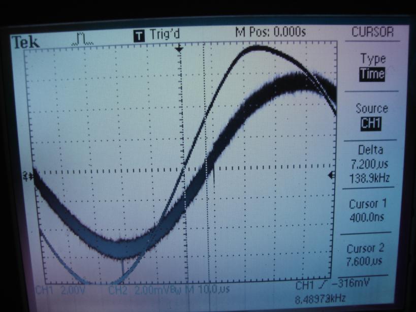

            I made IGSL musketeer coil. Everyone on this talked about deep coil nulling, so I deeply nulled my coil. I nulled my coil ( on the output of preamplifier ) to 14 mV. After this nulling was sensitivity to 1 EUR about 30 cm. I was satisfied.

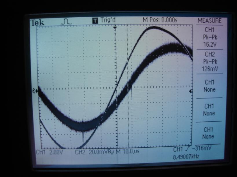

            Next day I switched on my IGSL. Epoxy in the coil dried and coil disballanced to 126 mV. Damn. But...I tried sensitivity and sensitivity is 40 cm to 1 EUR !!! Really. Discrimination and GB is perfect. I thought, that deep nulling is the main goal ( the holly grail ) of nulling. Can someone explain me, why is disballanced coil more sensitive than deeply ballanced coil ?

              Maybe your preamp involves some hums on existing signal!? Dc offset?
              If you followed TGSL thread you may noticed my constant insisting on monitoring residual voltage at the coil pins and not after the preamplifier.
              You can now observe residual voltage at very coil pins and see the difference, the "real" residual voltage.
              Besides; good nulled coil doesn't mean lowest residual voltage on coil. Not the rule.
              At such setups as IGSL is (Tesoro's) usually TX operates at one frequency and RX at slightly different (once i founded rough "rule" as 1.9-2.2kHz difference) , so is obvious that sightly "unbalanced" coil will perform better than "stiff" nulled one.
              So if coil is nulled with lowest possible residual voltage at TX=8kHz; be sure it will not perform good at significantly different frequency than.
              Yet, IGSL (TGSL too) setup allows slight residual voltage offset at coil balance and most probably, by funny coincidence, your coil balance entered in to most desired balance range, when dried!
              With frequency change - residual voltage will change too. If your coil with present 126 mV performs nice than i can only suspect dc offset at your preamp.

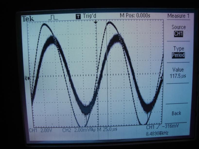

                The answer is simple [or maybe not that simple] - deep nulling is not the Holy Grail. It is much more important to have the correct phase-offset between the TX and RX signal.
                From your scope shot, the phase-offset appears to approximately 7.5us, and the TX frequency is 8.4kHz. Therefore, 7.5u/(1/8.4k)*360 = 22.7 degrees. which just happens to be [more or less] the correct offset for this design.
                  Yes, 20 degrees was the golden rule at TGSL.

                          Where to measure phase offset ? Directly on the Rx coil pins or at the output of preamplifier ( C3 100pF feedback capacity increases phase offset )? I measure everything at the output of preamplifier ( residual voltage nulling, phase, noise ). I measure residual nulling voltage by osciloscope ( voltage is measured Peak to Peak - Dc offset is not counted ) . Is it correct method ?
                          • IMHO yes, because a coil is put into it's working conditions within a tank, and oscilloscope probe is hooked to a low impedance preamp output. Otherwise there is little difference between a preamp input and a oscilloscope, and the difference comes as additional shift by feedback and coupling capacitors of a preamp.
