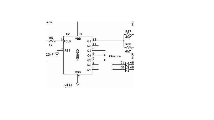

                • CD4024 outputs decide "Tones" not any trimmers.......

                  You obviously have not built a IGSL.....or if you have, you haven't understood an important part.....
                  To sum up, you have several choices for the tones for each channel, this has NOTHING to do with the trimmers, it hangs on which outputs from the CD4024 you connected the two channels to.......the trimmers do not change the frequency of the fixed tones, only the "when".....
                  D1 & D2 can be connected to CD4024 output at pins 9, 6 and 5.......its marked "choice" for that reason.......which is a high tone and which is low for Iron and non iron is a personal choice only.....we have not had any actual direction from the experts......
                  If you look at the schematic and read my previous post, it should make more sense.....
                  I will attach a diagram of the area in question for you.....I hope this clears up your misunderstanding of my post for you in a proper manner.
                  I don't understand well the way the Op Amps work here well either, as timing is the name of the game......people like Ivconic and Simon amongst many others, have a working "picture" of the whole machine in their heads, I am not yet that far along......but slowly getting there (I hope!).
                  Andy

                  • Oh, I see.
                    A misunderstanding.
                    I didnt know what to do with the wires on the diode choices either.
                    Silverdog gave me his settings so that the Iron is a low note and non ferrous gives the high note.
                    I cant remember what they are without opening my machine.
                    You have 2 wires to wire to the cmos chip, but there are three pins on the chip..
                    Clearly only two wires - so make only 2 connections. If your detector sort of works, then put your 2 wires to 2 pins and sweep a ferrous target - then sweep a ball of aluminium foil
                    You choose whether non foerrous is going to give the high or the low - depending on which choice you make.
                    Steve
