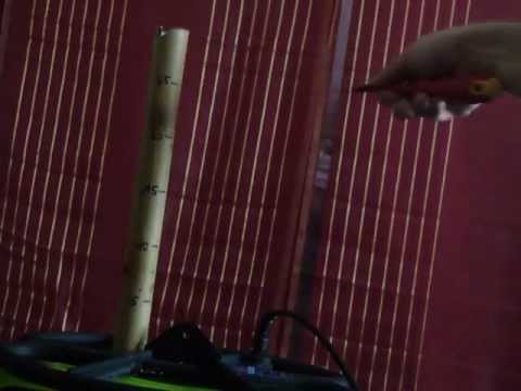

          • Here is a Video of my IGSL. I have built it with the mod´s of Davor (the Redox-Version). The Power-Section is built like original from ivconic, and the Bi-Pol Cap´s are 10 uF and not 4.7 uF. I use the 4-Pin-Coil for Tesoro 14-18 kHz forTEJON + VAQUERO + CIBOLA + LOBO DETECH ULTIMATE DD 33 cm / 13".
            I made this video in a very noisy room (TV, Laptop with W-LAN and a lot of iron in the floor).
            • I love this sound
              When you have a rig as "nervous" as this one, and it is still not offensive to your ears, you get a very nice feedback from your surroundings. Don't be too surprised when you walk your rig in the woods for the first time - the scratching tone will be gone.
              This rig shows perfect proportional tone which is a consequence of the improved compressors in the gain blocks. And also enhanced by slower motion response. Perfect!
              My rig will also get 10uF caps soon
              • Thanks Davor.
                @all
                in the Video later i have turn the Ground-Pot full CCW and full CW. At Start this Pot is in middle Position.
                • In the air tests you will not notice much difference, but real soil is a bit different. Initially you should null the GEB by waving a piece of soft ferrite. Most probably you'll have some residual, but much weaker. Mark this position for further reference. When on a real terrain, find a spot without targets at ferrite GEB, and start bobbing your coil - waving it up and down close to the ground, and find a GEB minimum again. And you are ready to go.
                  • There is a difference. All testobject´s get a iron-tone. You hear it at 2:25 in the video.
                    • A friend of mine said :If you have such good masters detectors show me where you found the coin of 30 cm depth!
