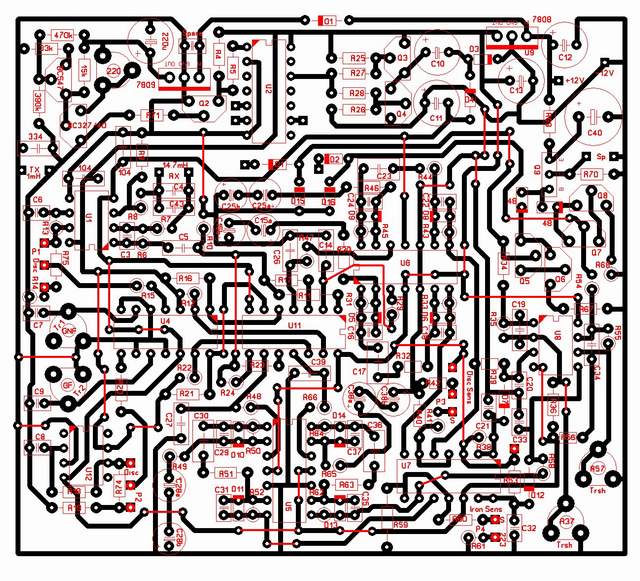

Ivconic, good to see you back. You have another monster growing, eh?

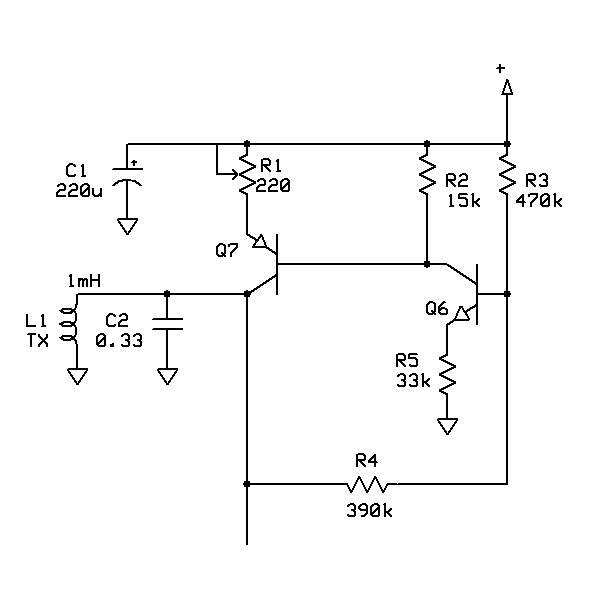

I have some questions, please:
1) What program did you use to draw the schematic IGSL.sch contained in IGSL.zip?
2) With the Minelab coil, I read that you changed the tuning capacitor to 330nF.
Wouldn't you also change C1 to 3.3uF as C2 becomes 330nF? Otherwise, with a 1mH coil I can't see how you would get anywhere near 9kHz output.
Thank you for another excellent project!
