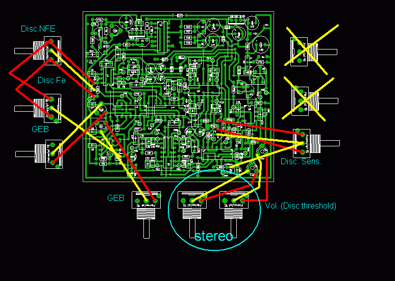

  • Something like this, LF351 not needed, Disc.Sens. joined together.
    It is possible to join GEB controls too.
    Make sure you understand and apply pin swap mod!

        P.S.
        Using stereo pots for Sens and Tresh is generally bad idea (ruins whole IGSL concept) and that's where i don't agree with Davor.
        Having comfort to separatelly adjust both Senses and Tresholds is sweet thing.
        If you are searching for precious metals (aren't we all) than it makes difference when you separatelly adjust Fe Sens and Fe Treshold bit lower than Nfe Sense and Nfe treshold.
        And vice versa; in case you are interested mostly in Iron targets...

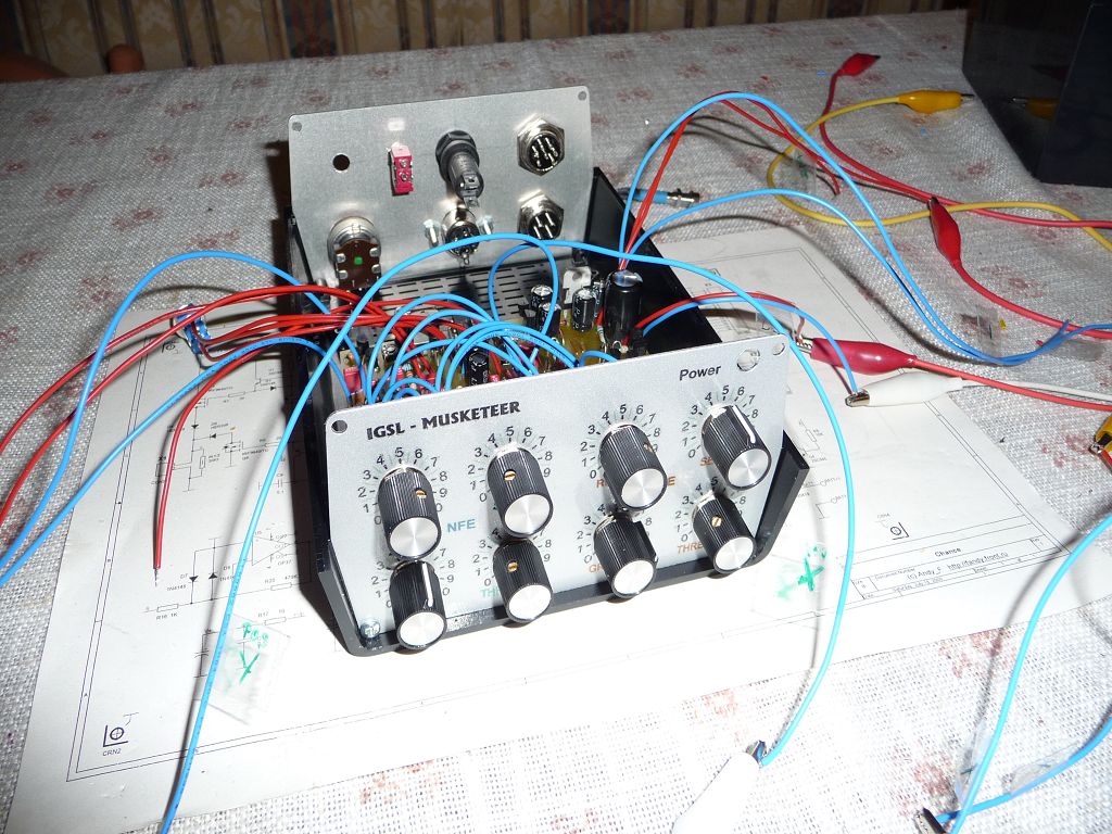

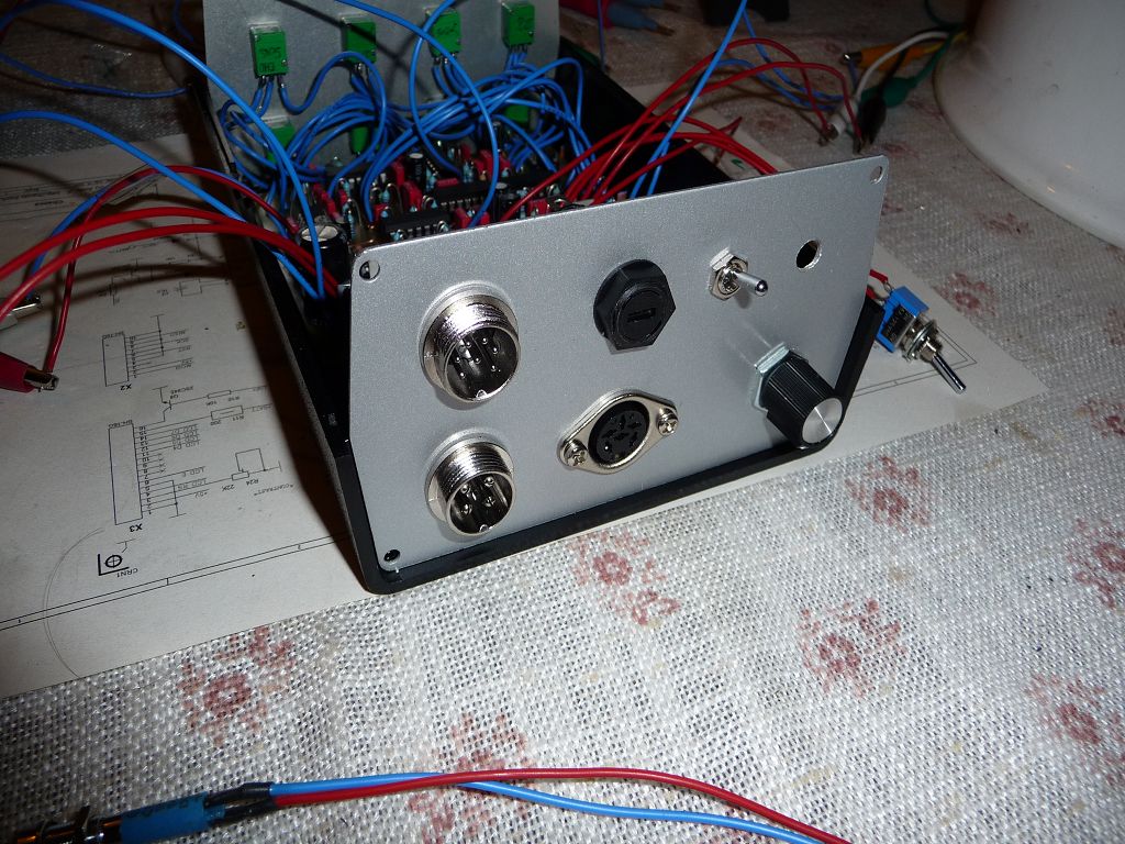

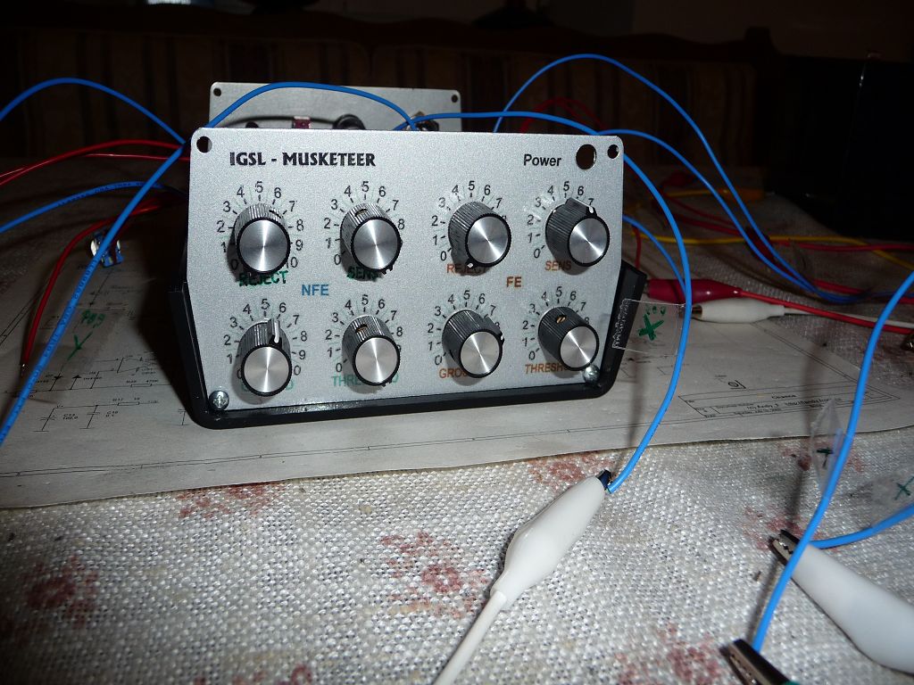

        • Hi Ivconic,
          in the attachment you can see my potis. I have all Potis ouside on the Frontpanel. Turn on Iron Threshold haven´t any results in depth.
          What can be wrong in the Fe amplification channel ? I think the IGSL can detect iron in a high range, but the "sound channel" is bad. When i wire my lugatek VDI on IGSL then it shows me a tweezer in about 10 inches with a -40 VDI value, but the "sound" from IGSL is scratchy. So the problem must be the Sound amplifier circuit.

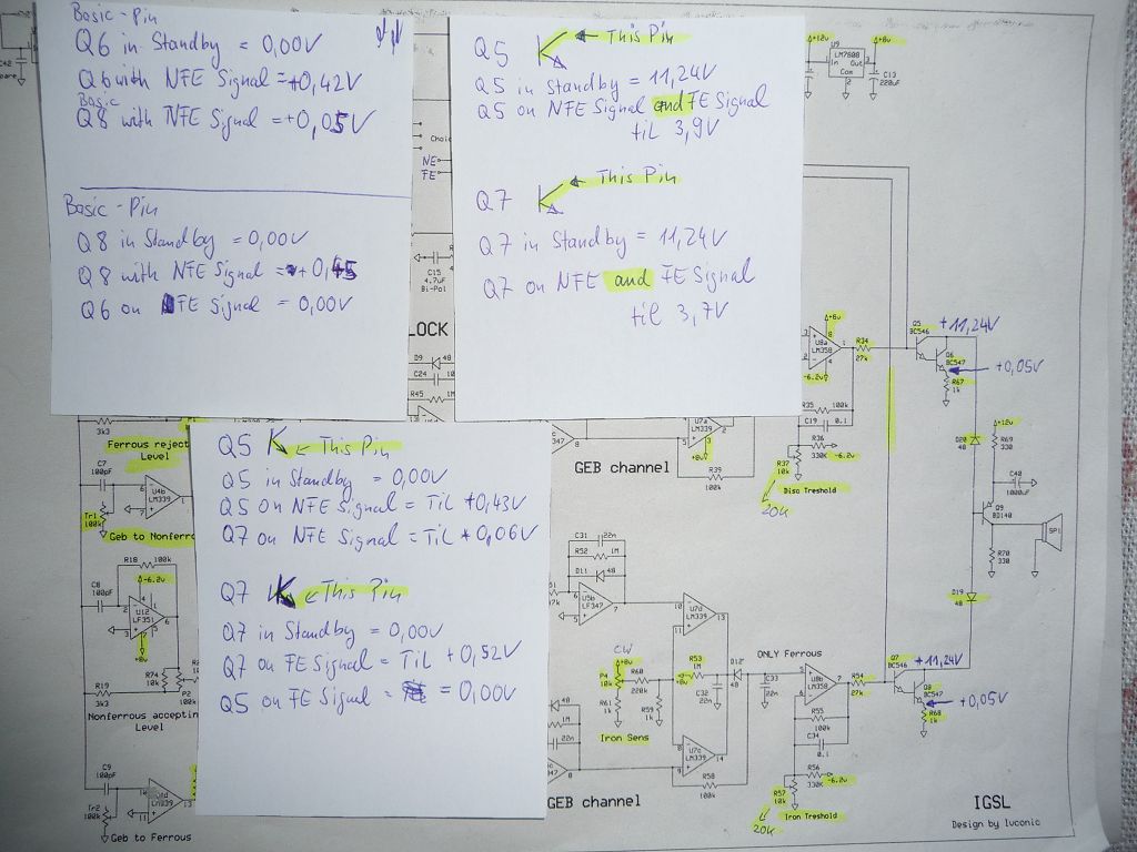

                      yes, FE Disc is working, I can accept and reject ALu Foil and FE Sens is working too. Only the scratchy pprrrrrr, prrrr sound is the problem.

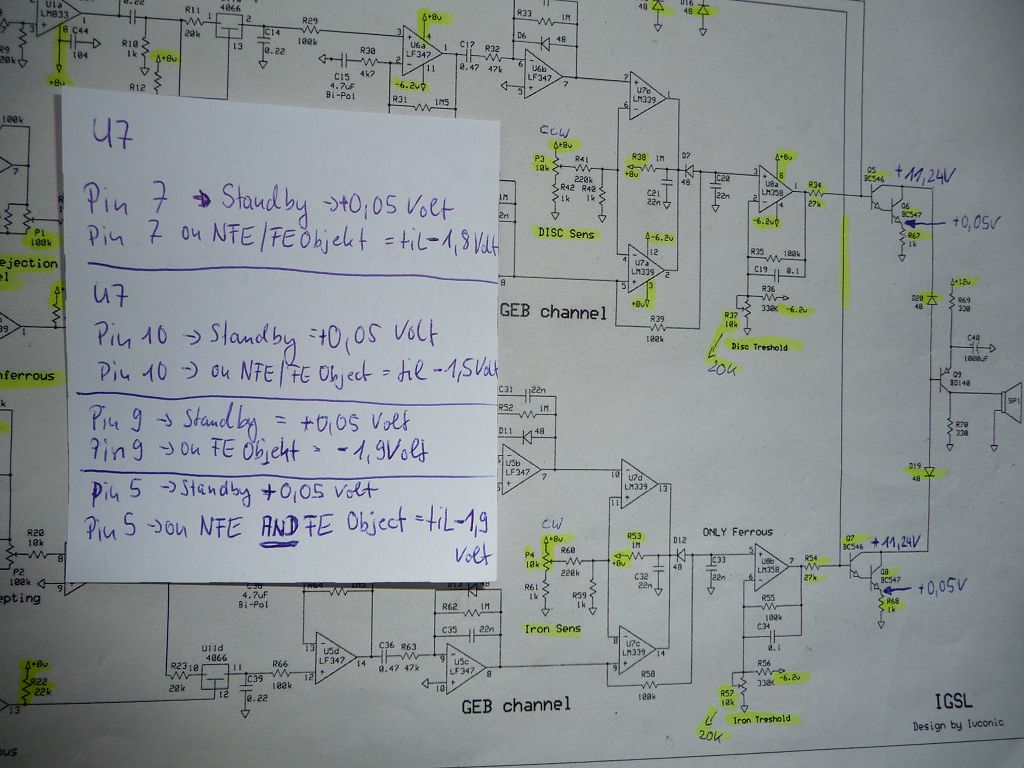

                      I have measure some voltages on the Q5, Q6, Q7 and Q8. See my picture in attachment. The voltages are sometime with a NFE / FE Object over the coil.

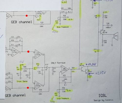

                      • The discrimination channels are best checked at the outputs of the gain blocks, as indicated with the red dots on a snippet of your photo. GEB channels are supposed to work THE SAME on both channels, while disc channels (NFE not shown in snippet) are supposed to work ... well, that would depend on whether you made a pin swap or not. In case you left it in original layout Disc channels would also work in the same manner, only a bit different amplitude.
                        • Here are the voltages of the GEB Channel. On Pin 5 from U7 i have up to -1,9 Volt on NFE AND FE, is this right?
                          • Yes, this is OK. You obviously did not mod your gain blocks, and your voltmeter shows the average DC voltage (with 50mV offset). These -1.9V are a consequence of gain block diodes that compress asymmetrically. That's one of the reasons I did all those mods in my rig. Having -1.5V at pin 10 and -1.9V at pin 9 means that your Fe gain block works fine, and that you'll have to find your problem somewhere else.

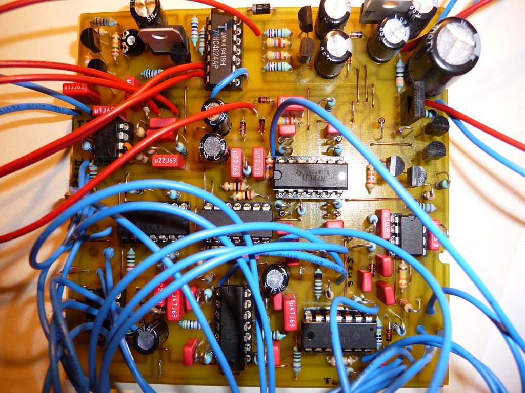

                            I must admit that I only now looked to your video with my headphones on, and I obviously missed some important details before. Also about your iron target, you picked a bad one - it is either stainless or chrome plated. Pick some plain naked iron instead for testing purposes. A big nail should be fine.

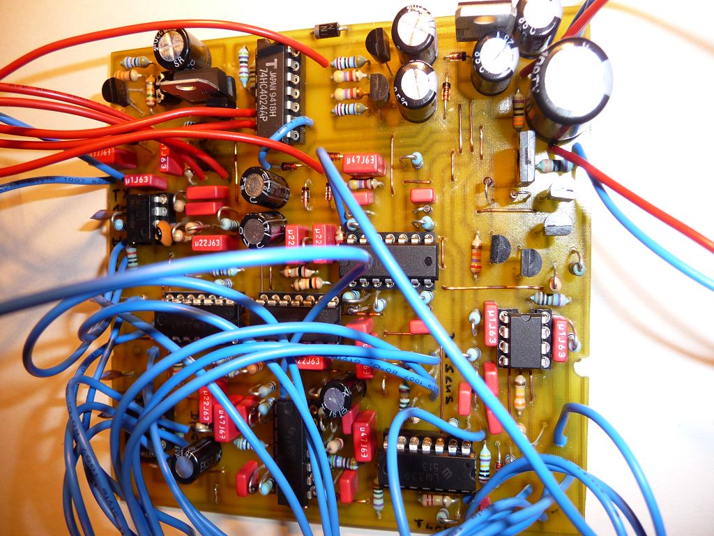

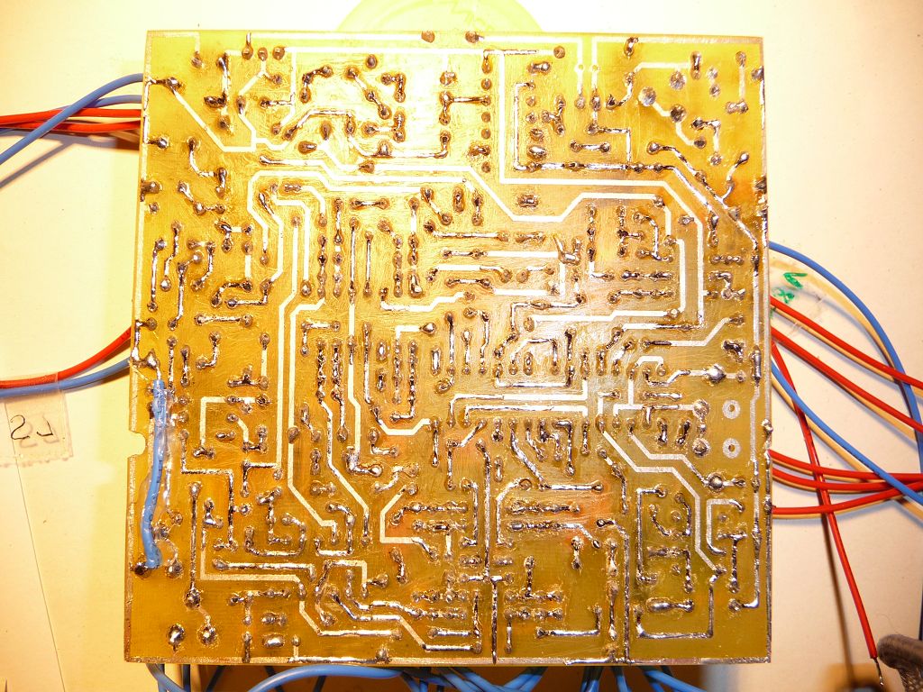

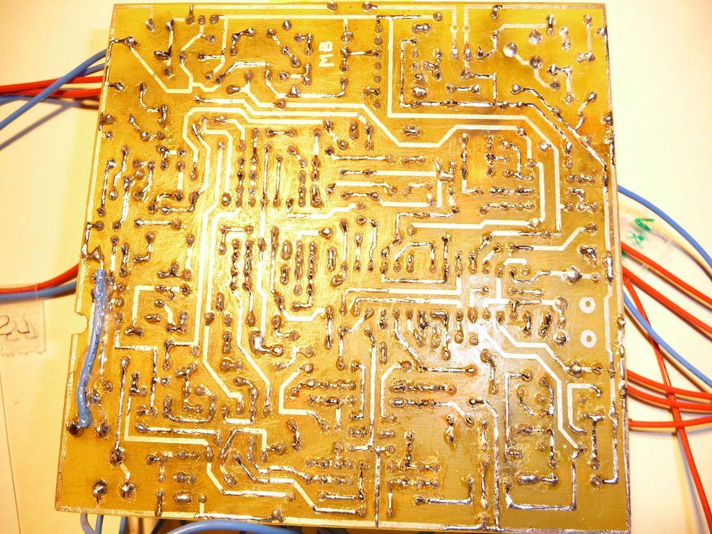

                            Could you make some close-up photos of your PCB on both sides?
                            • Here the pictures from the top and buttom side. By the way, a rusty nail is poorer in depht than a tweezers on IGSL
                              • I'd say you didn't apply a pin swap mod. It would greatly improve Fe channel behaviour.
