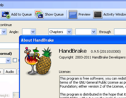

    No worries, if you need support H.263 video (xvid/divx) with mp3 audio, you'll need to download 0.93, after which they dropped support for those formats. H.264 with AAC audio has essentially made the older formats obsolete, so unless you need to use the older formats for particular hardware it's better to use the newer ones.
    If you need h.264 playback support, VLC Media Player will handle pretty much any modern audio or video format if you don't already use it. (It can transcode also, but handbrake is generally more straight forward to use.)
    • By inertion i downloaded 0.9.5 version. It is working fine. To much options! Those i can understand - i adjusted, others i left unchanged. First compression (with such adjusted options) gave me noticable better compressed file than Dr.DivX !!! Audio is better. Now higher audio pitch at IGSL is absolute clear without distortion, but lower audio pitch is still a bit distorted. Must be that i didn't adjusted audio options very well. But video is excellent now!

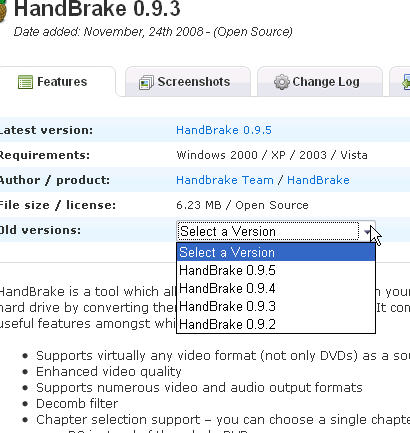

      • On this link:
        Download HandBrake 0.9.3 for Windows PC - Safe and Secure from FileHorse.
        all versions are available!
        I have all versions now!
