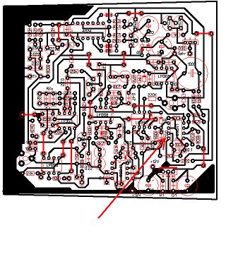

                    hi Ivonic and Selim
                    thank you very much
                    • Very Nice Looking Board Selim.
                        Selim you don't need another pcb, that one is just fine. Just omit fet part from TX stage and somehow include that trimmer. It improves overall performances - now with that trimmer you can adjust perfectly nice sinus at TX output. I also added 2 capacitors at RX input, because my RX coil is exactly 6.5mH and i found out that 14.7nF (10nF+4.7nF in parallel) gives me PERFECT resonance relation, which resulted with 2cm gain at coin in air depths.
                        Also i rise up gain at first opamps in channels (1M5 instead 470K). No harm (no false signals and no instabilities later) but also another improvement in sensitivity. And at the end i added treshold control, because now with those trimmer you can shape up a bit more audio to get nice and very pleasant output.
                        And also, finally i choose different 4024 outputs and finally that is it! Best possible audio combinations.
                        I can not explain correctly, but i noticed that some frequencies from 4024 are not most suitable to be used for audio stage. With this, latest, updates at 4024, i have feeling that everything goes on it's place, audio now is acting pretty smooth, much better than before.
                        Updates gave me better results now; same coin now at 28cm in air, Cu plate 5x5cm at 60cm and more. Better GEB and Disc behavior and stability is just PERFECT.

                        I will rearrange pcb now...

                          • Dfbowers, i noticed some benefit from it.
                            At very first setup from the first page of this topic; i had TX amplitude only 9vpp!? Maybe it is not proper reading because my oscilloscope is very old and "noisy" (Telequipment D54...almost older than me!)
                            So i tried to rise up amplitude by changing R1. I lowered it's value in few steps and got higher and higher amplitude.
                            Now R1 is 560 ohms and amplitude is 13vpp - taking that my D54 is accurate (which i seriously doubt now).
                            But TX sinus was a bit distorted with noticeable "notch" on the top. Also i couldn't get more significant air depths with such risen amplitude!? So i decided to remove FET parts (again) from the pcb and experimented with resistances there. Initially 47k was there; so i used 100k trimer and adjusted it while observing scope behavior. At some point "notch" disappeared and pretty clean sinus appeared on the scope. Depths improved and overall behavior looks kind a better then before. But now frequency is not 14kHz as it was - now is 14.6kHz.
                            Now this reminds me to say again that R1 is not 2k2 anymore - now is 560ohms.

                                Let's remind first, about how all started in the past; first it was TGS with battery check, than i rearranged it and got first TGSL version also with battery check. Next TGSL versions were without battery check. That LM358 is later tied directly to +8V. Later someone again decided to tie it to +12V. I don't see reason to tie it on +12V - because we don't use old Tesoro way for battery checking. Battery check can be done in much better ways.
                                So that LM358 can be tied to +8V freely, you can do that without worries. Is this affecting treshold swing? I can't tell surely , but personally i doubt. Never checked. So you can tie it to +8V and see. In case you can't achieve treshold - than must be for some other reason, surely not because of +8v voltage that supply LM358.
